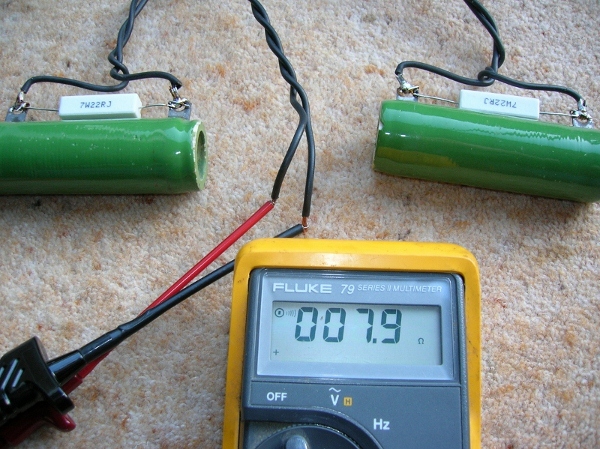

Aye, the normally accepted test-signal is 1kHz sine-wave....
The 10 ohm resistor is OK, but an 8 ohm would be better, Could always stick a resistor of the appropriate value across it to make up 8 ohm, Prob a 2W one would suffice, across the Big 10 ohm....
IF you have Two large 10 ohm resistors, you could test the Output impedance of the amp, which would be interesting....

After bodging about,
I guess these will do..
Just hope the 7Watt holds up..LOL
In will have a play and post what I get! :)
Just for interest after working out the values over and over for resistors in the box ..I got lazy and used this..LOL

Ah--Yes, That'll hold up for testing!
I have some 20W resistors that I got from Rat-Shack some years ago, Ive used them up to around 70W RMS for a Very short time!
After that I resort to this--Although Not a good idea.....
(I have been known in the long ago past, to place the resistors into a cold cup of water...)
--Dont try this at home though....!
7.9 ohms Well--Cant get much better than that! After all, a Speaker doesnt have a completely flat impedance versus frequency anyway!

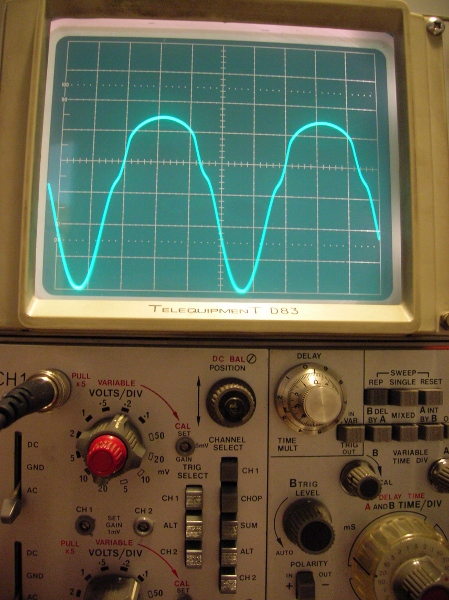

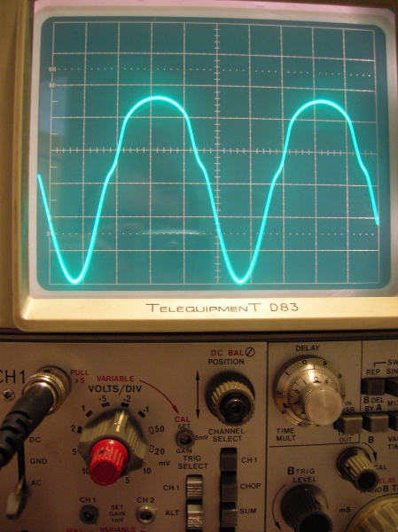

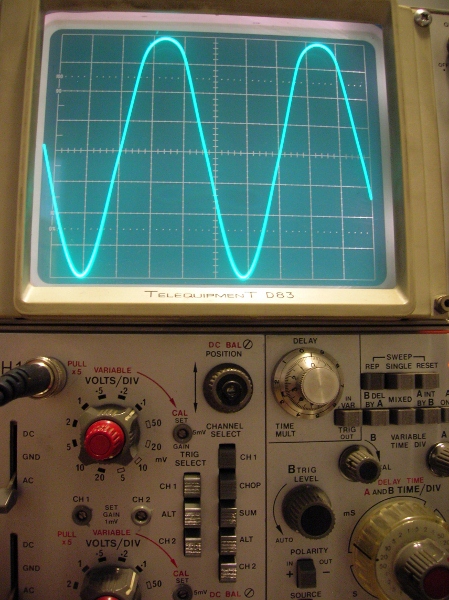

Ok here is half 6c33c..
using True RTA ,,not set up just as a signal gen..at 1Khz
All readings are with a X10 probe so you have to multiply... :)
Obviously it gets more distorted as you increase input..
The first one is 5.5V
Second is at 11V

Disabled Account
Joined 2010

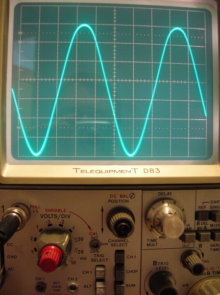

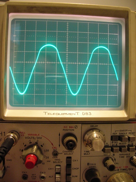

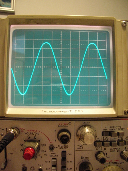

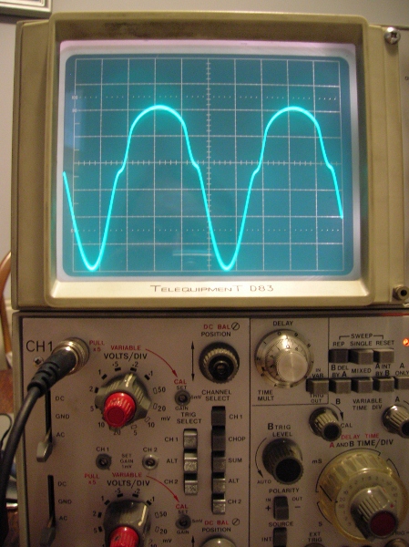

Full 6c33c..
At 8/9/10/11/12V...I did manage 13V however the 1.6A T fuse blew..so no picks ...didn't want to try it again..drawing 1.7A
Again X10 probe so you have to multiply..
