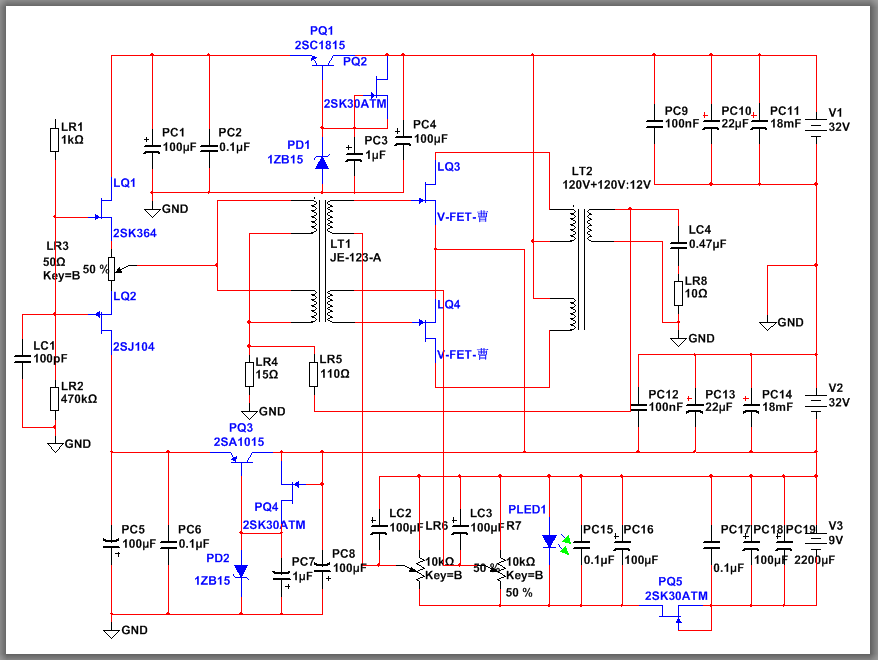

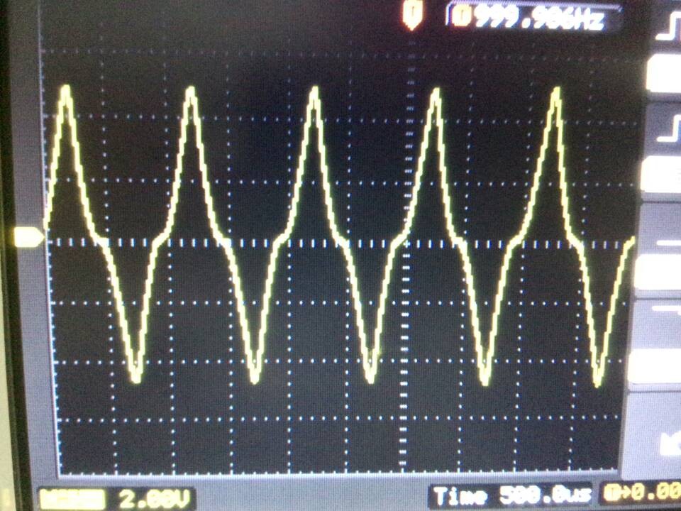

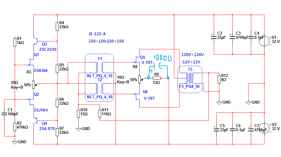

it cries for more current
starved

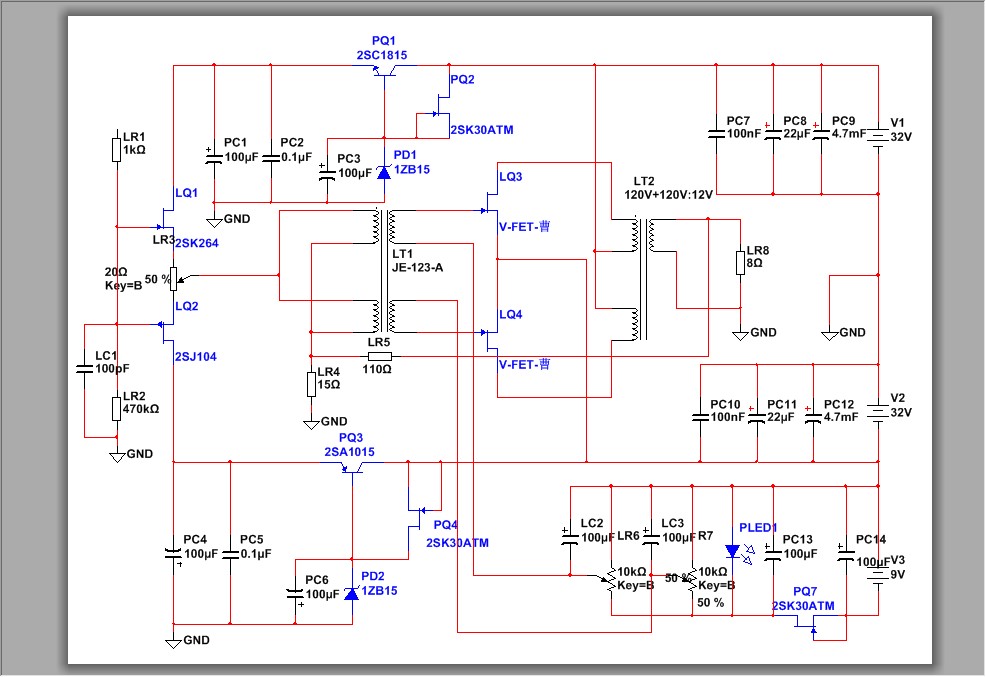

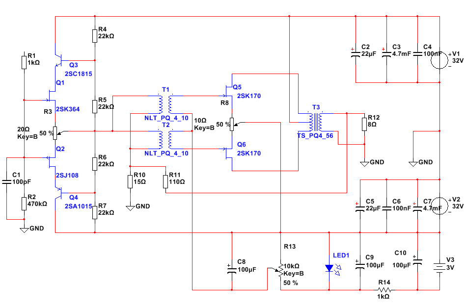

Now I changed to a fixed voltage biasing solution.
Are we trying to drive 8 ohms with 2SK170's?
No markup errors, using l CAO VFET.
Circuit diagram see below.
It looks handsome, have you built it?
Thank you Nelson Pass
I'm not the actual production, just from the principle we discuss what the problem is not.
Because it is a hobby, only can do experiments in the spare time.
