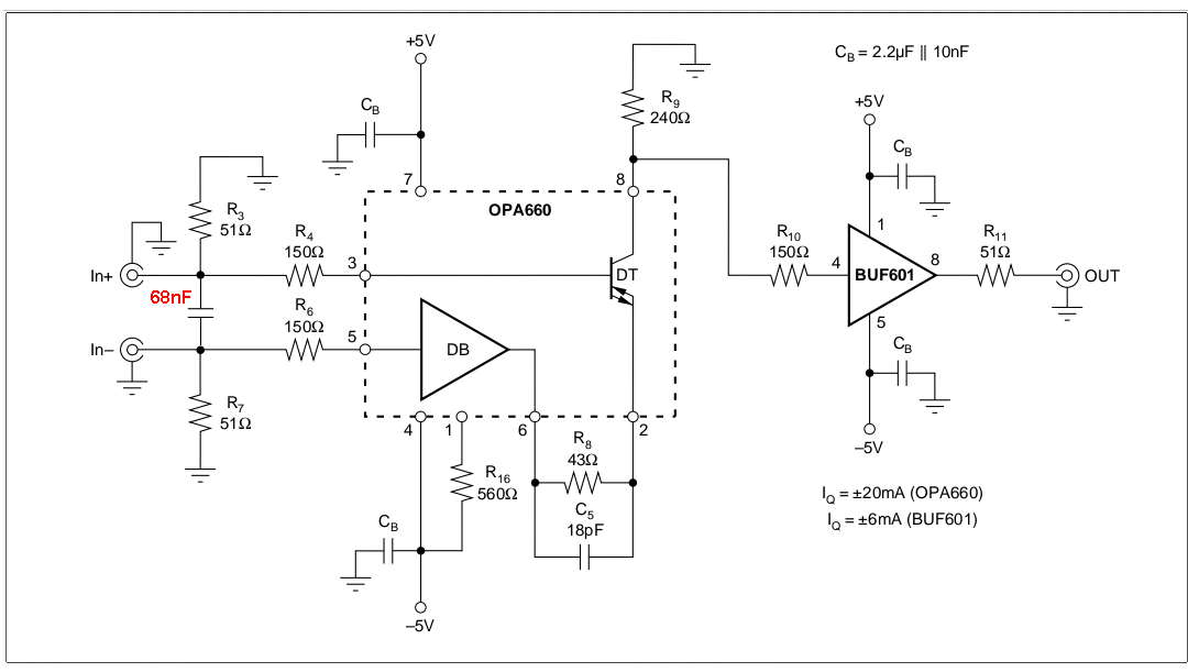

What does that mean? Connected from where to where?But put a 68nF across the input on top of R3 and R7..

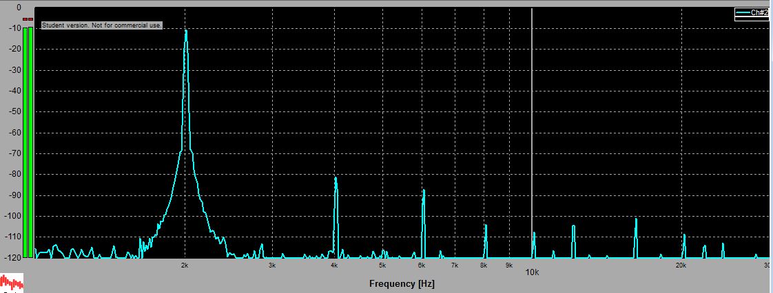

Hi George,

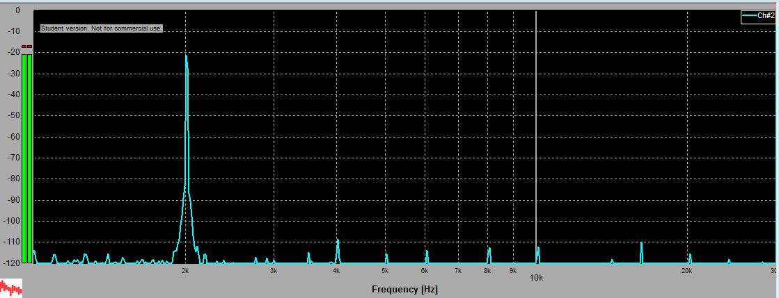

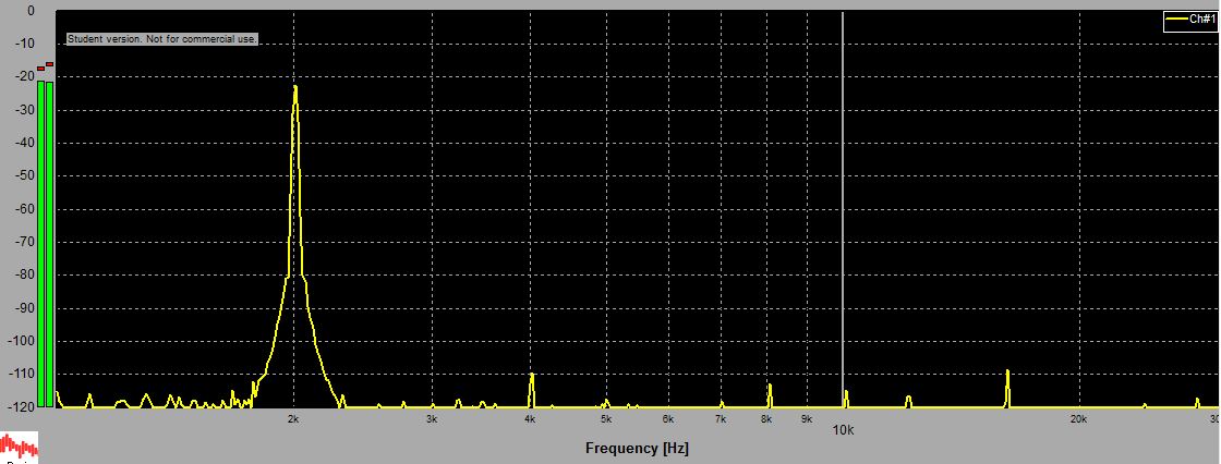

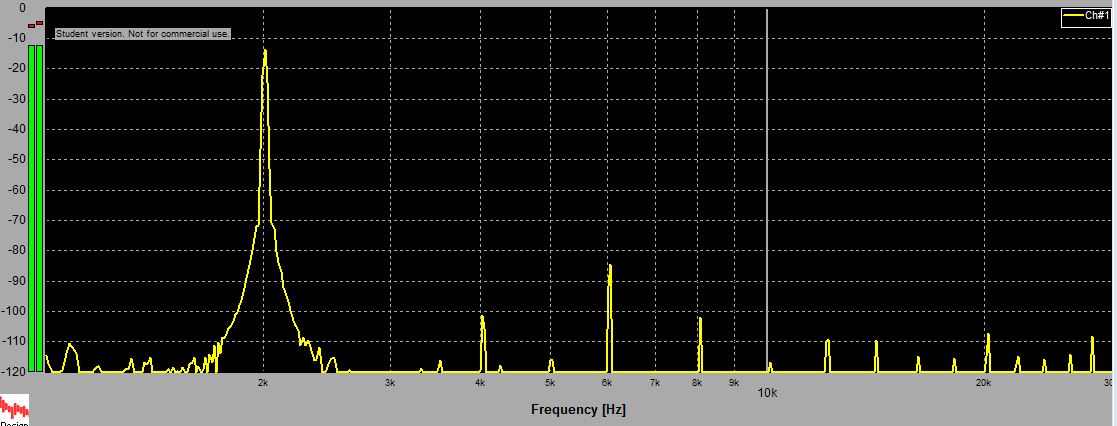

I'll post some screenshots of the analyser shortly, to verify the improved performance from "stacked buffers" - in addition to the stacked CC sections of the IC.
I found that distortion increases non linearly with the TZ load resistor which suggests that non-linearity of the transcapacitance at the TZ node might at play. Hence I've kept the TZ load resistor at 2k7.

To summarize, performance improvement with 2 buffers is mostly >-10dBfs, as would be expected - ALSO noting that the sound card input impedance is 47k.
Though, I'm not sure to what extent my sound card itself is limiting the measurement accuracy, given that the out of band aliasing products might be introducing some unwanted IMD.

Here is an alternative to stacking, in fact it may well be equal to stacking up to ten 844s.
George can still take the output from Tz Pin 5.
You also have the option of adding DC nulling as per datasheet. Note you can null both Tz and final output, but there will be some mV difference, so choose one or the other. Also, the 2SK170 current source also affects the DC point.
It can also be used with OPA-660 and OPA-860 - note then the rails need to be +/- 5V.
While the above is a suggested schematic, I have used variations of this in the past.
Cheers, Joe
PS: If anybody builds this and makes necessary adjustment, I can amend this schematic as it loads of my website - I can can update / delete / etc at any time.

I was told by those that have used this "Pedja Rogic"!!!! circuit that an output coupling cap is needed, as the dc offset for them was way out of the nulling's circuit range of adjustability. Not to mention extra noise as well they got on either output.
And the output from TZ is way to high to drive anything external direct, unless a buffer, active or transformer is use.

Re nulling, it is more than adequate, it's just a matter of getting the inputs close to matching - and a number of ways to do that. It is the offset current that causes it. You can even feed current to the "ALT" in my NonStack circuit that equals that of the DAC's.
The above circuit works really well with Burr-Brown current DACs too, the ALT input is also used. Then no problems nulling at all.
