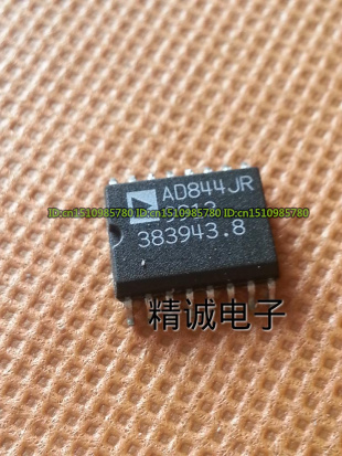

..back to purchasing AD844 from China, does anyone know which of these print styles is more likely to deliver genuine chips?
brown printing:
white printing:
brown printing:
white printing:

I just recived some that did not have the white writing and like the first pair shown, have grey/brown writing and the AD triangle logo. It looks OK, but will test them some time soon, later this week. But I suspect they are OK.
