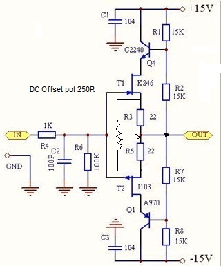

I wanted to give some 'pay back' for all the work you've done in the thread! Since you're not into Tina, feel free to request any sim.
Jeff if it's not too much trouble can you see how this SIM's up, also I'm very interested to see what the input (with & without the 100k) and output impedances are.
I may try this straight from the TZ of the AD844 next weekend

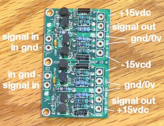

This is one of the ebay buffers from raindrophuey cost me $10 shipped all ready made up.
Cheers George

No problem!
One way to quickly DC analyze a circuit is to see gain devices as high input impedance and low output impedance.
So input impedance (w 100k) would be 100k in parallel with 2 inputs in parallel
So 100k || 1M || 1M so like 90k
no 100k: 1M||1M = 500k
Output impedance 22||22 =10ohm
I'll sim it at lunch!
Jeff
PS My same buffers had significant DC offset (+50, +80mV) indicating that the input FETs aren't matched! And the seller didn't care ...
