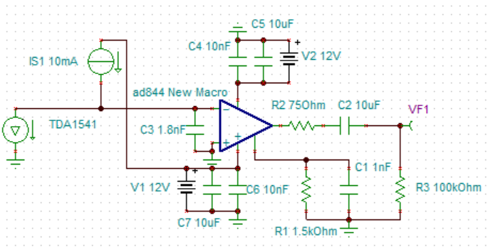

AD844/TDA1541A schematic:
Hmm, tried to sim the 1541 as a 'current generator' with 10mA DC offset, 2mA. (Is it 10mA sink?) And then cancelled it with a 10mA current sink instead of the little FET circuit from the schematic.

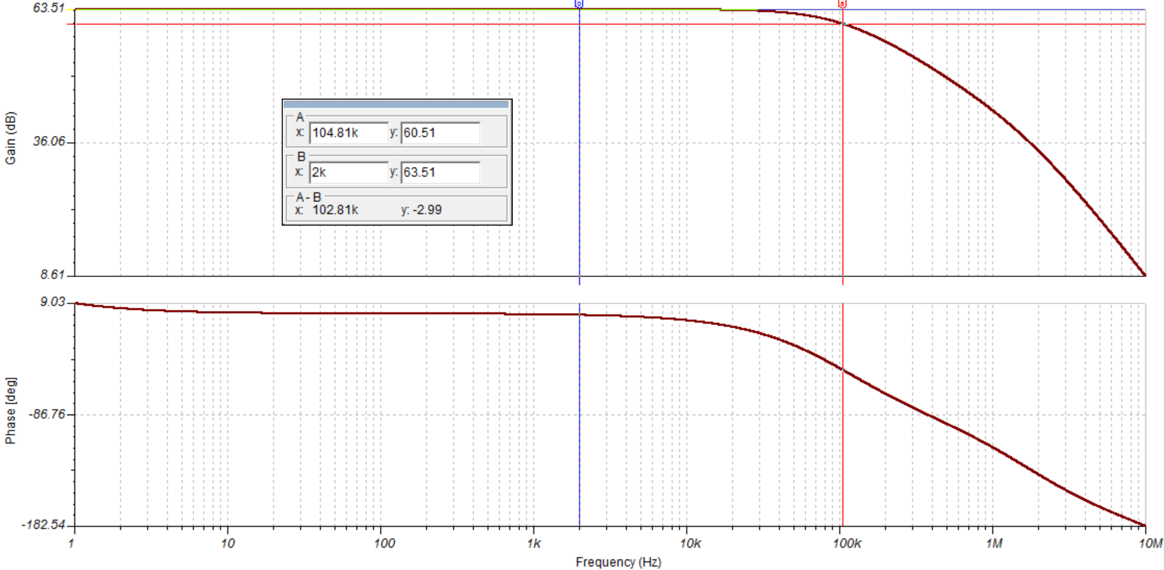

AD844/TDA1541A freq resp
-3dB @ 100k
63dB gain ?!? Hmmm, that's not right ...?!?

Anybody know how to model a current DAC in Tina (better yet TDA1541A and PCM1704!)?
Thanks,
Jeff

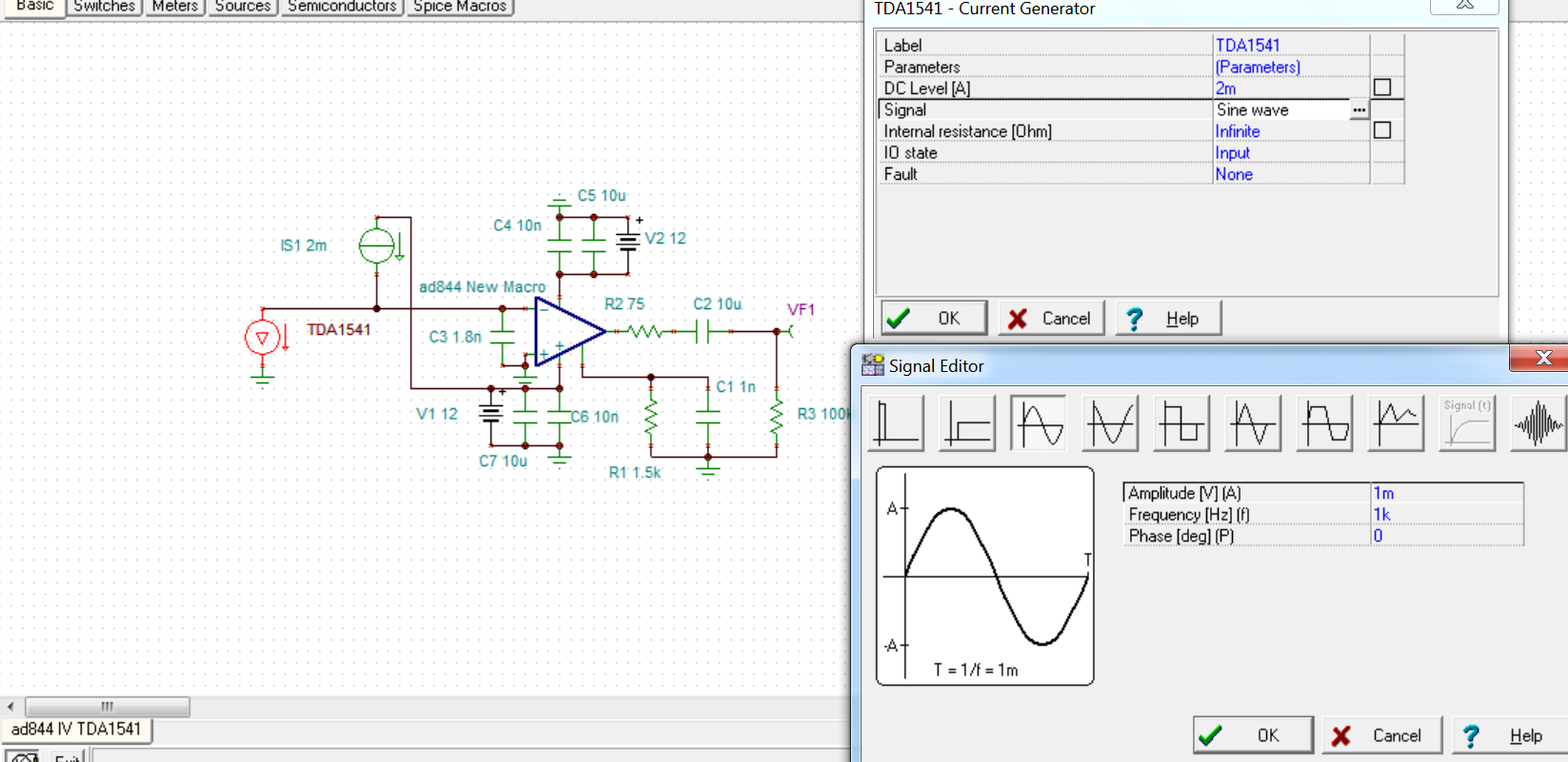

PS And I changed by 1541 current source Tina model to 2mA offset and 2mA (pk to pk) output. Is that right?

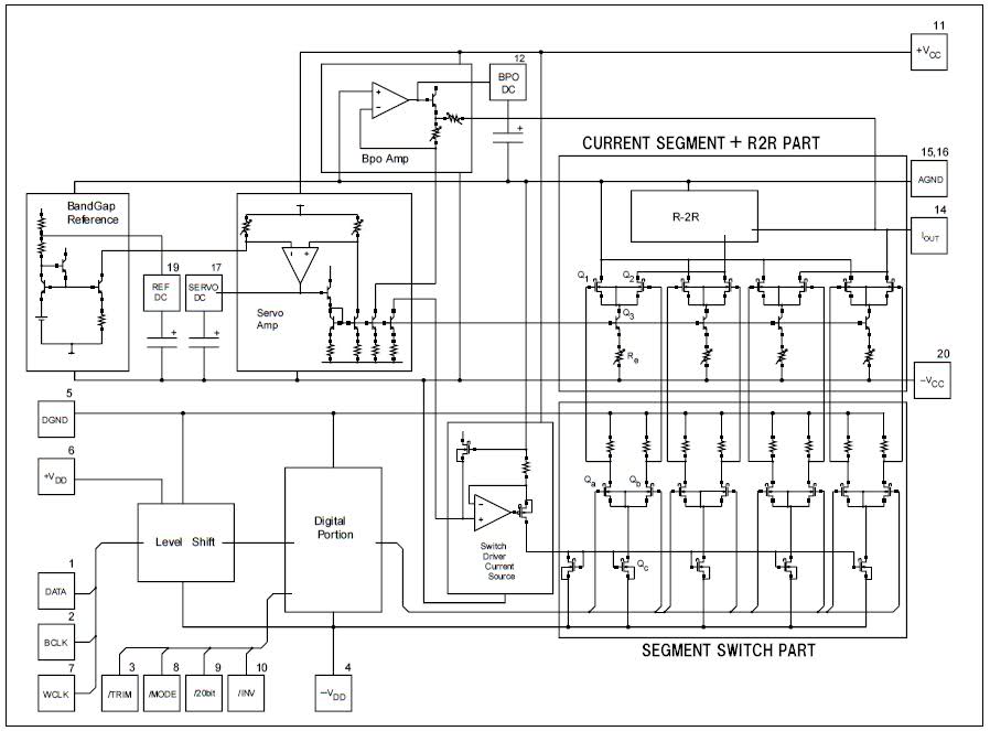

Well its jolly hard to come up with a detailed model for the TDA1541A without knowing the internal schematic. I think perhaps Thorsten knows something about that as he said he got a pile of papers from the original designers. On the 1704 you could start with two R2R networks and switches but it wouldn't get you very far. The primary difference between DACs in terms of sound I reckon is glitch performance and modelling that is very hard indeed.

63dB is not far off. I think in the 50's is about normal.
I use Tina a lot. I use a current generator, set to 1Mohm internal impedance. I think use external current sources to simulate the DC offset.
sure, cahnge the Isource to a full scale p-p pulse with ns edge rate
Thanks, this sounds like it will provide some of the staircase current waveform. What the DAC puts out.
What I'm also looking for, is more info on how the 1541 1704 "looks": RLC, like dirkwright's suggestion to change the "internal impedance" to 1M instead of infinite.

How is Tina calculating this? Usually gain is Vo/Vi but we have Vo/Ii?
The first menu of the current generator has a "DC level [A]" which I set to 2m for the 2mA offset.
If you use a probe, you can see that there is a small voltage at the input to the opamp from the current generator. I assume that it is using that voltage to calculate gain.

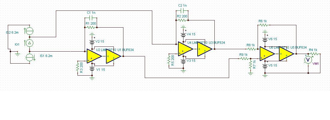

Setting the DC current level in the generator is fine for single ended operation, but the PCM1794 I was trying to simulate has balanced outputs with DC current in the same direction on both of them. I don't know about the DAC you are trying to simulate.
