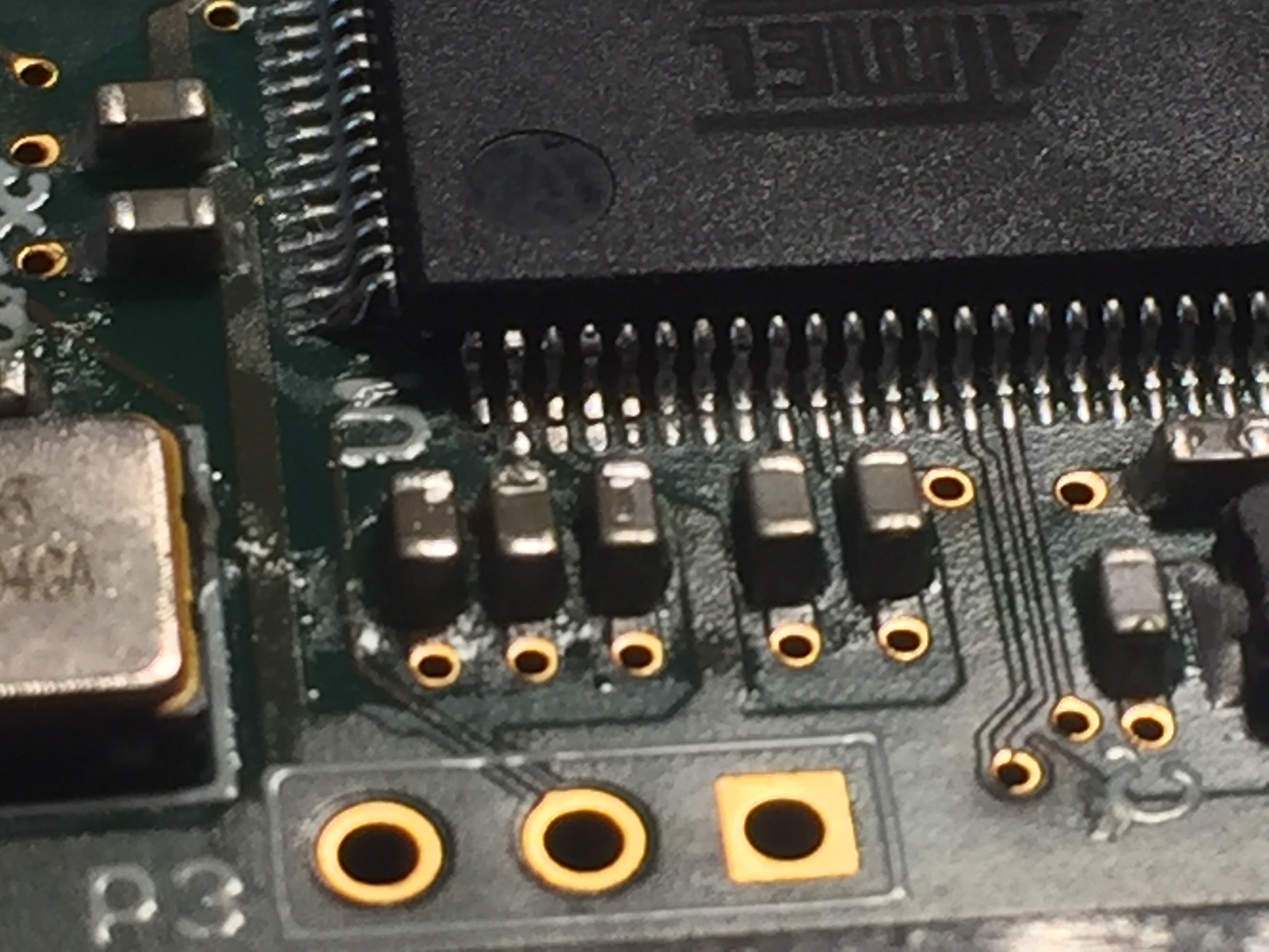

I was assembling a Chronos/Hermes/Amanero stack when I noticed what I think is a solder bridge on the first two pins of U1.
Is it supposed to be there?
Should I remove it with solder wick?
Doesn't look like it should be there. Solder wick might work, or if is soldered with lead free solder that is kind of high temp it might help to add a little 60/40 or 63/37 leaded solder and flux to make it easier to wick off.
You could try it without that first though. Good solder wick has flux in it but adding a little liquid or paste flux can help assure the solder does't oxidize while you clean up the bridge.
Also, if too much solder wicks off you can carefully add a little more. A temperature-controlled solder iron with a small tip is very much advised. Small diameter solder, maybe .4mm or a little less, and the lowest temp that melts the solder and activates the flux in the wick would also be good.

Hi sbelyo,
I just checked my Amanero board and there is no solder bridge on mine.
Personally I would remove it with a relatively thin solder wick and a quick heating and then - with a thin soldering tip and solder wire - quickly resolder the pin connections that were affected by the solder wick.

well, I made it worse by not waiting for the solder wick. I bridged anther pin or two. The solder wick cam and i was able to remove all the bridges but it looks like I lifted the pad under that first pin
Not sure if it's going to work but I'll try it
Here's the post with the before pic
