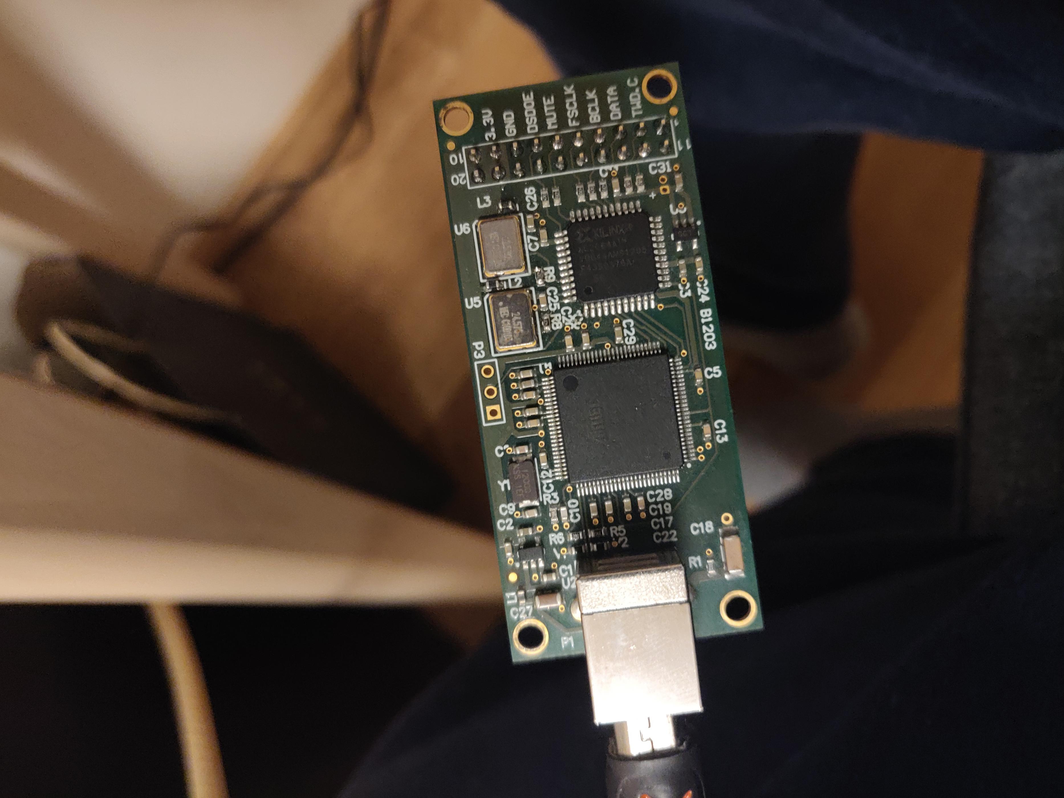

Hi, I have one of these Amanero-clones. It seems to only be able to output DSD. No matter what format I put in, it always comes out as DSD. Even when I just power it via USB without data line, the DSD Clock (BCK) pin starts outputting a 2.8 Mhz clock signal by default.
I would like to be able to output I2S as well. Tried messing around with the firmware but this being a clone the official updater tool doesn't support it ("transaction not authorized").
Anyone having the same experience? Any solutions?
I have a problem with updating the firmware of my Amanero, sent an email to Domenico but I get no reply, anyone knows a way to contact him? I get the "invalid or not authorized request" message which happens to fake devices but mine is not, I believe, I think I bought it years ago from him.

Hi Forane12, please write to support@amanero.com to contact Domenico.
