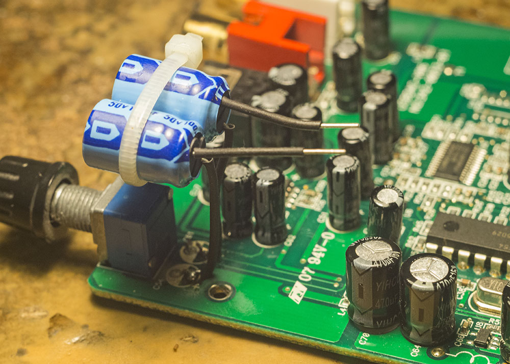

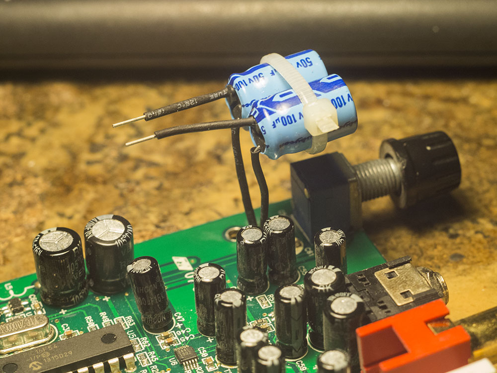

I've successfully removed the two caps on the DAC outputs, just before the potentiometer, and soldered a pair of Rubycon 100uF 50V caps I happened to have in my bits box to the positive solder pads, with the negative leads floating so I can connect two wires to them which will lead to the output RCAs.

Here's how I installed the pair of Rubycons for DC filtering after removing the two caps onboard, which means the volume pot and the onboard outputs and the headphone amp is not connected anymore.

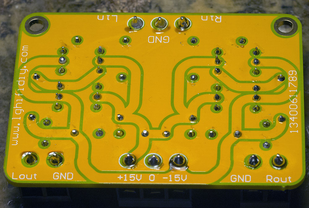

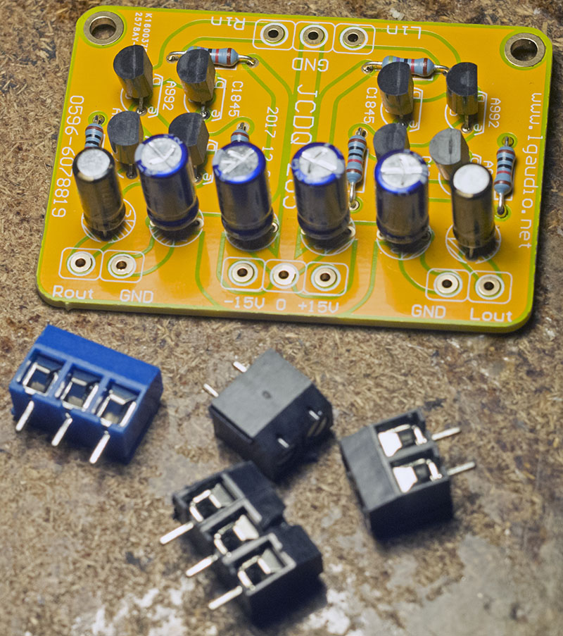

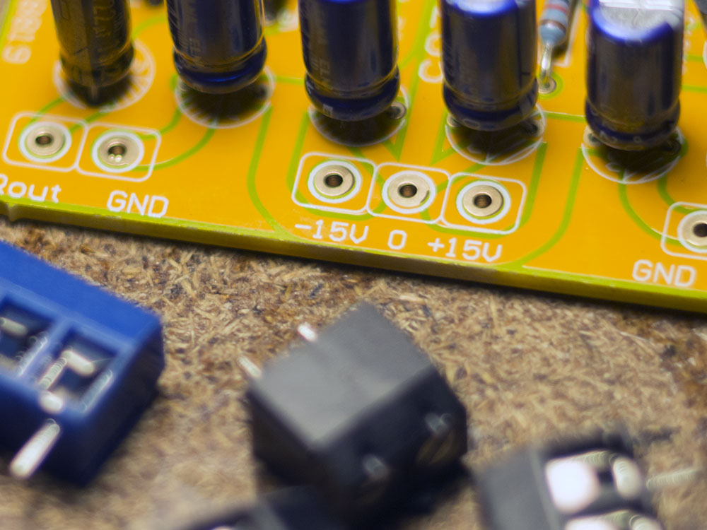

Here's the output buffer board, which I will probably have to use to reduce the high impedance of the Cirrus DAC's output, I added screw terminals and my soldering is getting neater,which is a large part of why I am doing this simple build - to get some much needed practice and improve my skills while also learning much that will prove useful for my next, better build.

The transformer I'm using also has a secondary winding that gives 15v output. I also happen to have a diamond buffer card that runs off 15V. It has three terminals marked +15V, GND and -15V. Does this mean I can run this board directly off the 15v AC by using the +15v and -15v terminals or do I need to rectify the AC into DC and pass it through a regulator and some smoothing caps in order to power the buffer? If I do so, then I would use the +15V and GND connections?
No, you can absolutely NOT do that. You need a power supply with bridge rectifiers, smoothing caps and regulators to turn the AC into DC voltages that the board can use.
