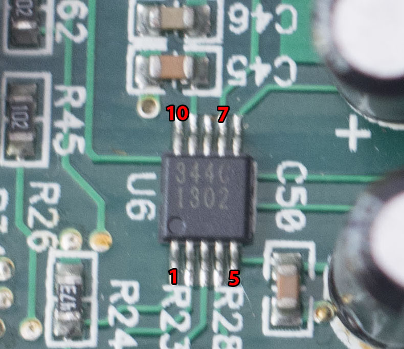

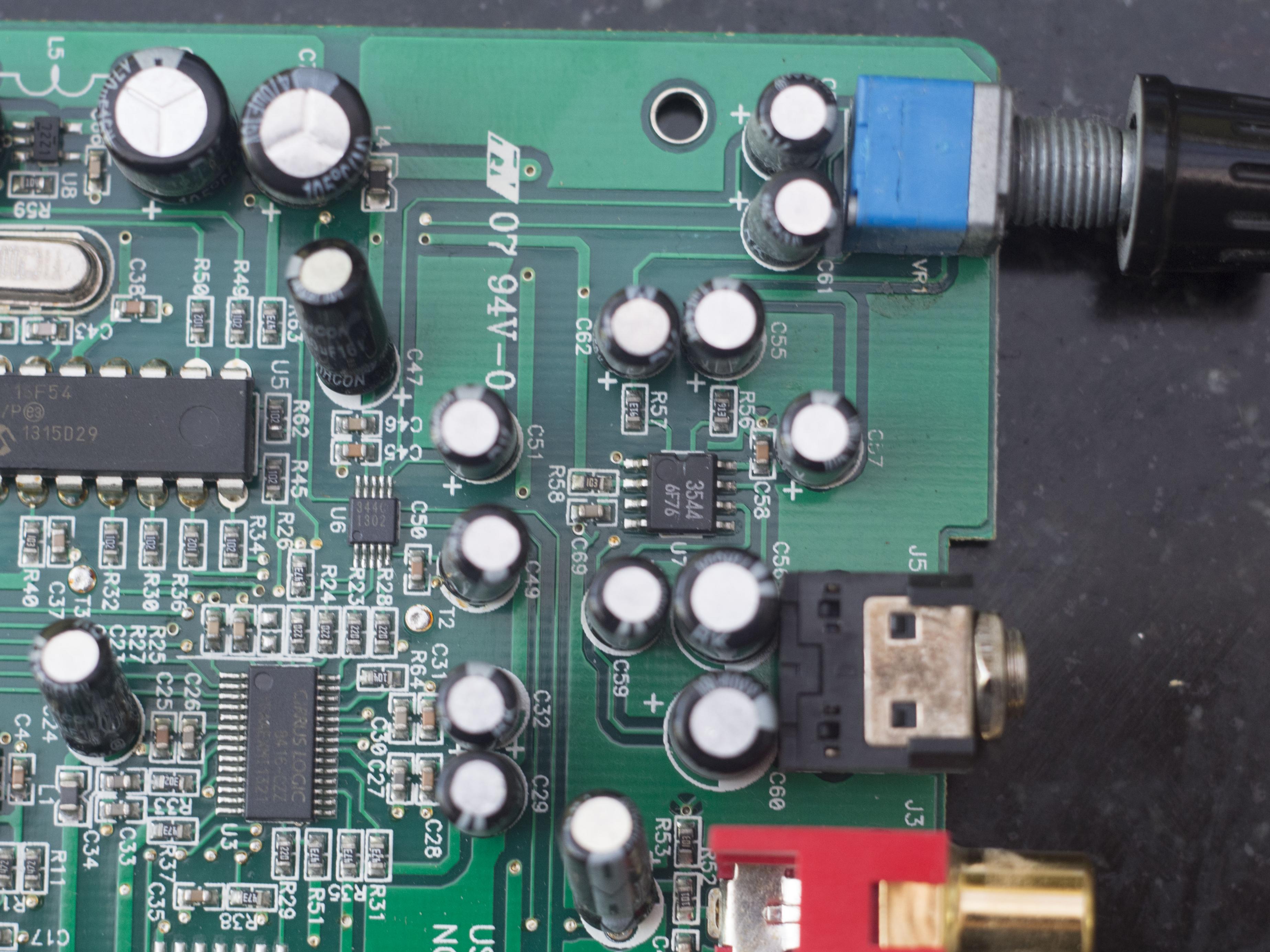

Can anyone help me identify the output pin of the Cirrus DAC chip, so I know where to solder on a couple of wires to bypass the onboard output circuitry:
688006d1529599723-upgrading-cheap-cirrus-logic-cs4344-24-bit-192-khz-stereo-dac-p6210125-jpg
688007d1529599723-upgrading-cheap-cirrus-logic-cs4344-24-bit-192-khz-stereo-dac-p6210126-jpg
Cheers, according to that datasheet The output pins are 7 and 10.

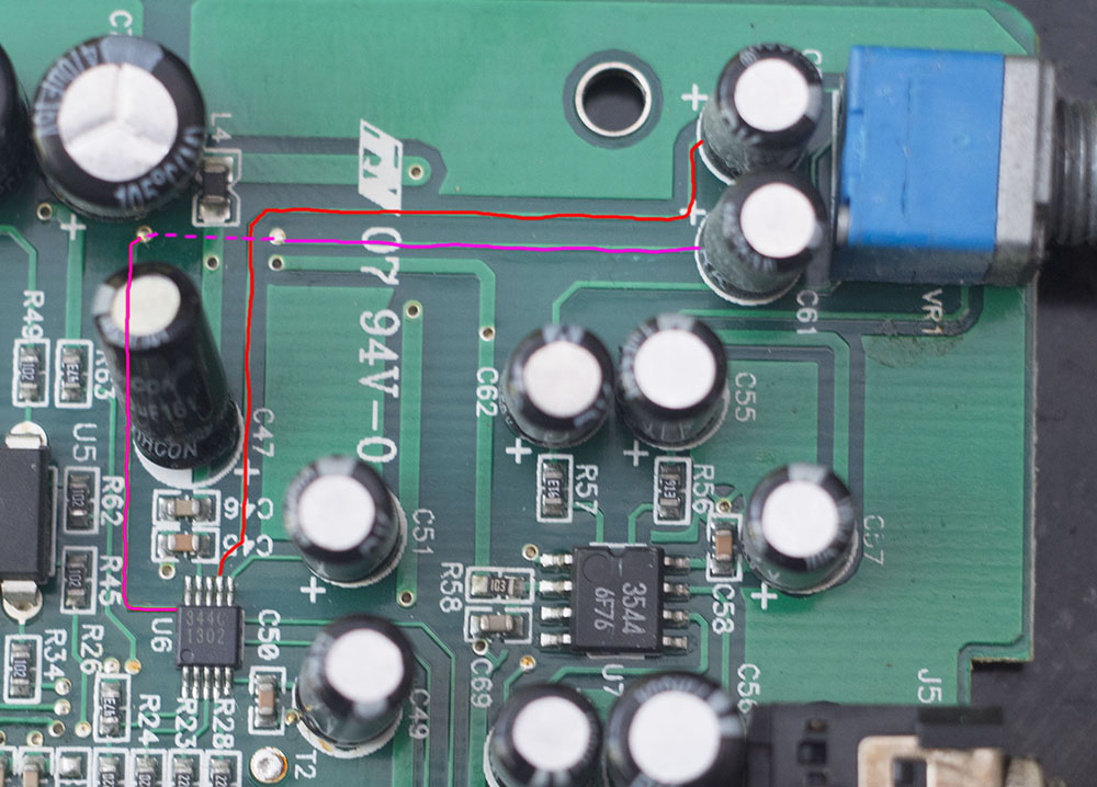

Just to make sure I'm not confused, I made this annotation to check:
attachment.php
I traced the tracks on the board and it turns out they lead to the volume pot:
attachment.php
Long traces like that before going into a couple of caps then into the pot doesn't look like good practice to me, but what the hell, this is a cheap thing so be it.
Looks like the best place to solder on the wires is the pins of those two caps, there is no chance of me being able to solder wires to the teeny pins of the DAC chip itself.

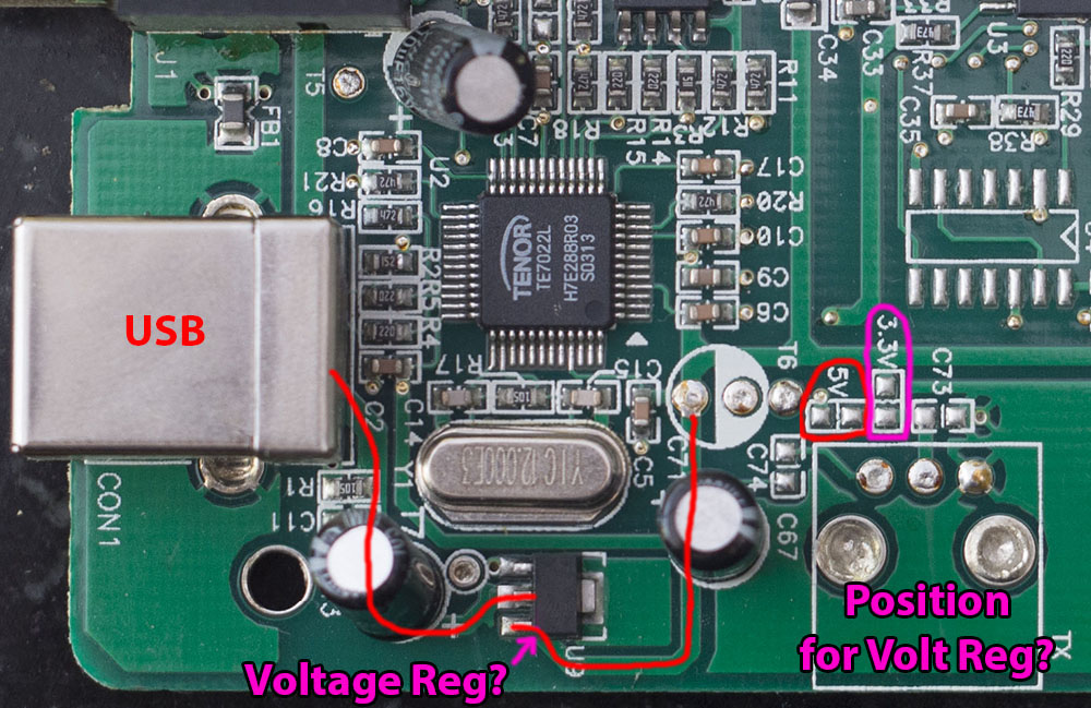

The other thing I need to figure out and am confused by is how the power input to this thing works. It only has a USB connection, no other way to connect power to it, so it takes the power from the USB.
There is what looks like a very small voltage reg on the board, and solder pads for a much larger regulator, with a cap placed both before and after the small reg.
I'd like to connect a 5v supply to this thing, other than via USB, the question is where to connect to?

Are there any markings you can identify on U9? I would guess it'd be an AMS1117 3.3V reg but the way you've drawn the red lines doesn't agree with its pinout.
Incidentally what you've labelled as a potential voltage reg is probably just a Toslink connector. The give-away is the two letters 'TX' on the silkscreen (bottom right) - its a Toslink transmitter for S/PDIF output as an option.
