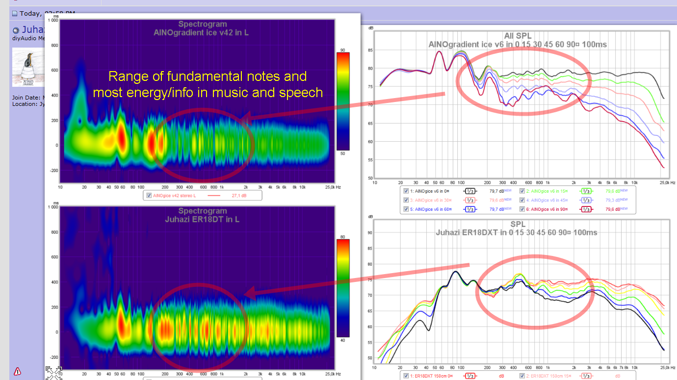

I have messed around a dipole speaker project with numerous measurements. For a sanity check I measured also my 2-way BR speaker, a variation of MarkK's ER18DXT. I can verify that in my conventional living room with RT around 0.3 - 0.5, The dipole spekers produce significantly more accurate and pleasant sound. Reflections, seen as spectral decay up to 300ms are markedly less with the dipoles (one speaker's measurements shown here.

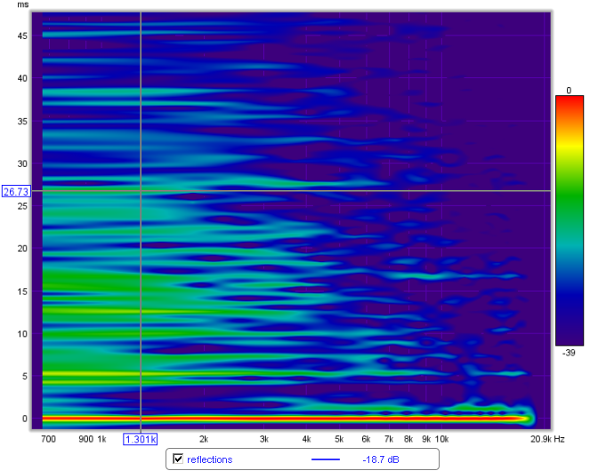

Your spectrogram would show actual room reflections if in controls group time range is set around 50ms, and window to <3ms. In SPL, if offset is set to bring peak range to 0db, then range in spectrogram plot will give good indication of reflections general intensity.
Here is listening position with clone of Linkwitz Pluto:
With little effort, walls, ceiling, floor, and combinations of reflections can be identified by horizontal banding.

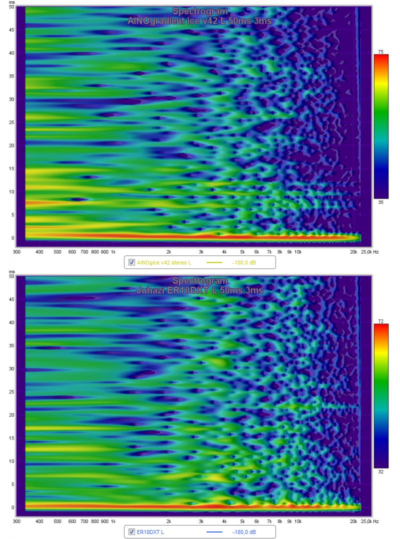

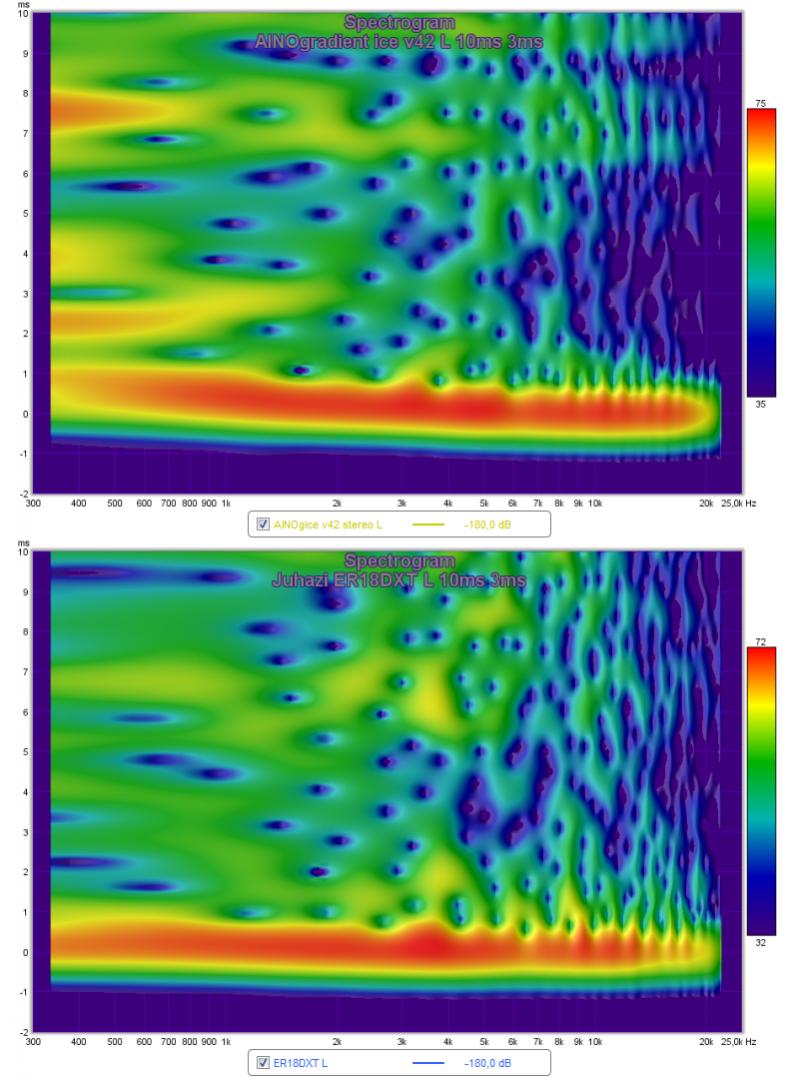

Here are same measurement in diferent scale. Window is 3ms in both, scale 10ms and 50ms.
How to interprete this? Aino has less early reflections and more late reflections?

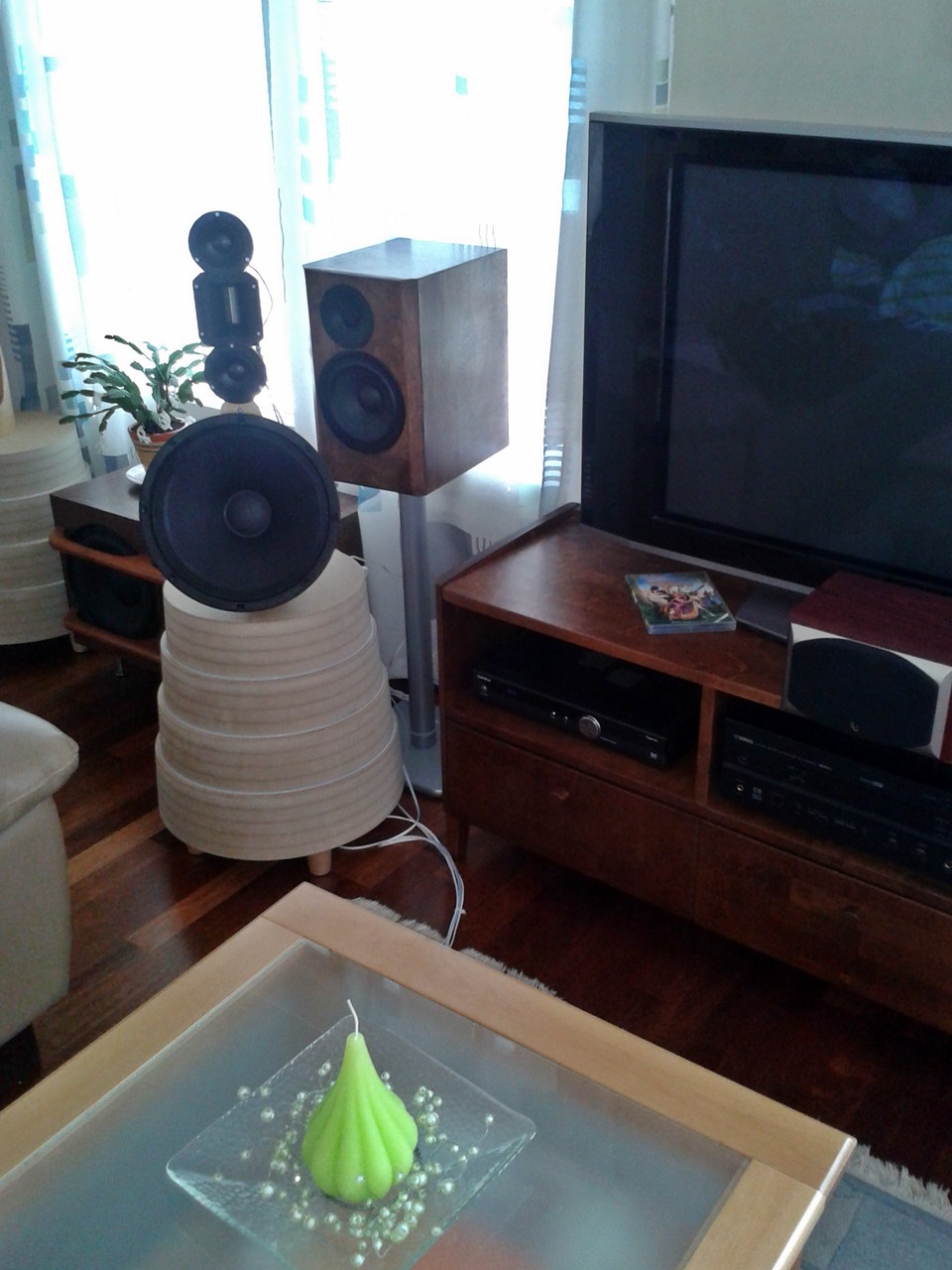

The auditory remarks are that AINOs have remarkably better imaging, instuments and players stay on their seats, handclaps of a live recording are very precise etc. This is exacly what I was hoping and expecting for. The difference is not very huge, because ER18DXTs are quite good at imaging too. I don't have omnidirectional speakers at home. My Sonab OA-13s are at the summer cabin!
A photo of the setup (not exactly but close..) The speakers were next to each other. Notice the window and plasma tv on the "front wall" and the glass table - a really non-audiophile setup!

"Looks like the AINO one has more reflections period"
- yep. But they are rather late concidering perception. In my previous psot we can see that Ainos generate less very late reflections/decay (100ms or more) The dipole function of AINOs is ~200-3200Hz and it means that it radiates backwards as much as forward, but different phase. This means minimal radiation energy sideways. Generally dipoles should not be close to the front wall. My measurements show why!
