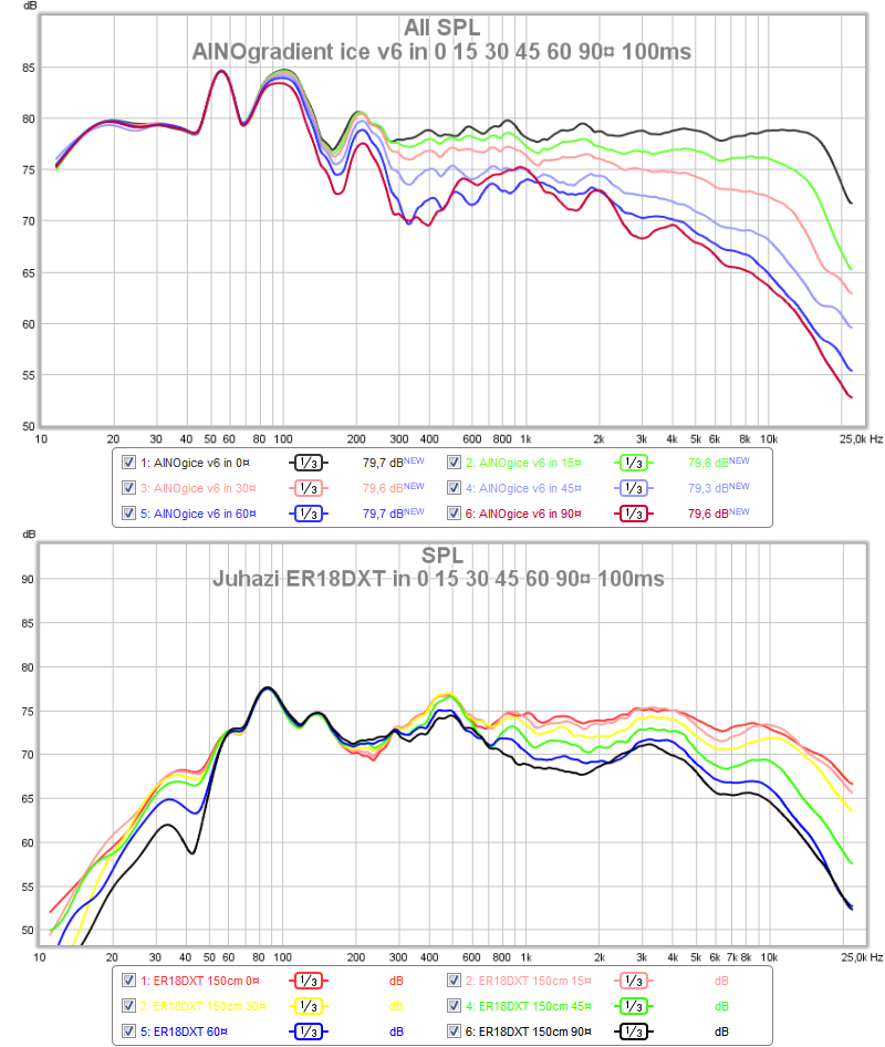

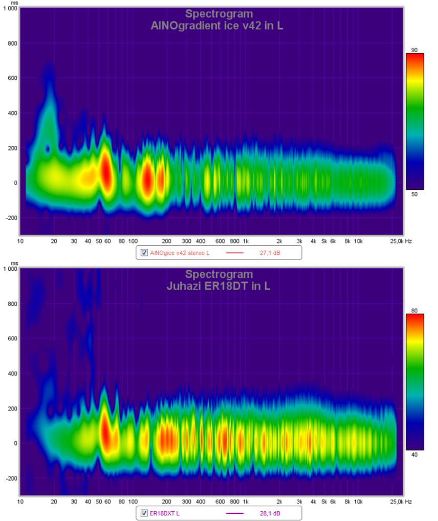

I have messed around a dipole speaker project with numerous measurements. For a sanity check I measured also my 2-way BR speaker, a variation of MarkK's ER18DXT. I can verify that in my conventional living room with RT around 0.3 - 0.5, The dipole spekers produce significantly more accurate and pleasant sound. Reflections, seen as spectral decay up to 300ms are markedly less with the dipoles (one speaker's measurements shown here.
351889d1370027866-aino-gradient-collaborative-speaker-project-ainog-ice-v1-room-rt-edt.png
