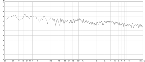

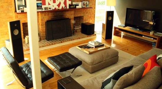

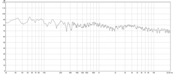

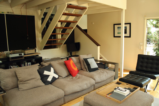

Hey - have you looked how he sets the speakers - they are like 2 meters from the front wall. He also tells that this is important! It is definitely the only real solution to this. We can see that his living room is far from ideal and symmetrical and has hardly any acoustical treatment done. My current sound and video setup
It's a very different approach then CD speakers. This will give a spacious soundfield, but not an accurate one. Personally I don't like high gain specular reflections and I know this setup wouldn't impress me in the long run. Sure, 2 m from frontwall helps some, but you have to remember that dipoles send as much energy behind as they do forward. The result is often a quite poor frequency response besides specular reflections.
Take a look at this setup with Orion speakers. The response is awful. 10 dB difference above 1 kHz! Believe me, you would not see that with a well designed speaker. Even if the room may have some major problems.
