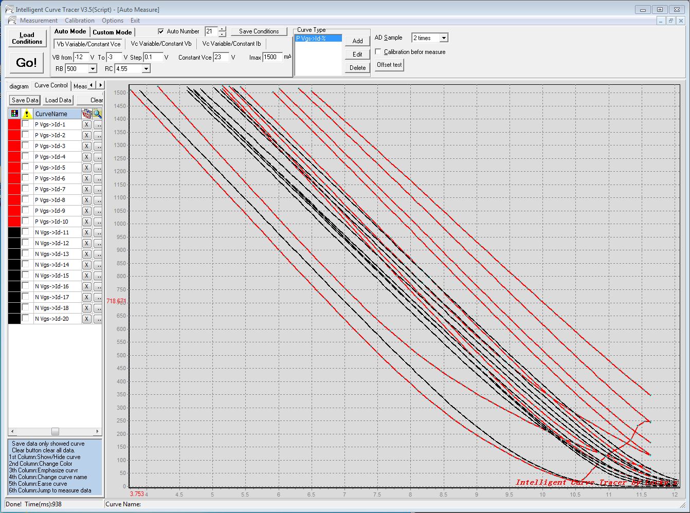

O.K. I build the skeleton Nelson showed with the beamer at Burning Amp Festival.
- with the two voltages shown for the complementary Acronman SITs 8.0V and 7.4V I had a much too high bias current around 2.6A or more, I switched off very quickly….:D
- with 11.9V for the 2SJ28 and 8,35V for the 2SK82 I got 1.2A and only a small offset of 8-10mV. Of course changing when the SITs heated up.
That looked good….
but there was only heavy hum coming out of my speaker….:rolleyes:
Two possible reasons the Edcor XS4400 has no good place, or the two small PSU are not good enough in hum suppression, the data sheet speaks of less than 50mV.
So it seems that the SITs are less matched or similar to Nelsons pair than we thought.
I think you should go for 15V for the supplementary PSUs to have enough headroom for SIT variations and it must be more quiet than mine.

Two things, the SITs are sensitive to supply ripple due to the low Drain
resistance (triode...) You need a low noise regulated supply.
Also, keep in mind that the Edcors use steel cores, better suited to higher
level signals than the 50% Nickel, so you will see some differences there.

I have measured as good as I could ten SJ28 and nine K82, so I dare to say that at 1,3A for instance the working point of Papas Push-Pull they differ around 3-4V
There is one SJ28 KF instead of KE but it is not outside…….
As far as I remember the KE and KF was a pinch Off voltage and this marking seems not very important for the matching of Iron AmP or the SONY AmP…..
Of course my input data I choose for the tracer are self-made without any deeper knowledge….:(
I am always happy to see at least a curve…..
the picture shows in red the SJ28 and in black the SK82..
Horizontal axis the gate voltage, vertical axis the current in mA
So you see that it is possible to find closer pairs!
