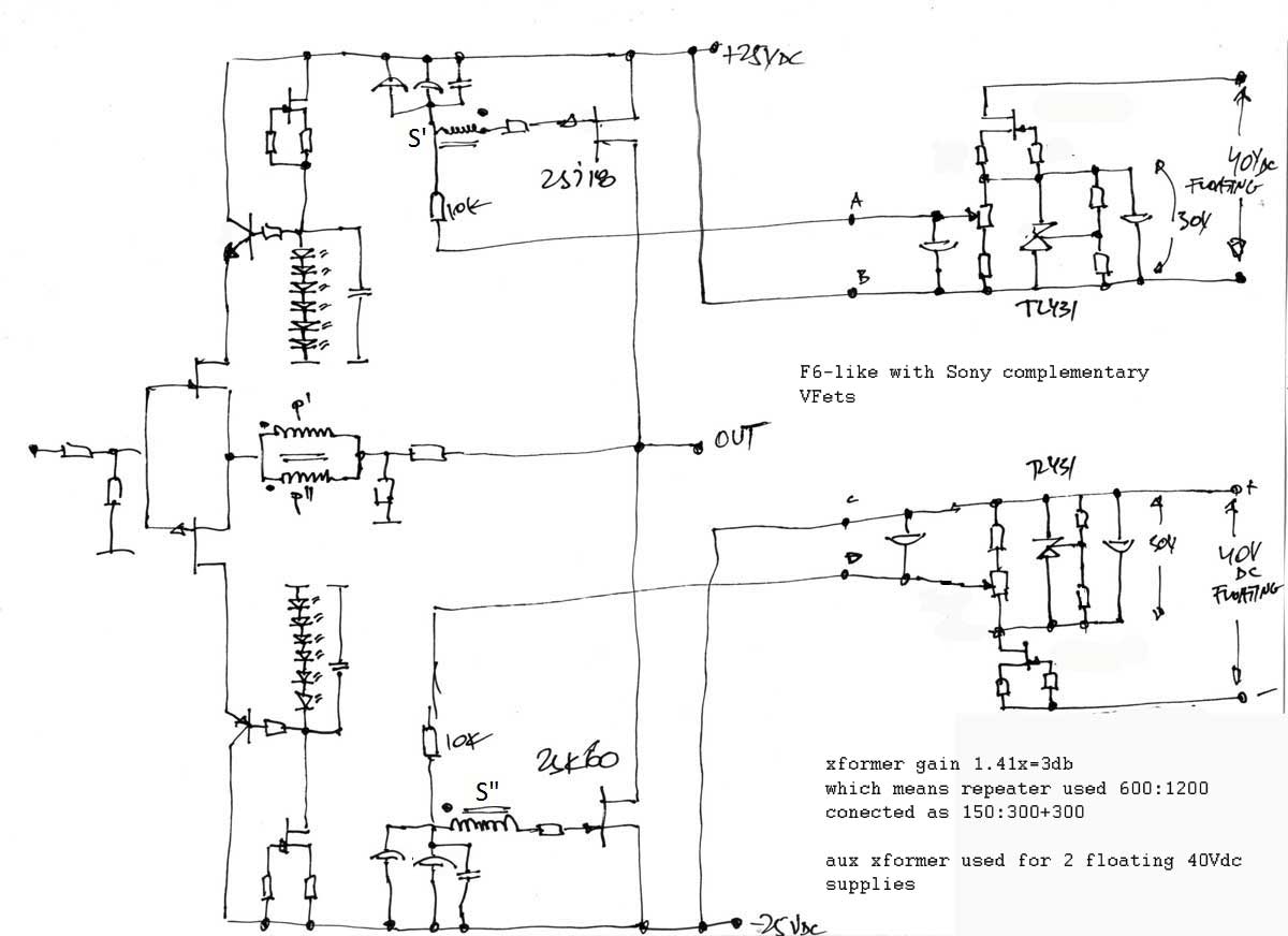

Ultrasimple SIT PP amp from BAF , or SIT Beast with a Thousand PSUs
Joined 2006
Uploaded initial pic stolen from Waveborne.
Official Court Jester
Joined 2003
here it was , several months ago , in frenzy F6 thread : http://www.diyaudio.com/forums/pass-labs/216616-f6-amplifier-172.html#post3323995

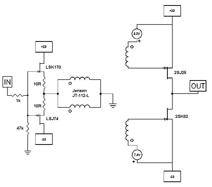

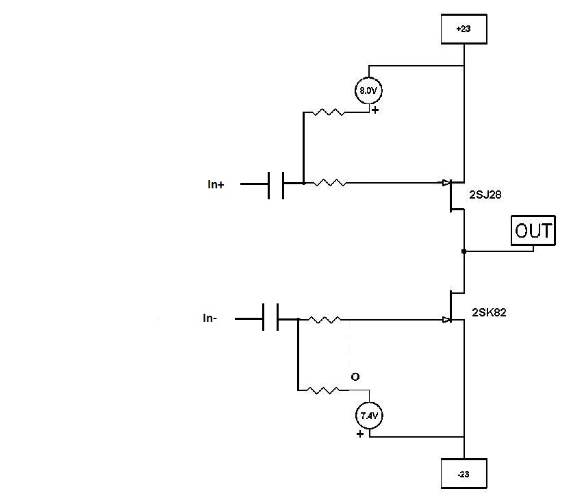

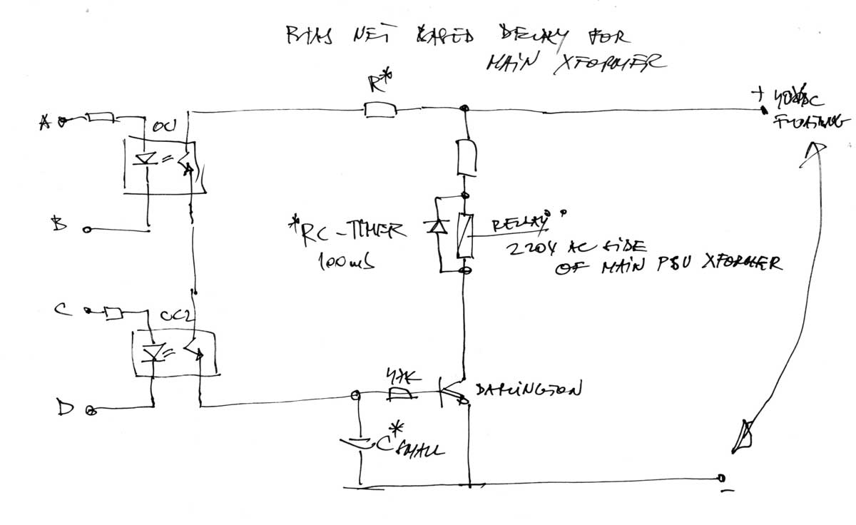

I'm sure that Pa shouldawouldacoulda make it mucho simpler , with few voltage multipliers etc (taking in account appropriate RC constants for main vs. aux PSUs) ;
however , for really fast-finger-solder ones , Juma already made what's needed in his SIT PP thread

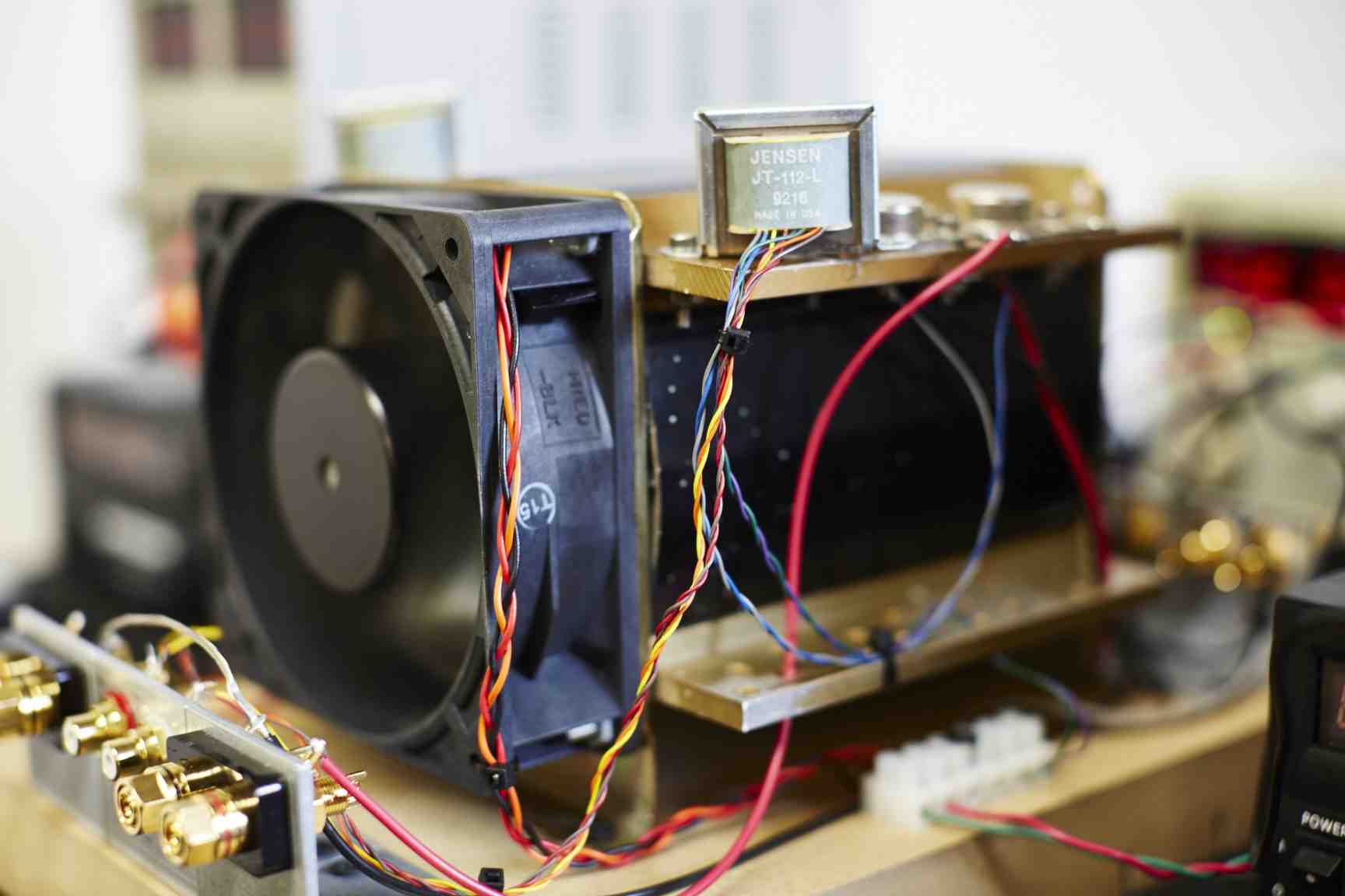

Is it possible to cool these TO-3 transistors passively? What are dissipations 60w/device...

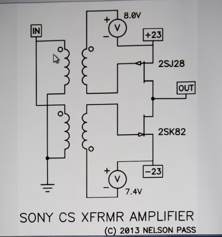

Didn't Pa say: cap is better than xformer, arguably ;-)
Yeah I do remember him saying that, at least at the output, he might feel differently about it used as a voltage gain device driving high impedance.
Pa likes to play freely, there's no progress if you build stuff you already know works well.
Notice that in this amp he was able to select a transformer that gave a flat distortion vs frequency response curve.
I think the buffer front end will be almost mandatory for quite a few of us
