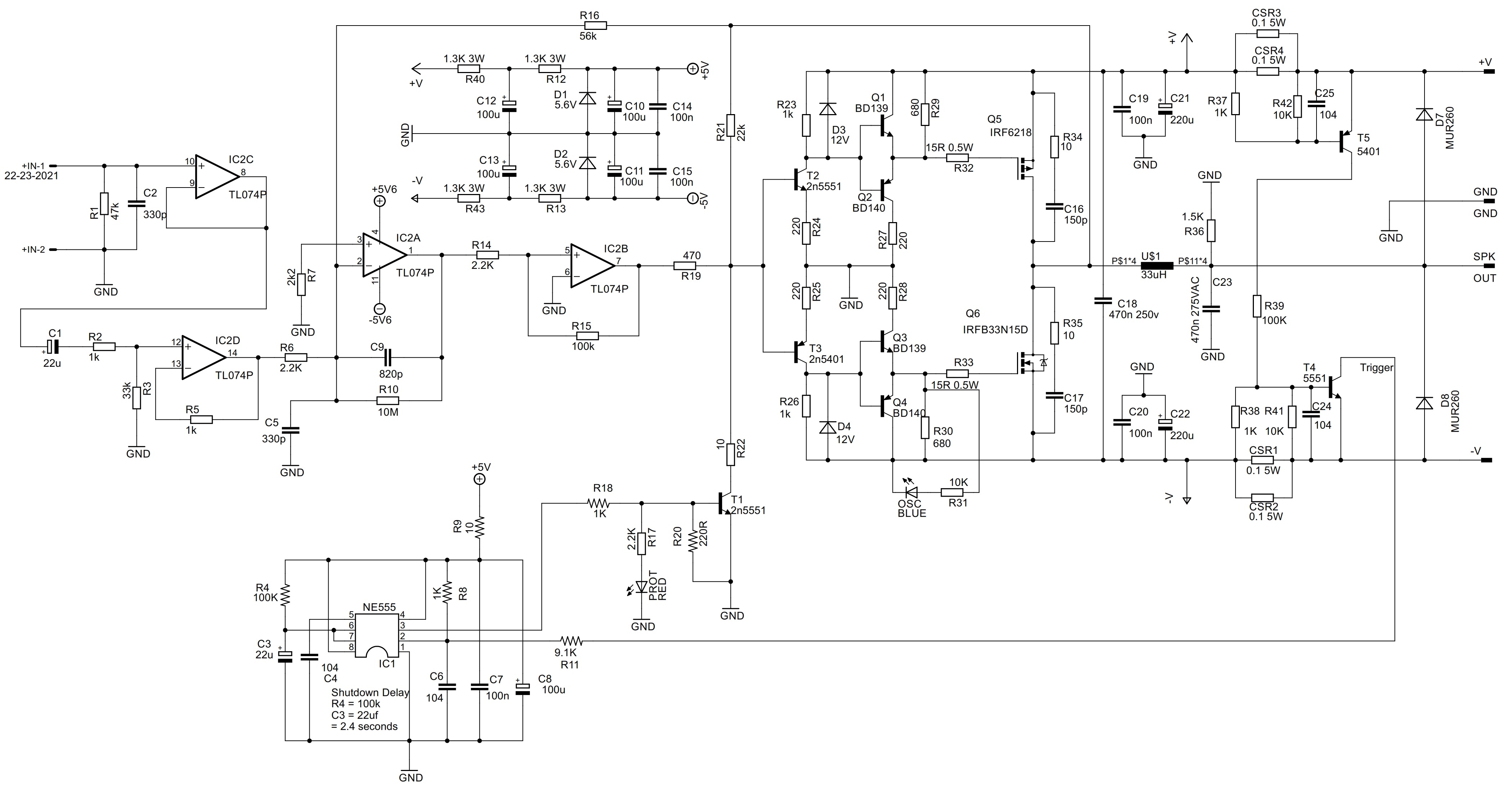

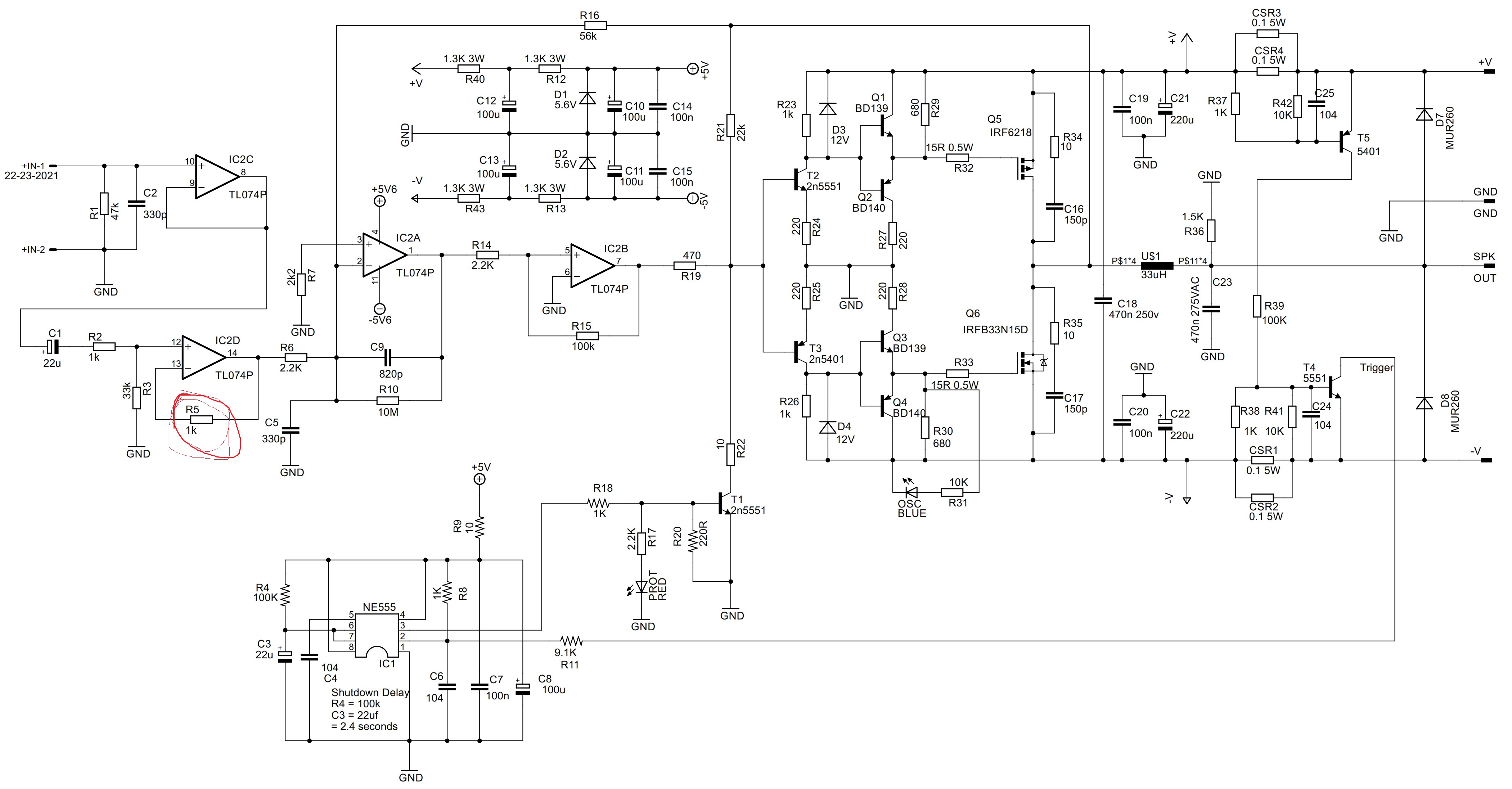

Ultra Simple Class D
Currently working on 250W @ 4 ohms version using IRF6218/IRFB33N15D.
Reworked protection circuit, high/low side protection. Double sided PCB.
Will share schematics after I tested the prototype. :)

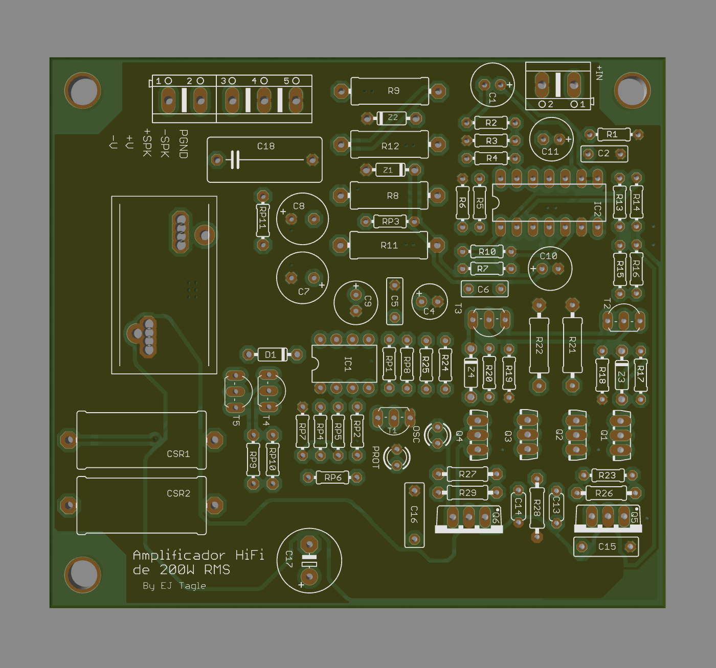

Here's a quick layout, it's not the best but it will work. Size is less than 10cm x 10cm so manufacturing will be cheap.
You can put VER2923-333KL, ICE 1D23A-330M, T106-2, T106-6 (33uH)
I cannot share PDF because it is 2 layer and some traces are very thin.
Attached gerber file.

Final and free gerber file.
PCB size: 3.4 x 3.8 inches

hi jlester thanks again for the share . how and where can i adjust the current for the amp protection?? i wanted to push the amplifier to 18amps.

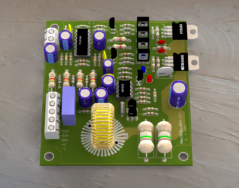

:cool:hi all finally smd version completed :UP: :D:D
:scratch: instead of bc337 and 327 i used mmbt 3904 and mmbt 4403 any comments are highly appreciated
but mmbt5401 and mmbt5551 i have and i will use. i use tl074 from ti (texas instruments) as they are the only ones which work with this circuit.
In your layout GND is treated very badly, has very high inductance between different points of it. You need a very much cleaner GND to avoid interferences.
