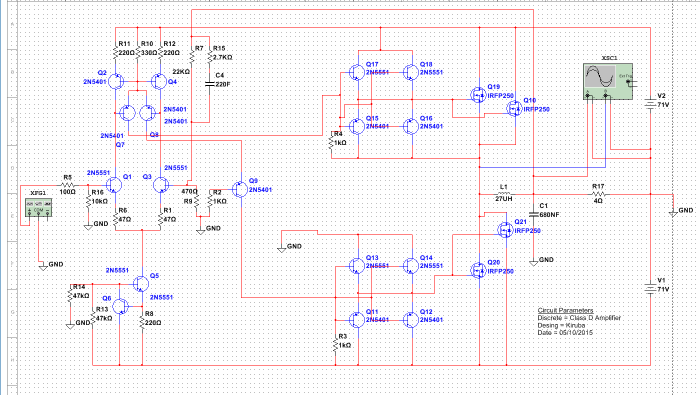

hi to all,
andrew or any one can simulate the schemantic and post the results, because my software got error.
thanks to all.

It will not work. Not just because 220 F is 1000000000000 times higher than you need, and R4, R3 are too small (or R10 is too big), but also there is not enough voltage for driving high side MOSFET, and there are some other minor mistakes also.

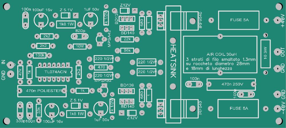

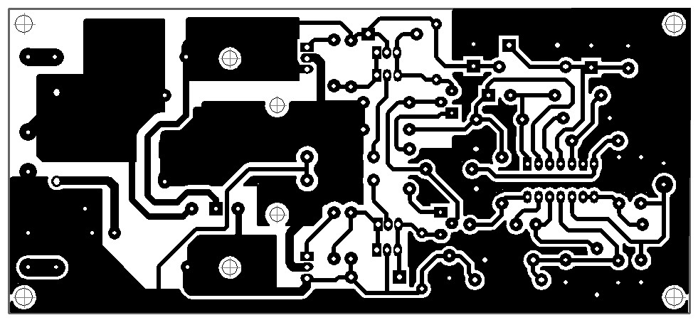

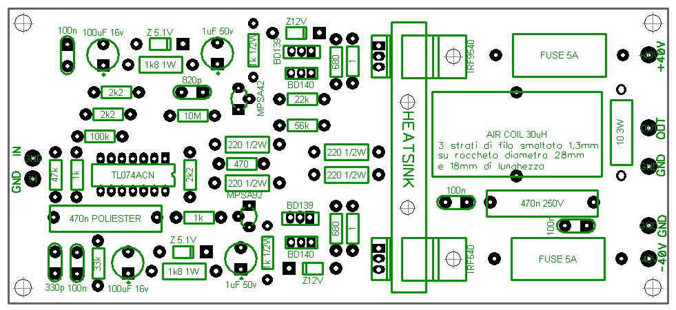

I want to share my project .
I prefer to use air coil to prevent saturation distorsion.
Build the coil on 28mm diameter support and 18mm lenght, with wire of 1.3mm.
About 30/32 turns.
No hot at max power.
About 30/32 turns.

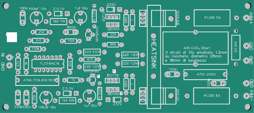

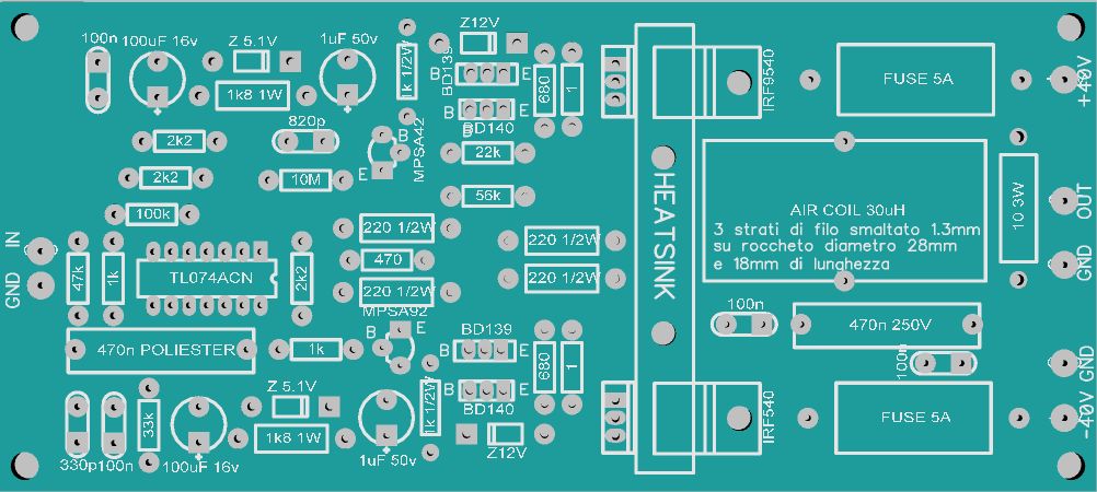

Please can you share the schematic?
I can't see the transistors oriendation(ebc) no at mpsa not bd139-140
Kartino, some time ago I found this: http://www.hypex.nl/docs/papers/AES118BP.pdf
Your UCD solutions seem to be based on this design, except that your feedback is slightly different. Would you care to elaborate why you deviated from the AES paper design?
I'm aware that the AES paper design is a concept, and it relies on the circuit delay to establish oscillation. Perhaps adding a delay to make things more predictable is a better way to go about this design.
I like this design, and most probably I'll build this one soon.

The schema is not my design actually in term of topology. The reason of the feedback of mine is to minimize numbers of parts. It was a challenge in my group, what will looked liked the UCD with most minimum numbers of part. Please understand this reason behind.
For small amp, the kind of feedback is working just fine anyway. But it will need adjustment for dead time for soft to hard switch. Try to put higher value of R12, maybe put VR100 ohm in series with R12 and tune it. The mosfet shall be not to hot but clarity is OK, similar to Class AB biasing.
http://www.diyaudio.com/forums/class-d/205654-ultra-simple-class-d-49.html#post4461880
The schema is not my design actually in term of topology. The reason of the feedback of mine is to minimize numbers of parts. It was a challenge in my group, what will looked liked the UCD with most minimum numbers of part. Please understand this reason behind. ...
OK, but why did you apply input signal on inverting input, and ground through 100 ohm to noninverting input? This way you introduced a significant imbalance in DC resistance between diff amp inputs. I bet DC output is far from 0. Which is a dangerous situation in case of single ended ClassD amplifiers because of supply pumping. If DC resistance drops (for example because load is coupled via transformer), very high current can start to flow to the positive supply rail, destroying the amp.
On the noninverting side you could have been achieved a much higher input impedance (27 kohm) along with a theoretically perfect balance.
Oh, I almost forgot to mention: in your circuit signal source impedance can affect oscillation badly.
I don't know if there is any good effect related to this choice.
