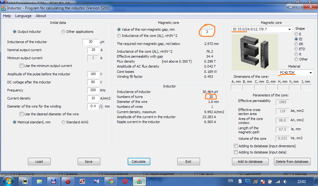

Here is an example for EI33 , 30uH , 20Amp - it means about 800W RMS power at ideal +-80V supply.

Hi Dimonis.
Very cool calculators, thank you so much for pointing out the link.
Always calculates one gap in madnetic flux.
And it's your decision to divide it to multiple according to core type.
Thank you.

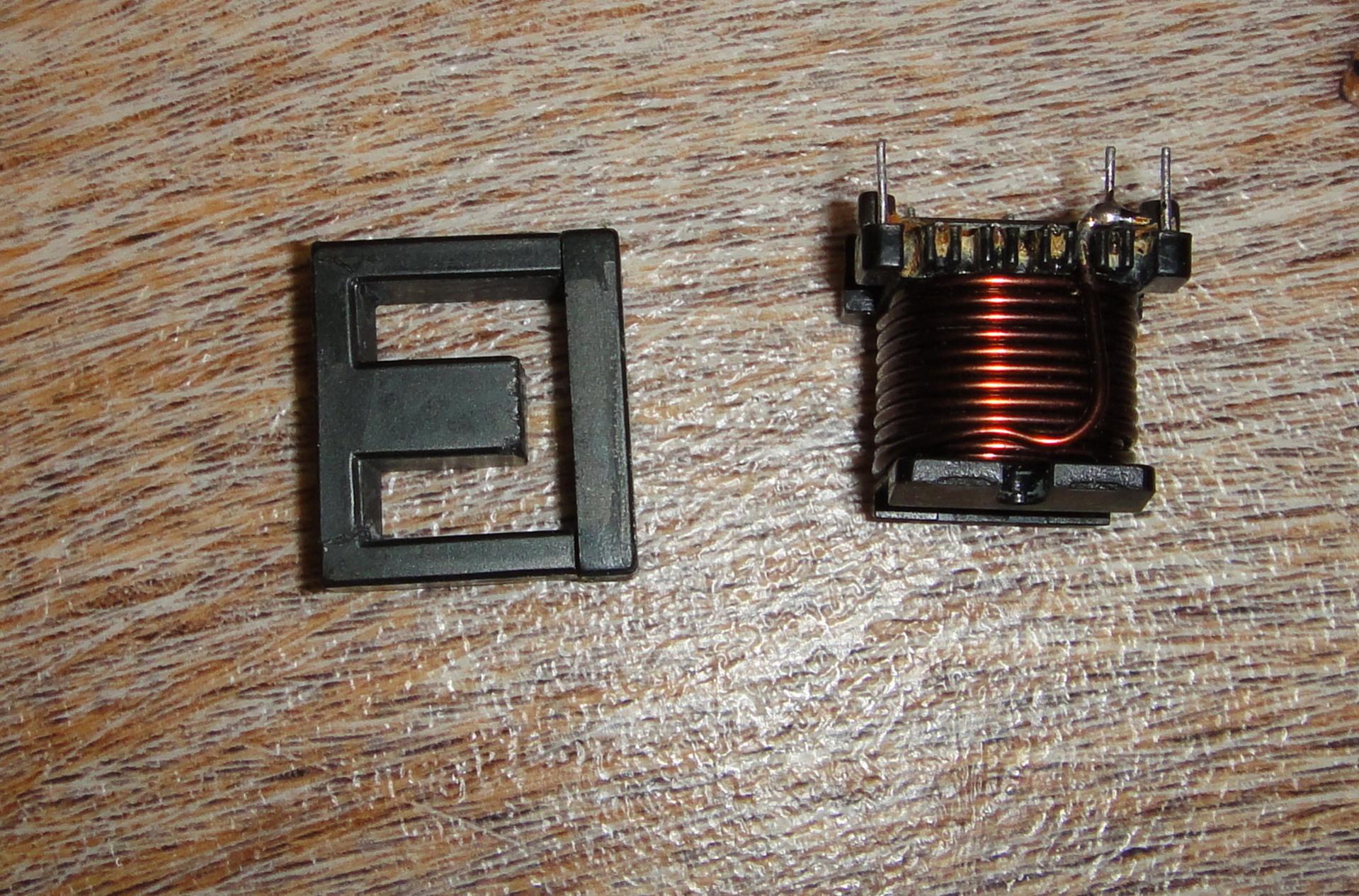

Did make EI-33 based on calculator but 20Trns already did give me too much µH with ONLY E-part onto bobbin.
Had to reduce windings to about 15Trns and then made a gap of about 1.75mm on ALL three legs to get somewhere near 30µH.
Will build the amplifier within soon and let you know the outcome :)

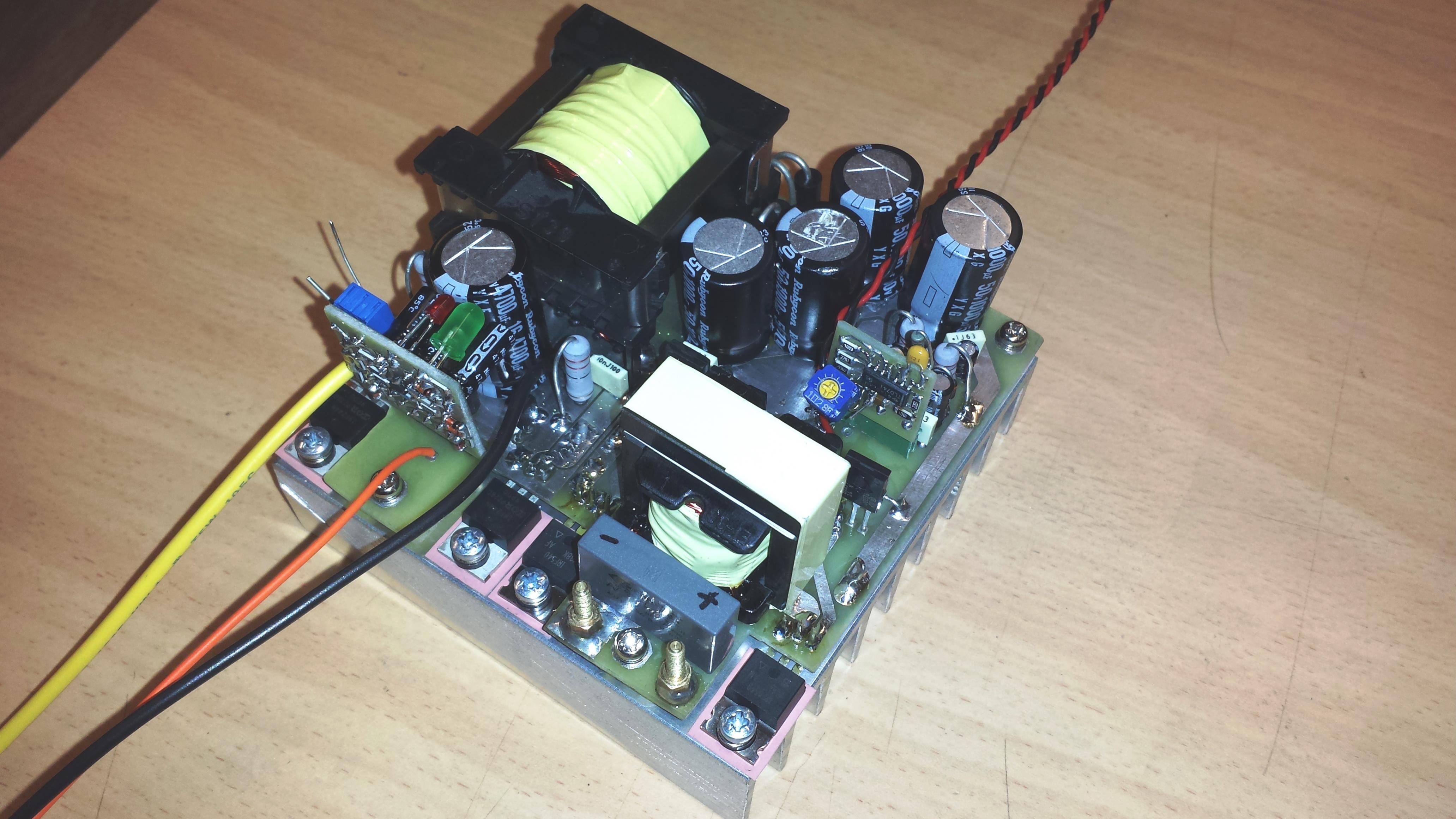

PS My inductor on EI33 , 50uH , gap ~4mm.

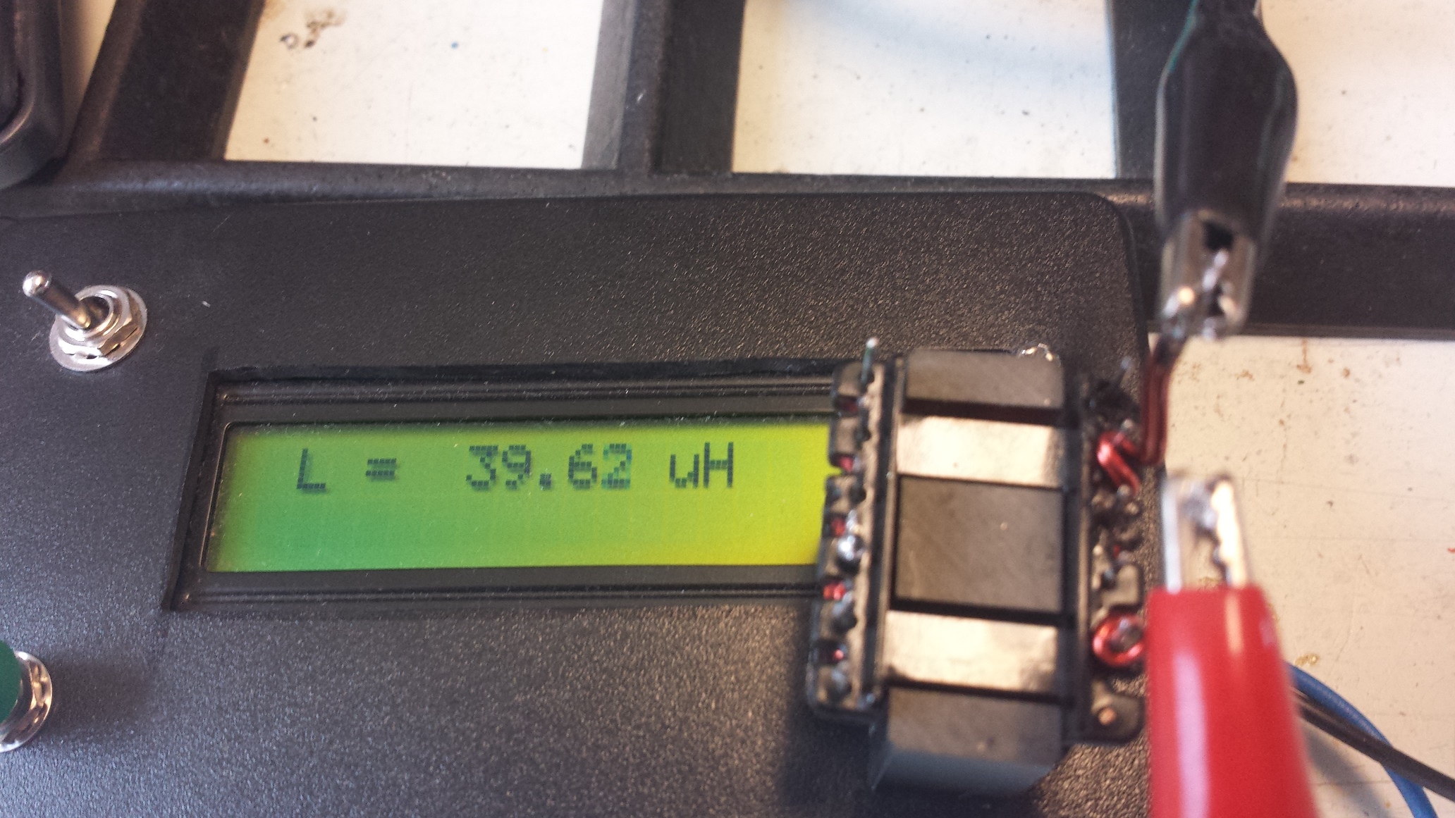

Just made a sample with 20Trn
No I piece of core of the EI core, gives me 34.56µH by equation method,
and gives me 39.62µH on DIY PIC LC meter.
No need to tell you that if I add the rest of the core, inductance will only increase :D

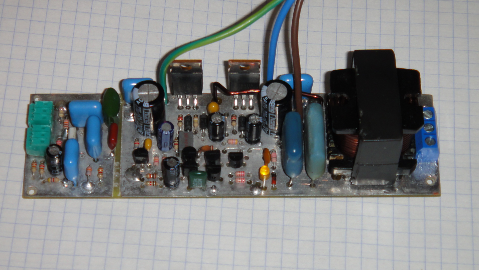

Finished amp with power supply
My first attempt at building an amplifier.
Some experience with power supplies, so build a
12Vdc to ±35V converter on the same board
to use as car amplifier.
Is it correct that the output is 180° phase shifted in regards
to input signal?

What core You use for output filter ?
is the co gap or gapless ?
Is the core get hot ?
Btw is a good looking amp I hope its perform well too
Output filter is TDK PC40 gapped (EI-33)
Core ain't getting hot, wire heats up a little so need to work
on that.
Only tested with sine-wave generator so far and 4Ohm load.
Need to get my hands on some suitable audio input and speaker
output :)
