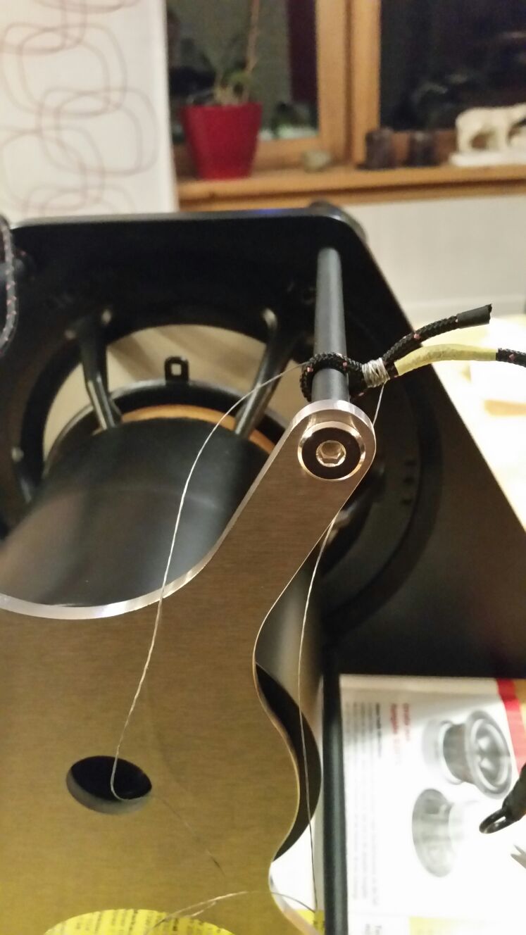

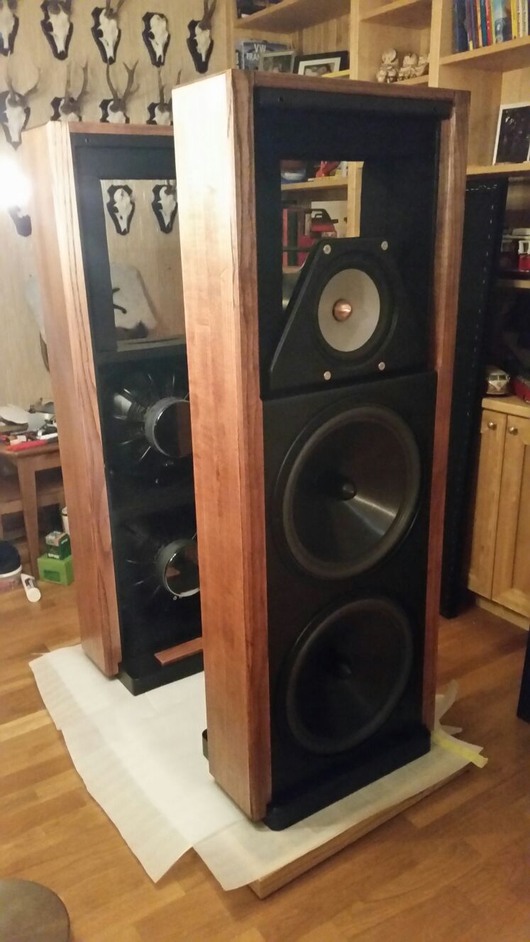

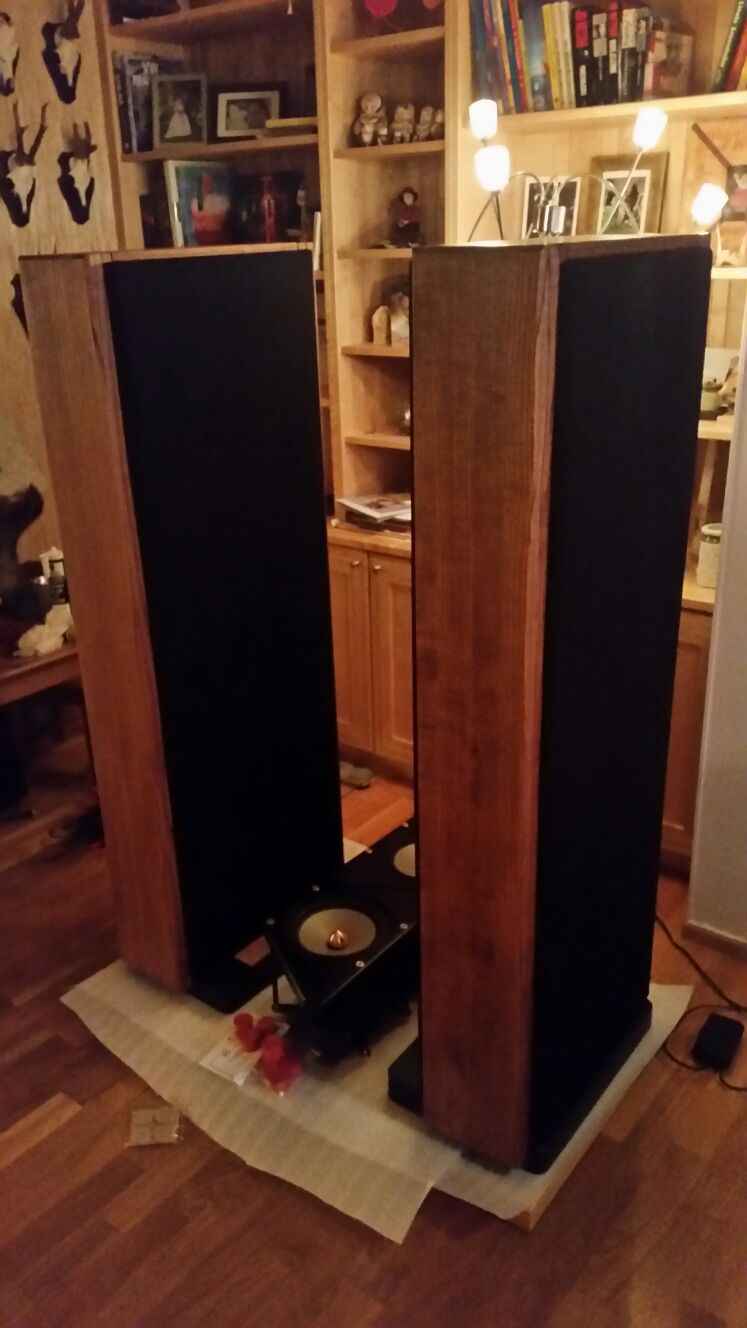

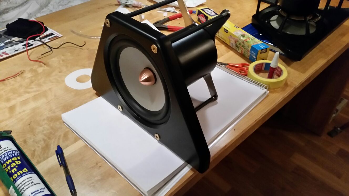

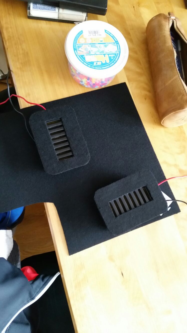

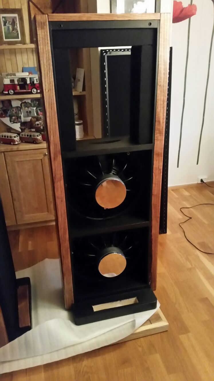

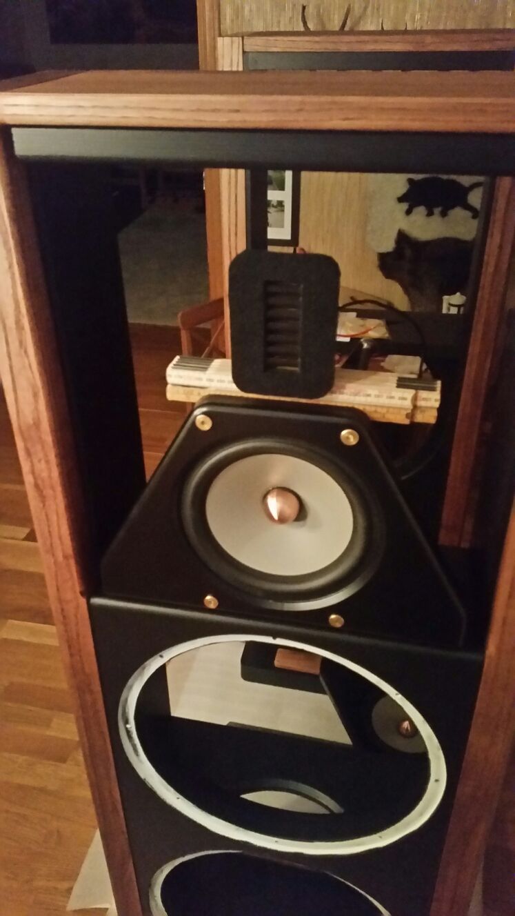

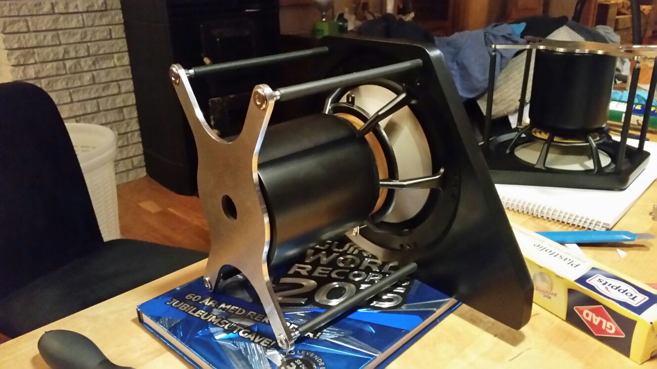

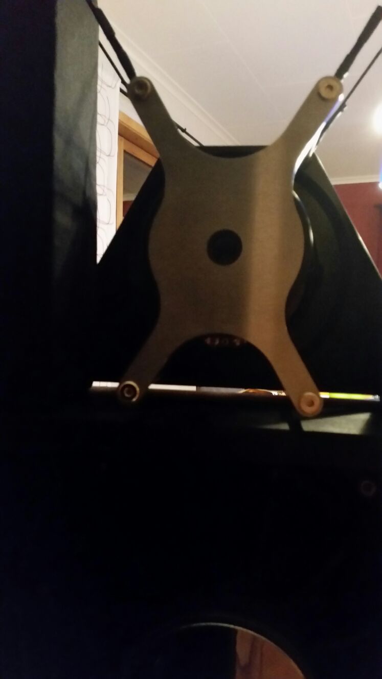

OB w/ AE15 W22EX and AMT
W22EX is clamped between x og baffle (ss steel & corian)
Tweeter is Mark & Daniel Dreams 4. Upper frame has damping pads lining.

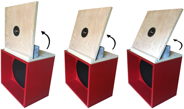

Hi Godzilla,
You could try also not to putt the driver in the midle of the bafle plan but asymetrical .
There are also so round plate for TV with teflon mecanism (allow also some vibration isolation f=from the bass cabinet ?) for allow you to steup with precision the horizontal orientation towards the listening position.
