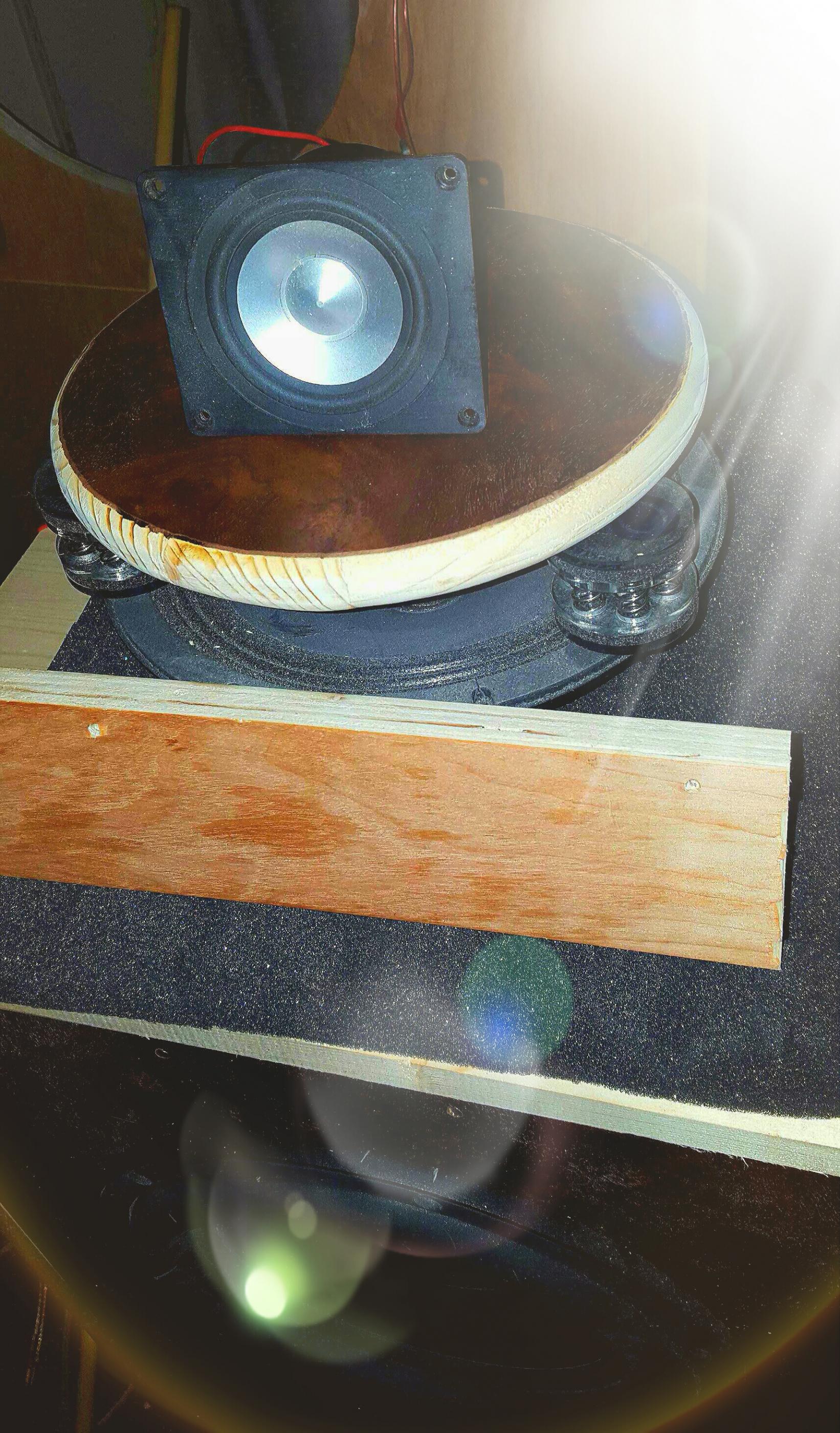

Hello all, sick at home today, and goofing around with Seas and EJ Jordan 8 and 2 inch drivers, actively crossed at 300, and 2500 hertz.
Absurdly good sound, especially counting the 5 minute "build"!
I will be pursuing this upfiring against a reflector idea further.
What is the model# on the little Jordan?
dave
These are JXR6 HD foil drivers.
