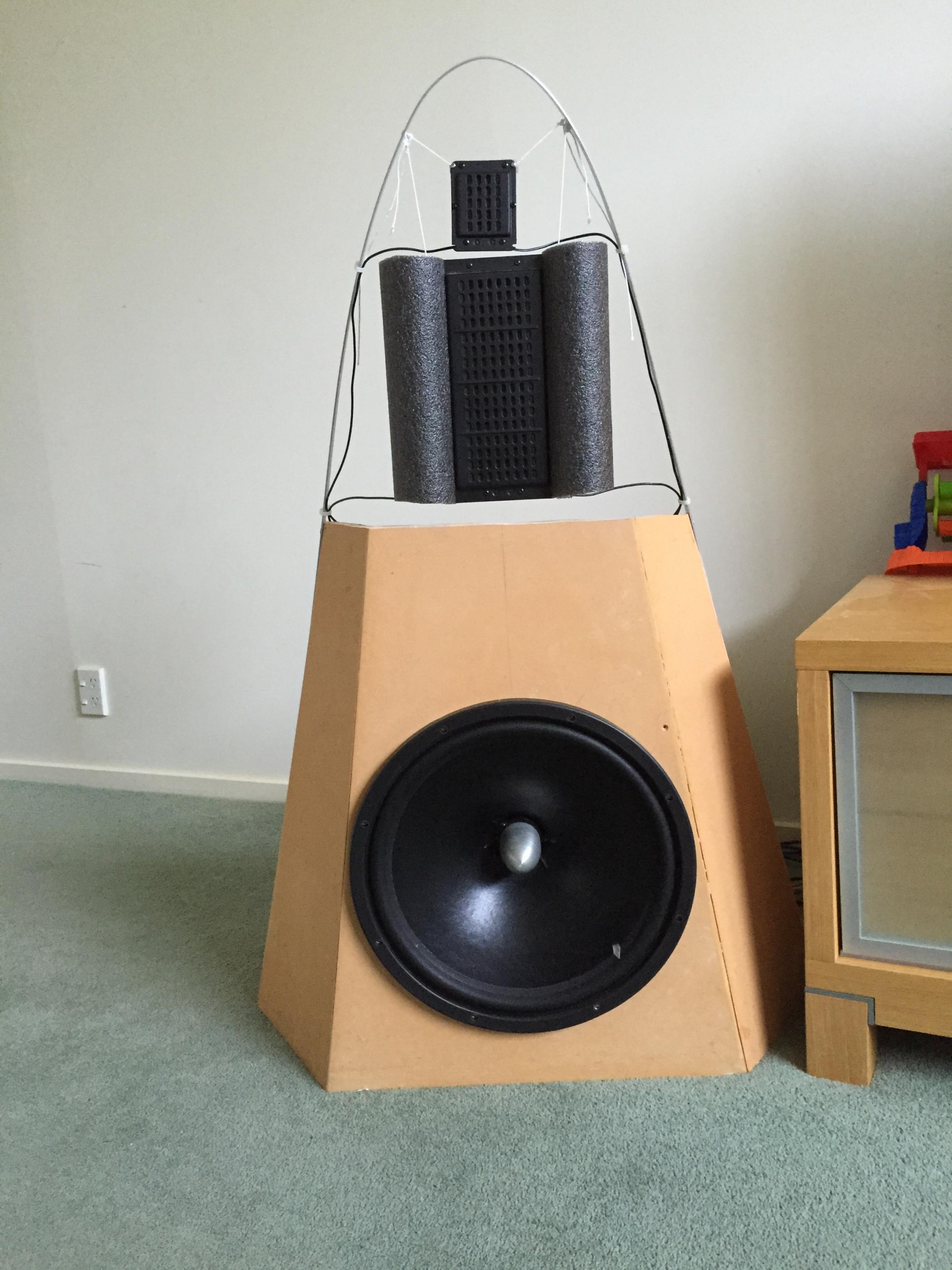

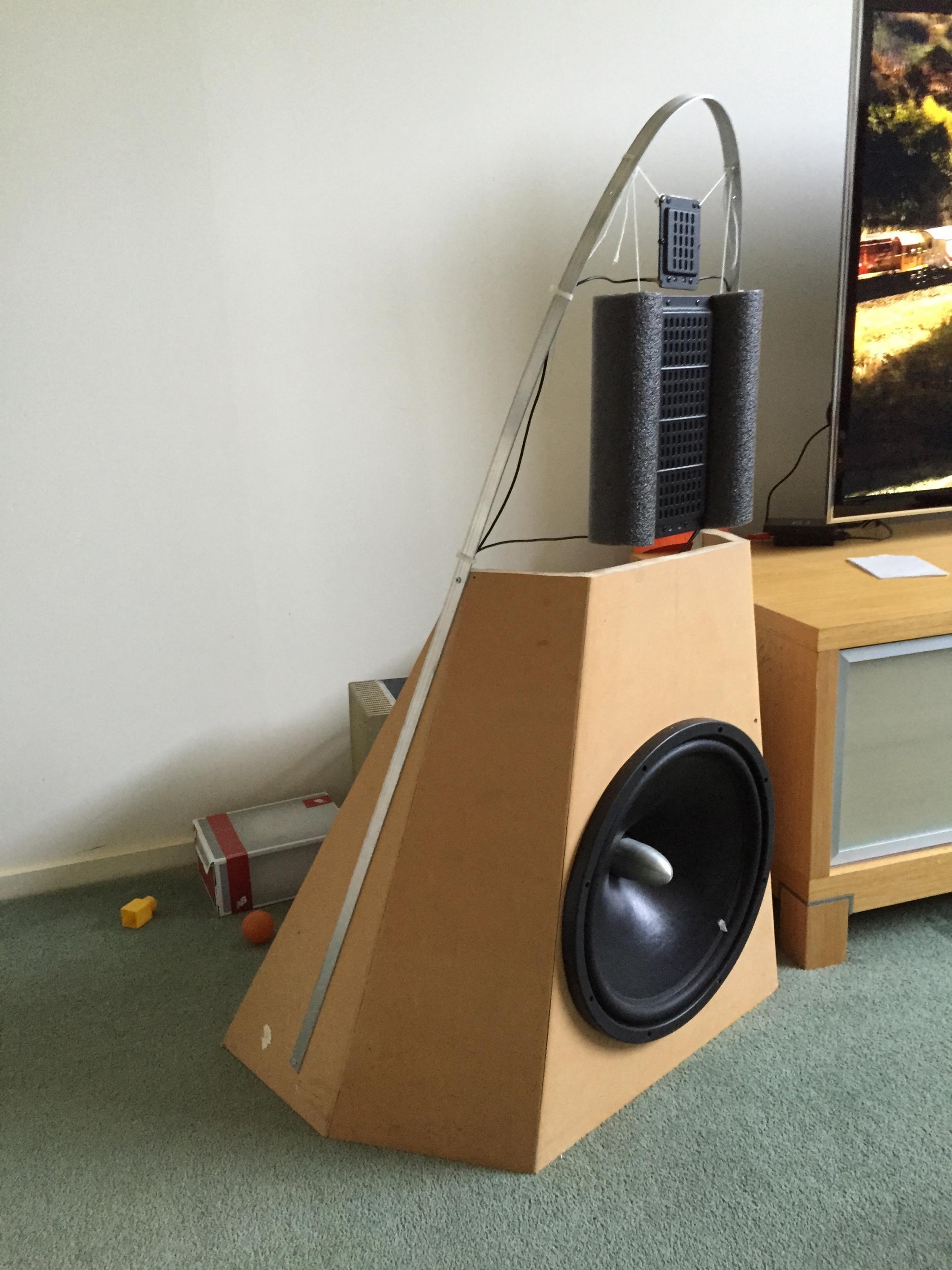

My 5th Generation Prototype
These are my 5th generation prototype OB/Suspended speakers and they are by far the best version yet. The air, detail and realism is pretty darn good and far better that anything I have heard yet (that is not saying much though ).
The drivers are Neo3 (open back), Neo10 and AE dipole 15's.
They are passively crossed at 3kHz and 300Hz and driven by a 60W class A balanced amp of my own design.
Future upgrades include:
A toroid style H enclosue for the dipole 15 which should extend the bass to 32Hz without equalisation.
Seperate amplifier for the dipole 15 with an active crossover and possibly equalisation to extend the bass further.
And maybe in the distant future I will replace the neo3 with a AMT tweeter.
Cheers
Tim
Cheers
Tim
