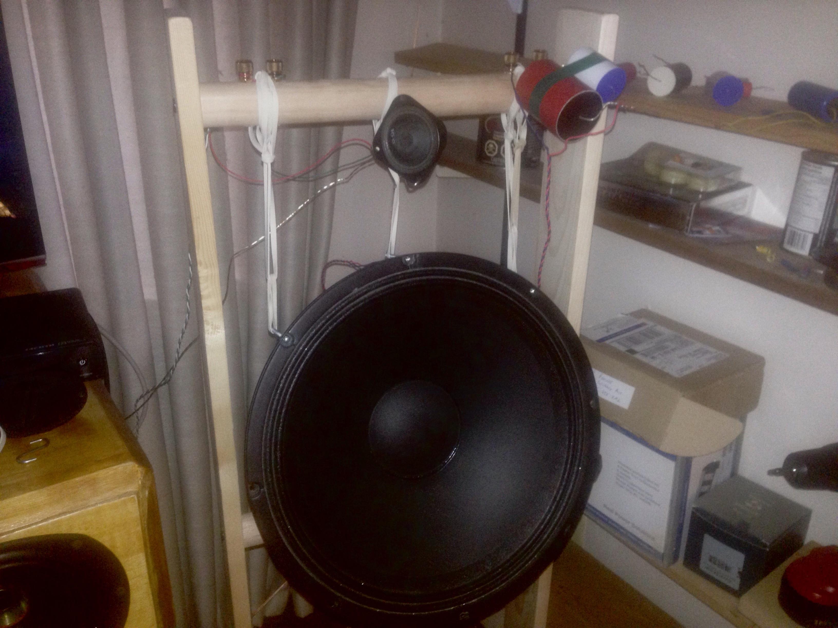

My own weird stuff is suspended Trace Elliot by Celestion 15" woofers under a variety of suspended tweeters,( pretty sure I've settled on vintage Peerless 16 ohm alnicos) satellited with a sloped h frame, housing a 18" subwoofer.
Just received a SPA1000 plate amp to drive this with.
It's one fine amp!
Basslines are tight, textured, and get out of the mids domain very well.
After several ob combos, I'm finally understanding why so many don't return to monopole bass- monopole sounds unnatural and a little clumsy now.
My aging Polk is a theatre only player, now.
Speaking of ugly speakers-
These aren't very good looking, but now that I've settled on drivers, and type (no baffle, hangers), I'm hopeful some nice red oak, and some more creative shaping, will make this a looker, instead of a head turner (away).
Yes, those are caps, pinched in the binding posts.
Turns out a 4th order active filter is good between woofer and tweeter, but a first order slope sounds best between woofer and subwoofer.
Since my active x-over can't vary slopes, this is my option.
I did try a passive line level series cap; it sounded fine, but had a ton of insertion loss.

Not ugly at all to my eyes.
For 100Hz or so and above, nude driver is OK (or even preferable), but under that, you'd better have some support. In fact, as much as you can.
Have tried naked 18", and it's easily bottomed. Or you have to HP it at 35 or 40 Hz to save the woofer (and distortion).
Another side effect of naked woofer is when playing quietly, it looses the presence. No, I don't think it's the loudness stuff, the proportion of bass sound drops more than that. So it's not good at loud and quiet, can only operate in a narrow SPL range.
