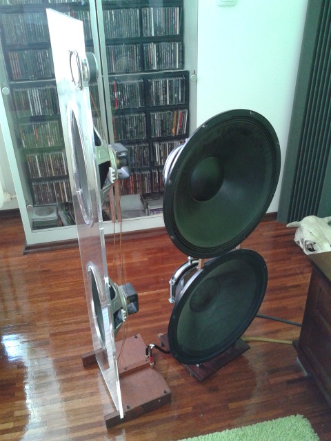

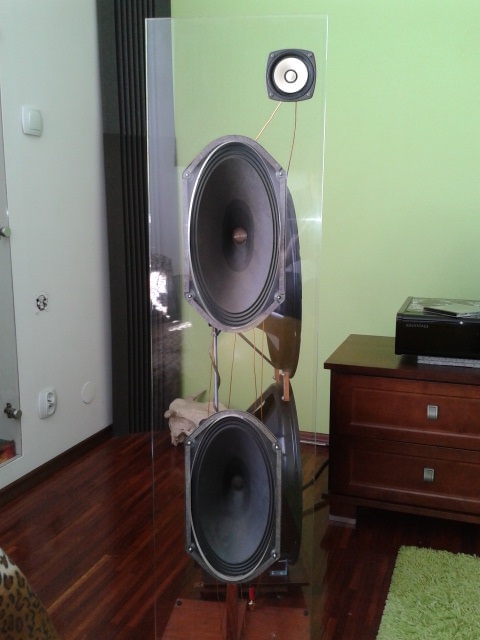

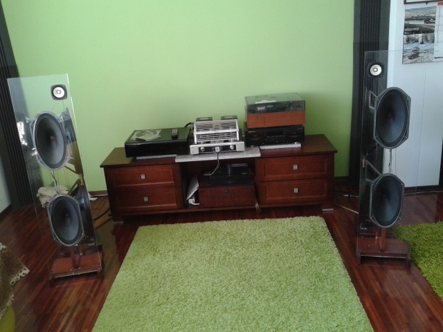

how do the no baffle basses sound?
what make?
where do you cut?
parallel? serie?
looks nice!!
- very clean and without pressurizing the room, I have been using these woofers for different OBs for 6 years and I am very satisfied with them
- Alphard HW 1800 - woofers popular in Poland for OB use
- active cut @ ~80-90 Hz
- woofers parallel, Isophons also
- thanks!

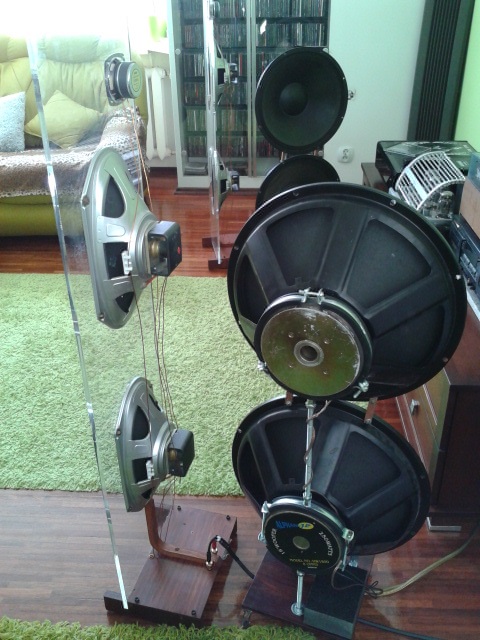

If you cross active and the 18" woofers has Qts above 1 you really don't need an additional baffle, except the woofers itself, for home use. Usually 60 cm is said to be enough for OB, here I have 46 cm - and it is enough.
For most 'normal' music, yes I believe it'd be 'enough' for moderate level. But in my experiences, baffleless dipole bass would be insufficient for both quite and loud playback.
For loud, its obvious the limitation is in the excursion. I once bottomed out the woofer (also 18", with 6mm Xmax / 18mm Xlimit) in a movie. Not very loud actually, it's very low, thus huge stroke. At that time I used 3 channels with one 18" per ch. Now you have 2 stacked per side, maybe it's in a better situation than my case.
For playing quiet, it would be some kind of non-linear fast roll-off. It drops below the loudness thing. I encounter similar effect in the lower part of my baffle-less mid, too.
FYR :)
Your bass modules "hide" very well behind the acrylic baffles. How much is their unusual orientation (perpendicular to the other baffle) the result of aesthetical considerations and how much the best acoustical position?
It is both: aesthetics and acoustics. After hearing Gradient's open baffles I decided to try this position, which turned out to "work" in Finnish speakers. Before I believed such orientation will result in no bass in the seating place. However due to room acoustics and wave reflections from walls and cupboard it really works. However I spent a while on choosing their best position and angle...
