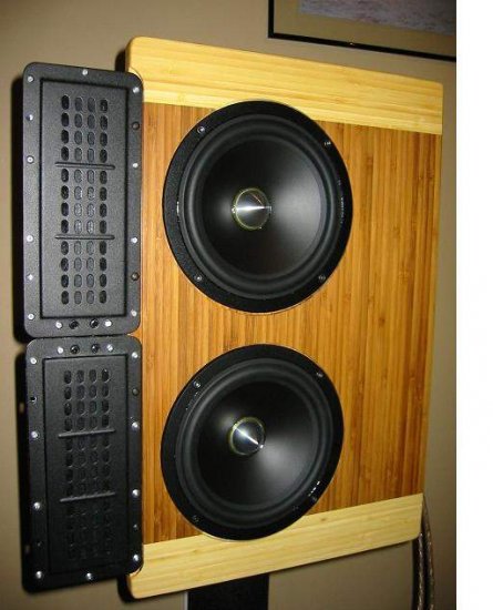

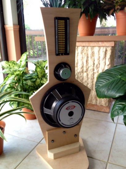

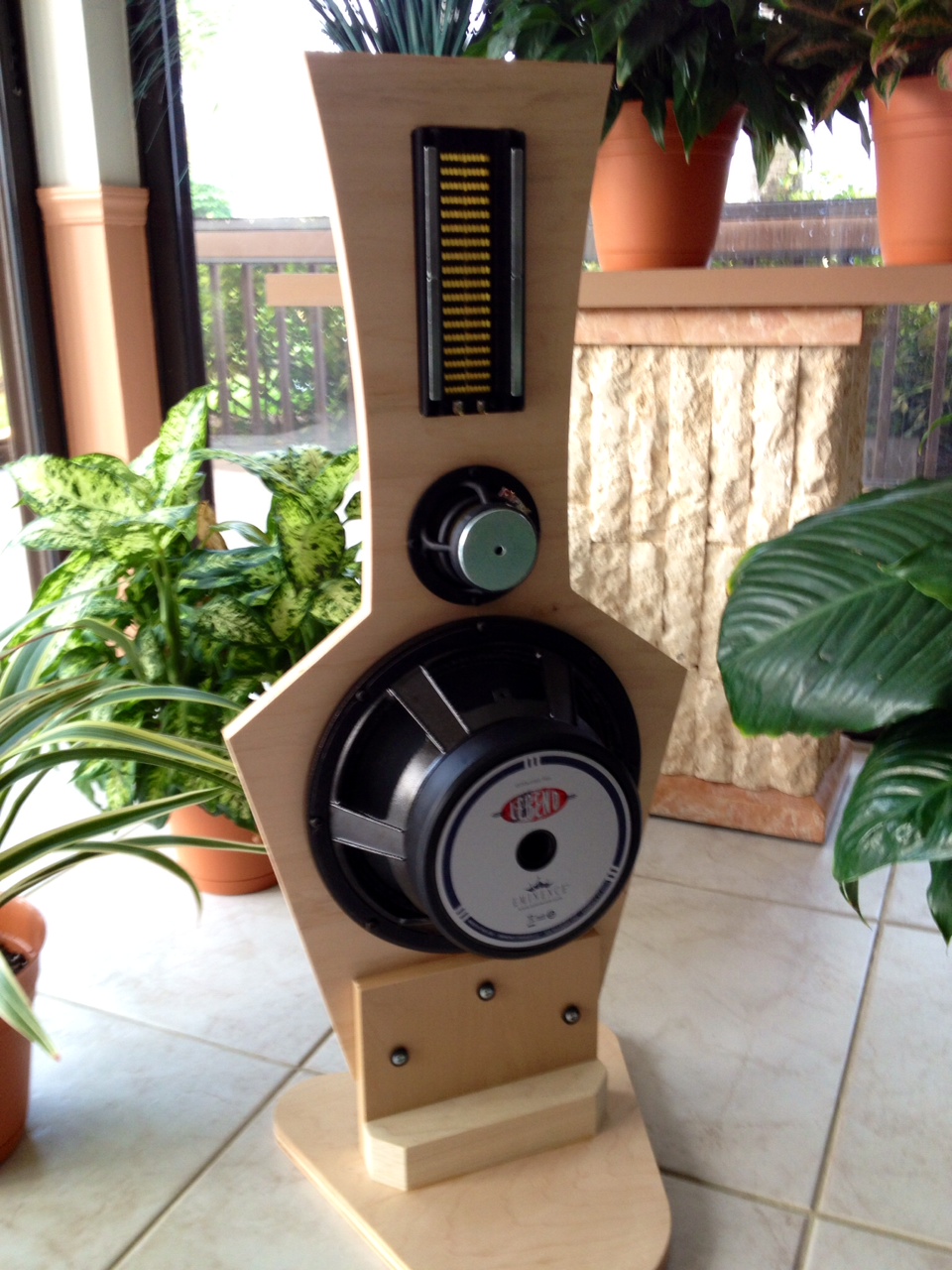

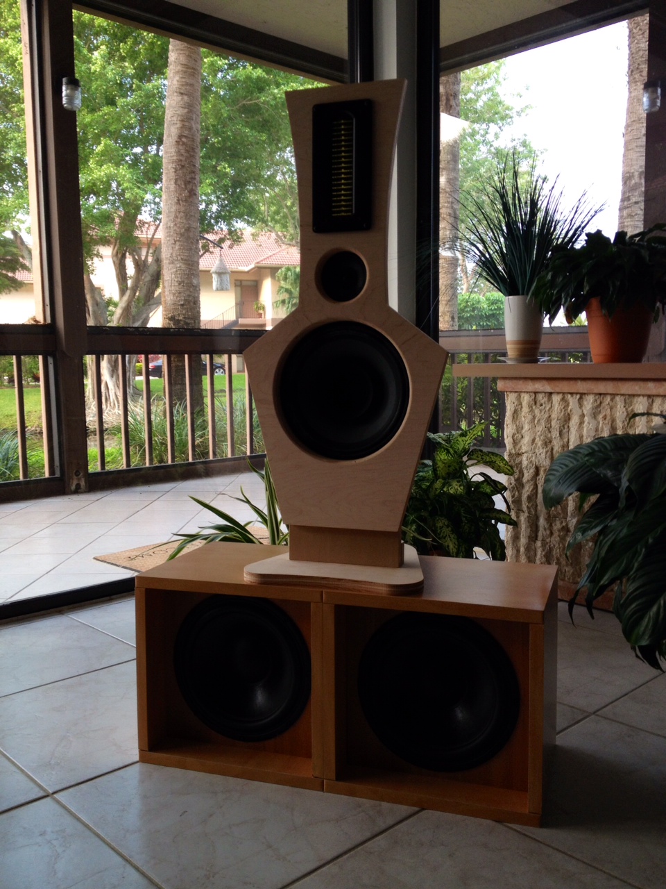

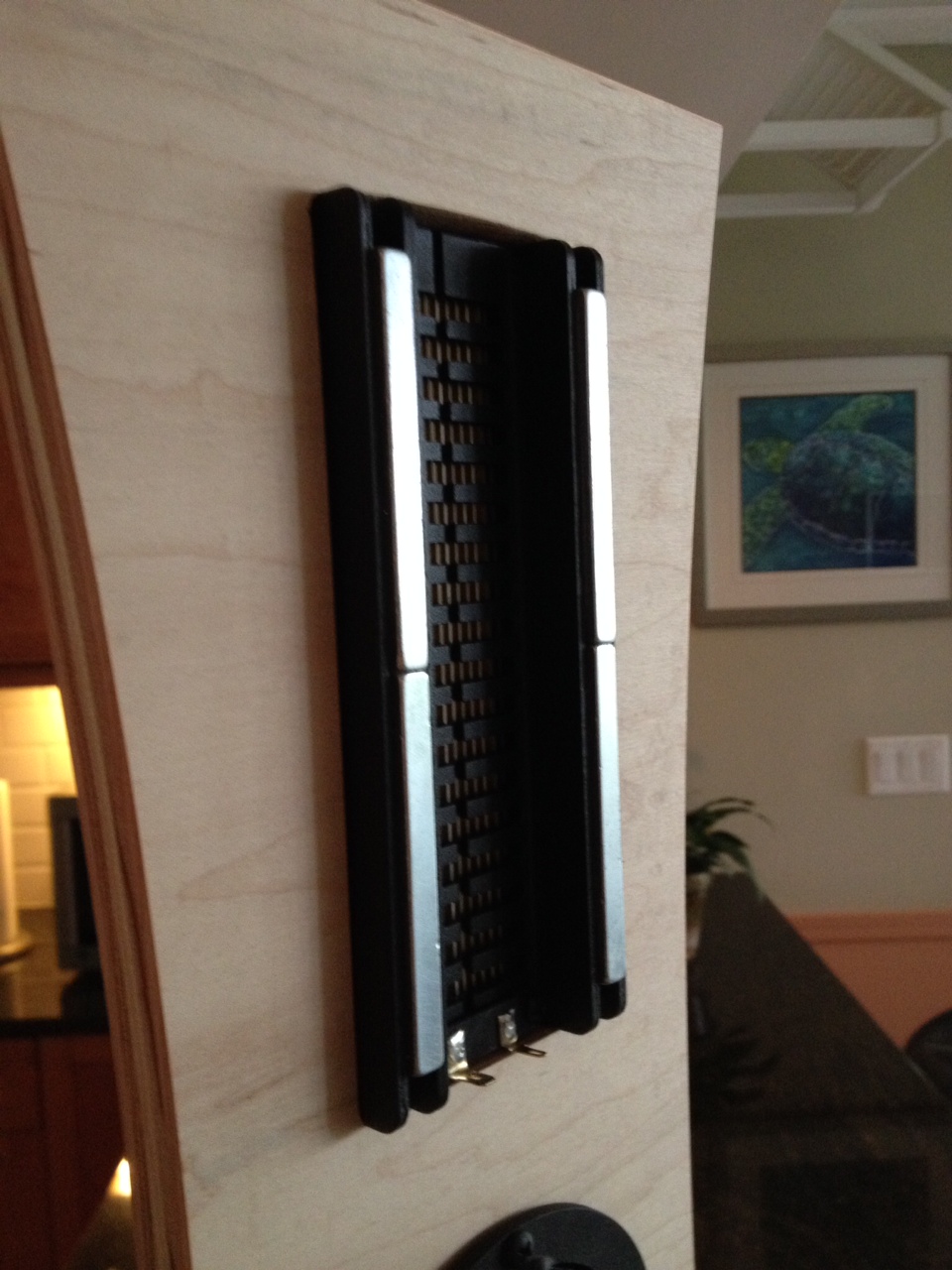

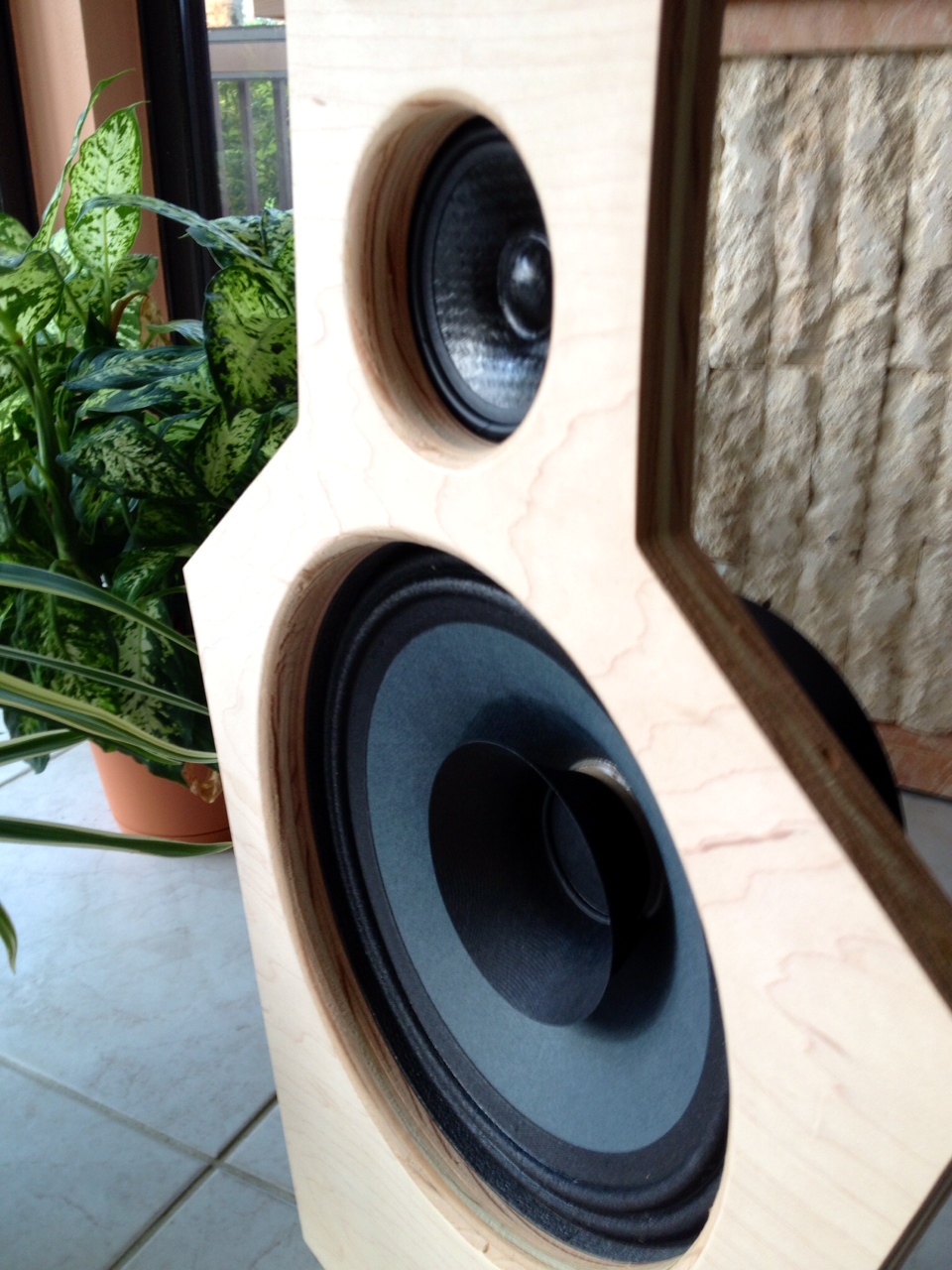

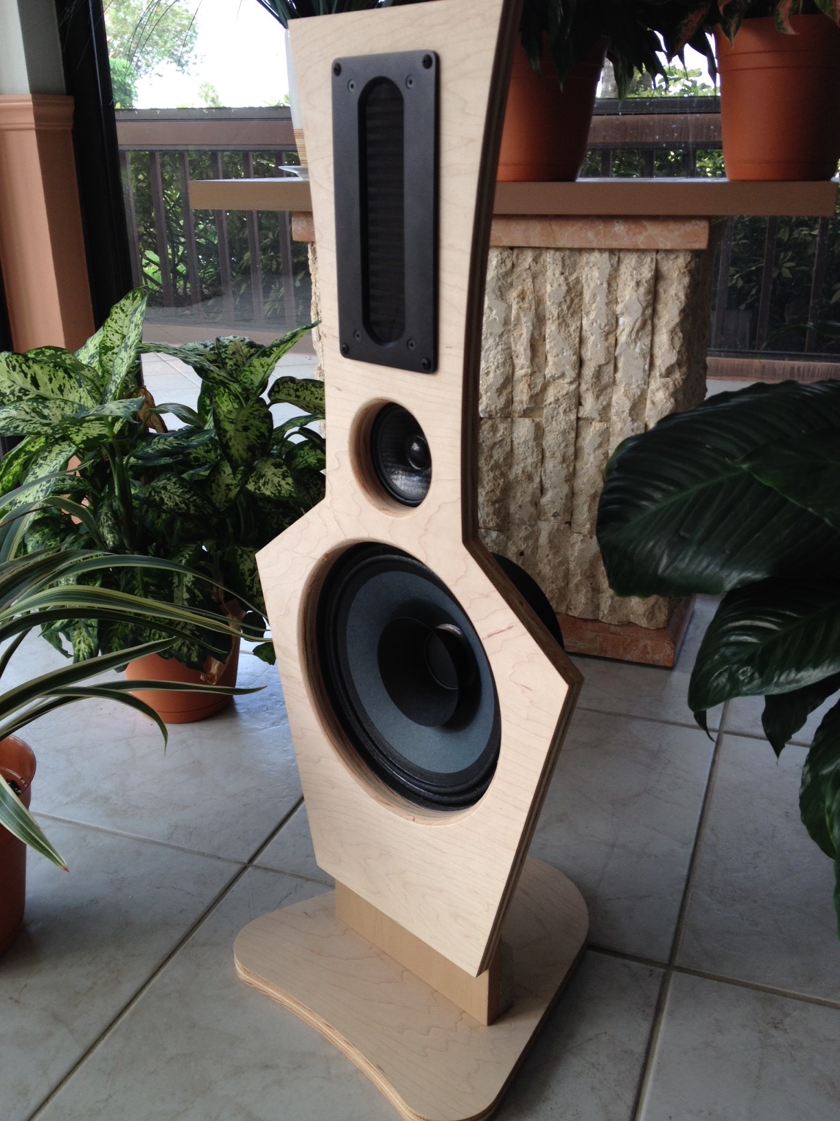

The Hestia V
My "Hestia-V" DIY project with baffle shape inspired by LX521
Eminence B102
Seas FU10
Dayton AMT Pro
All passive crossover

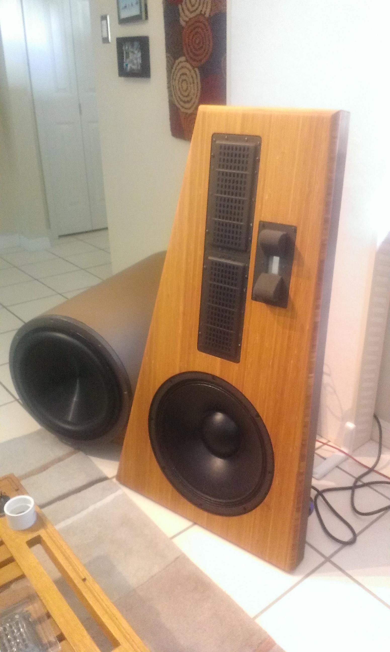

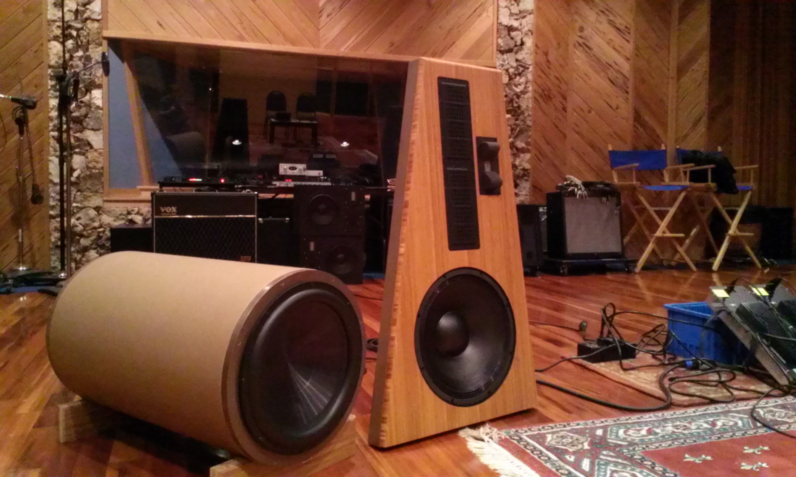

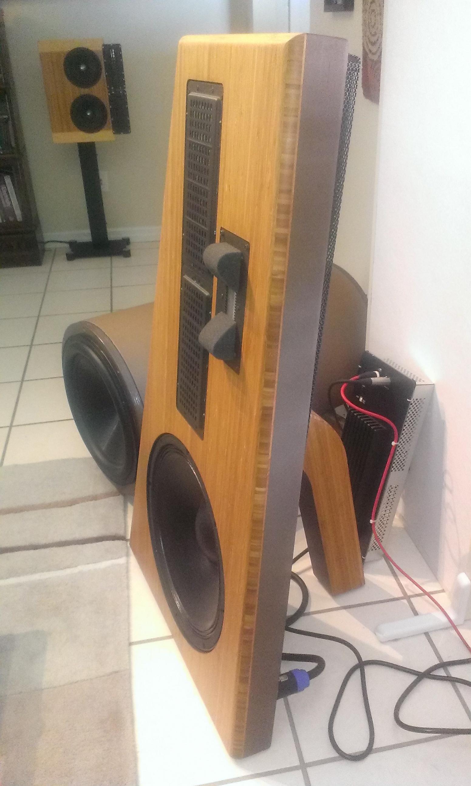

I was just looking back through this thread for inspiration and realized I never posted completed pictures here. Job well done and thanks to everyone for posting their projects.
