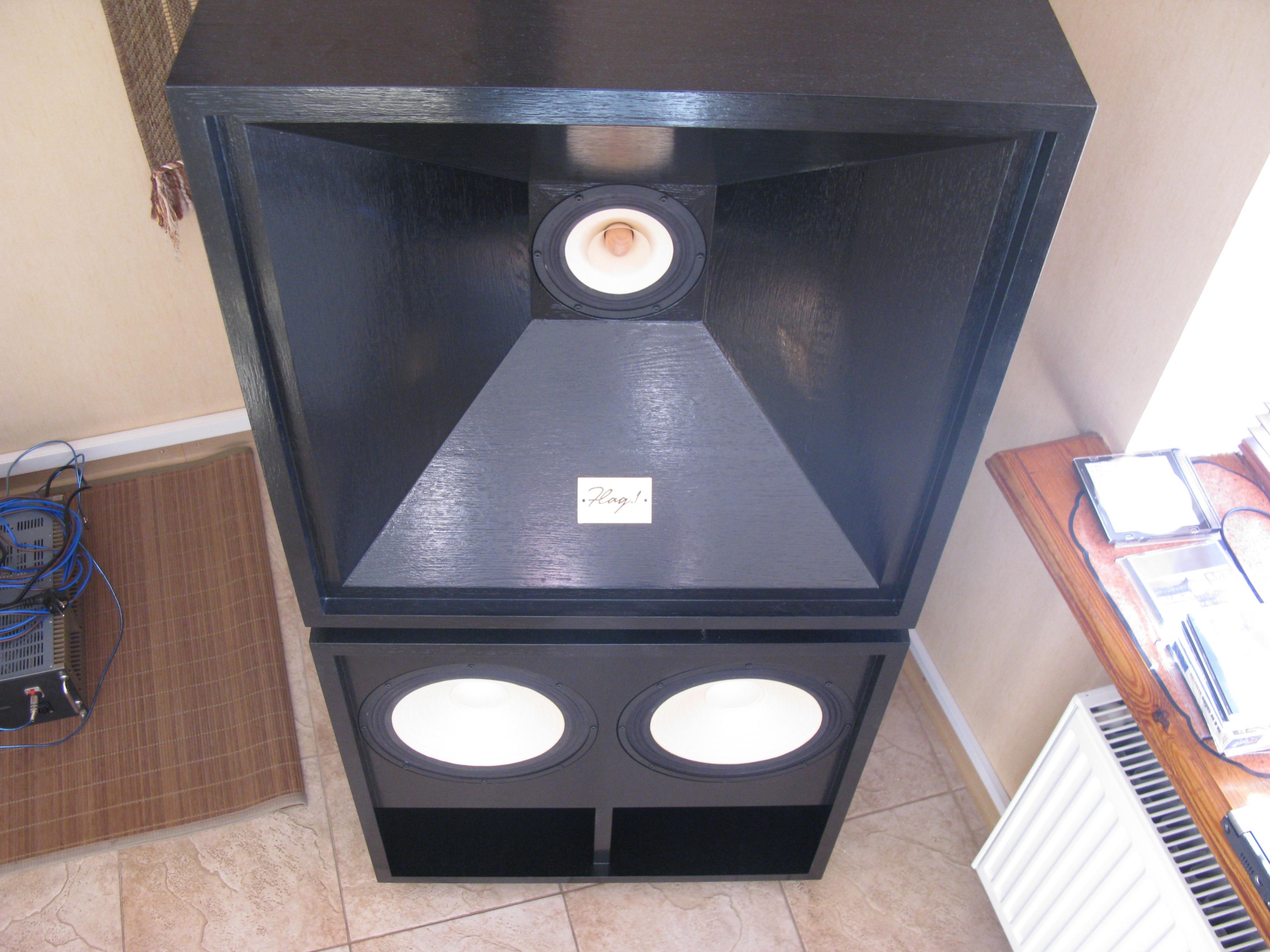

I would drop the crossover to sub 150hz and biamp. I have never heard of Sonido but I assume the woofers are 16" (400mm) and the mid is 8" (200mm) so yes the speaker is as tall as me (1.75m)! Yikes!
But they are so beautiful I assume the WAF is pretty high too.;)
I think is going to end up this way - biamp.
Will try 150-100Hz with 1st order.
Need to change fostex for something better.

I have to make a baffle large due to low QTS of woofers ~0.3 also there is a bitumen matt between front baffles to low resonance.
Crossed at 175hz. Still not enough!!!!
Very nice looking design, should be good dynamics and big mage scale..
What makes me doubt: - possibility of integration of this tweeter with FRm both with horns
- and horn and 200SFR probaly works not so low like you cross it over mating with 400scw...
