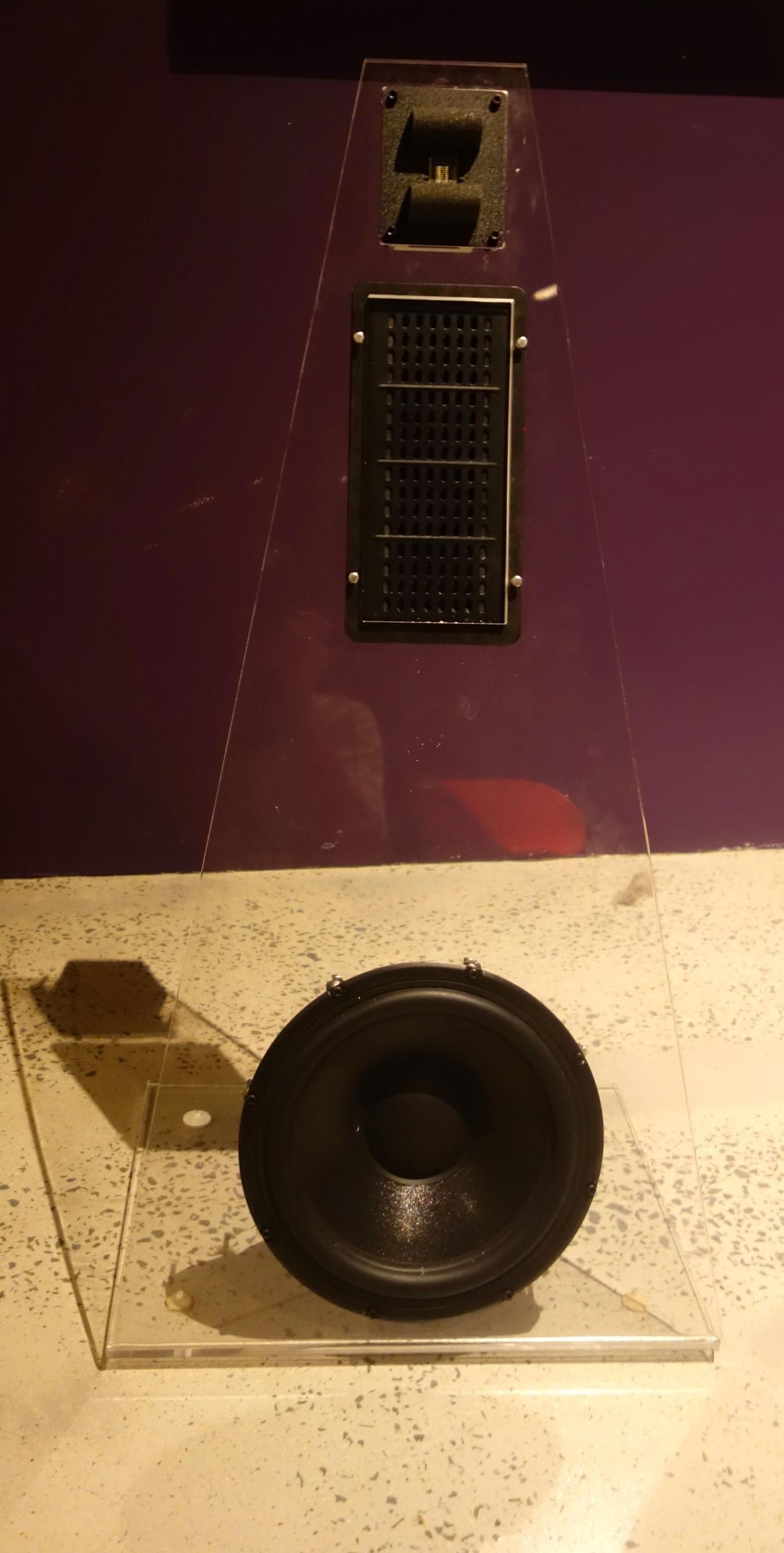

My latest effort. A three way narrow baffle OB using a simple folded acrylic baffle.

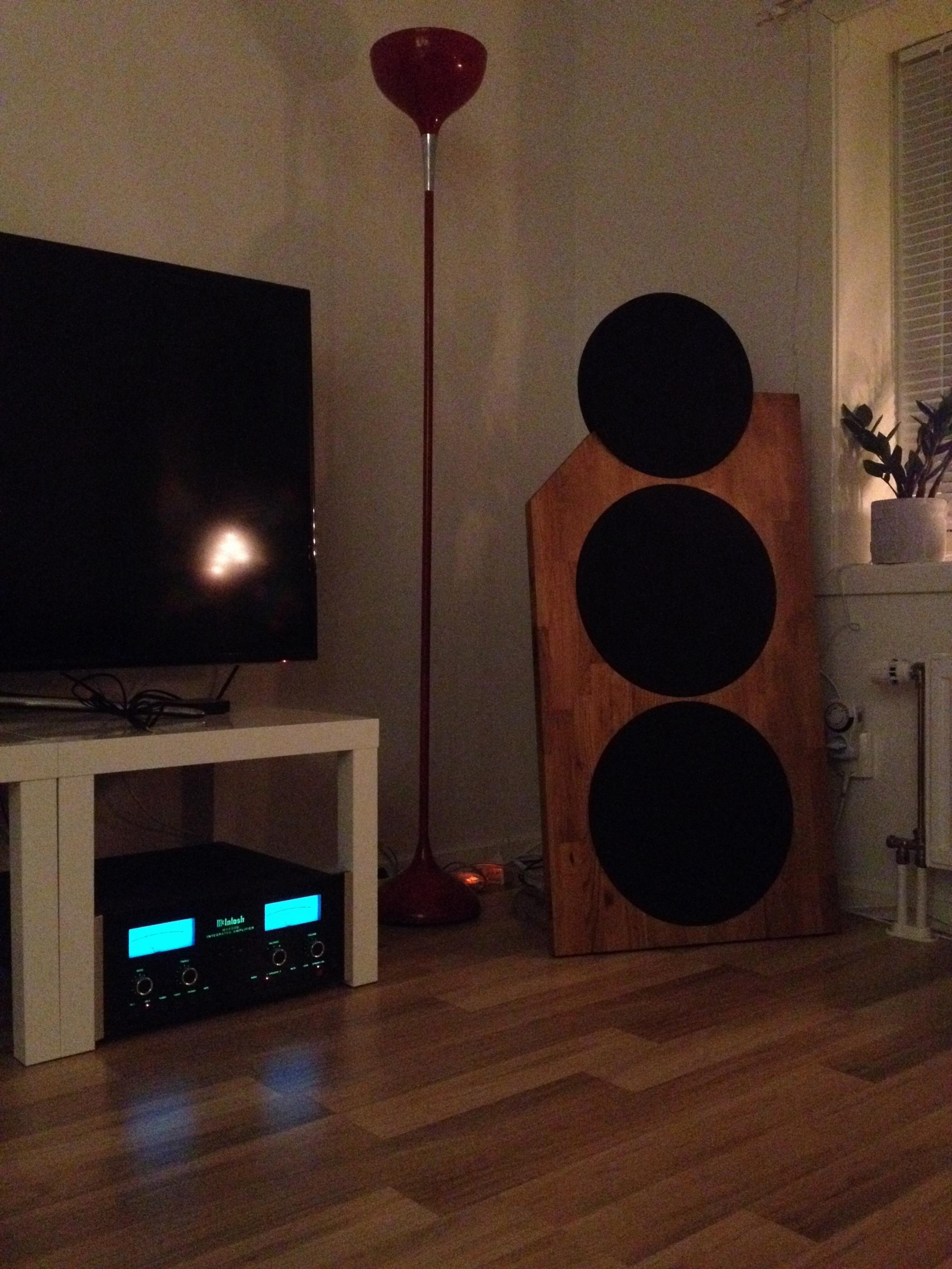

Two Sonido SCW400, SFR200a, Fostex ft17h plus attenuator. Still working on crossover.
I have to make a baffle large due to low QTS of woofers ~0.3 ..Crossed at 175hz. Still not enough!!!!
Well! This is what I'm working on at the moment. I think coils don't do good for Sonido.
I would drop the crossover to sub 150hz and biamp. I have never heard of Sonido but I assume the woofers are 16" (400mm) and the mid is 8" (200mm) so yes the speaker is as tall as me (1.75m)! Yikes!
But they are so beautiful I assume the WAF is pretty high too.;)
