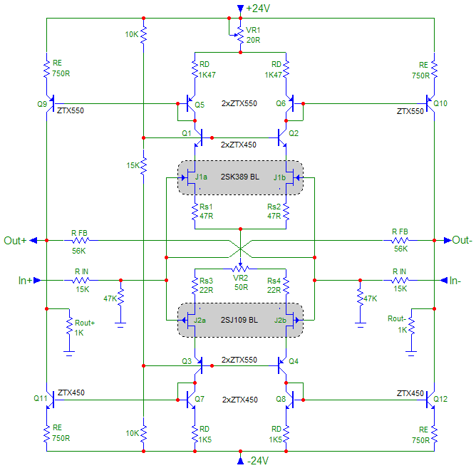

Probably but I won't do it :). I let you redesign an UGS3 or 4 with the matched j74/k170.
:) I could do that. I have the sch. and pcb design. The latest version to my knowledge is the UGS V3a - see attached schematic.
Would 1206 (3216 metric) resistors work for everyone ? The reason I ask is that Panasonic Era resistors measure among the best and is a really good choice.
