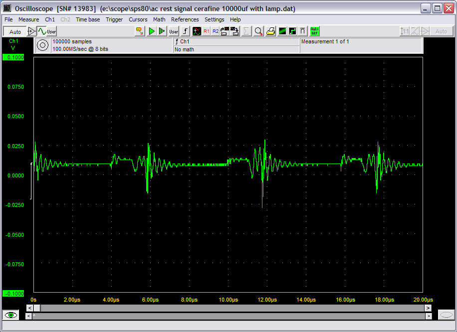

Attached is a scope picture of the AC component of the + rail voltage measured at the cerafines (about 10cm away from the SMPS) and loaded with the lightbulb (60W 100V bulb fed with about 120V, connected between + and - rail).
Some ringing can be seen. HF residues are not very large, the scale is 25mV/div, reducing the ringing by adding a snubber maybe nice. The ringing is also there when the cerafines are not used, so I think it originates in the SMPS itself.
Best regards
Gertjan

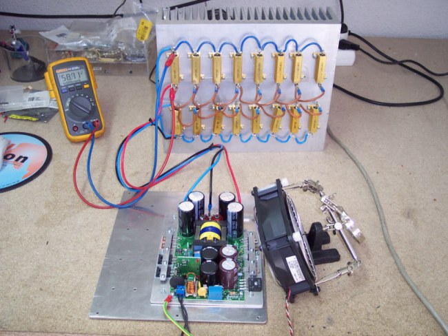

The thing is that the SPS80 PSU is extremely efficient.
Just an example: if you connect 2 or even 4 typical class-D modules they will get much warmer than the supply even with no signal. In fact the supply remains cold.
Pushing two of our BP4078 400W channels hard with a single SPS80, all screwed to a very small alluminium case, we have never seen a temperature rise of, say, 15ºC above ambient in the supply.
The fan output is more for the amplifiers than for the supply itself, and it is rarely used.
Obviously, when we did our 1KW test, we screwed the supply to a small plate and used a low speed CPU fan to blow some air at the top of the supply, mainly to cool the inrush limiter and transformer a bit. See attached photo: it was delivering around 990W. After some minutes you couldn't touch the loads heatsink, but the PSU plate was 20-25ºC above ambient :)
