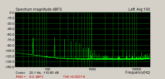

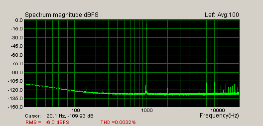

Hmm, do not agree with that Pierre.
With amps of higher power level the current spikes in the mains cord are huge and radiate a lot of noise in the range of 100 Hz to over 1 kHz. These can be picked up by signal cables. I have checked that with a spectrum analyser.
If you want to lower that with a classic PSU with a 50/60 Hz transformer you need a filter with huge chokes and capacitors and that is bulky and expensive.
A SMPSU requires a DC input and it is this that makes an active PFC possible. IMO the main advantage of PFC is that the charging of the input storage capacitor can be made sinusoidal with much lower charging pulses. That such a PFC makes it possible to have an universal input between 100V – 240V is more a commercial advantage.
Attached a pic what you get on de signal cables when they are 20 cm apart from a regular mains cord from an amp that is driven to about 100W.
Cheers
