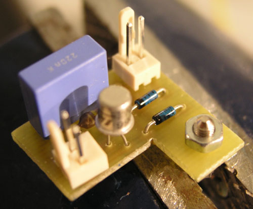

You can put the /ON always on the GND line, but you can have some noises when you switch the amp off. Because the capacitors are discharging quit slow so you don't have a fast/sharp moment when the amps switch off. Please use the circuit in the attachment, every small NPN transistor will work. AC1 and AC2 are the secondairy voltages.
Jan-Peter
Your mute circuit.
No yet tested.

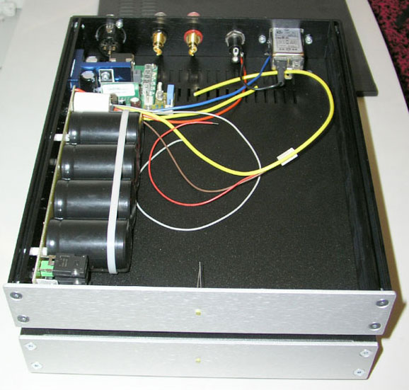

Stef1777,
Looks ok!
But why do you use the Schaffner netfilter?
In the most netfilters are mounted Y-capacitors (from live and neutral to ground) this can affected your sound because of earthcurrent. Bruno wrote in this topic that he never advise to use netfilters, becuase this degreed the sonic performance of your hifi setup.
Thereby with the UcD180 you don't need them for EMI suppression.
Jan-Peter
Looks ok!
Jan-Peter

Jan-Peter said:
Indeed you are completly right, there is already a pull up resistor in the UcD180/400. So you can forget the +15V line by the transistor. A simple open collector output is already sufficient. There are all protection diodes inside the UcD180/400 so a higher voltage (max. 50VDC) is also no problem.
Jan-Peter
I tried the circuit alone (not connected to the UcD). I tried with an 2 x 25V transformer.
When the power goes on, the GND is well switched but I have 42 Ohms. I used an 2N2222 from my stock.
Is this normal?
Jan-Peter said:Stef,
Where do you have 42 ohm? From Collector to ground?
Yes.
I can may be try to adjust the resistor to have a lower impedance. I'll try when I will have received my slime line toroid transformers.
