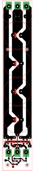

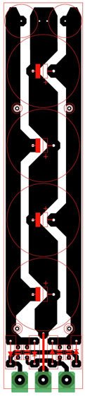

All this stuff can be added directly in the power supply circuit?
See the inclosed pcb.
Jan-Peter said:Steff,
The standby part is OK! But I should make a real star point where you connect all GND. Bottom is GND transformer input and top is GND to the amplifier.
Jan-Peter
Hi Jan-Peter,
No sure to understand. You say that the standby circuit is not connected to the right GND !
Can you be more detailed?
(the pcb is not yet done)
Stef,
The point where the lines from the both capacitors are connected with the center point of the transformer must be a star point. On this centerpoint the voltage is 0V with no 100Hz voltage.
The current of the AC-detection is very small, so you can connect where you like.
Check this link: www.hypex.nl/pcb.pdf
Jan-Peter

If I well understand, the GND of "standby circuit" should be connected to the ground at the output of the PSU (as a star !).
May be the best is to have the standby circuit on another pcb.
Curently, the psu project is like this. It will fit inside a 1U cabinet. Have a looks on the pictures.
185 x 38 mm
