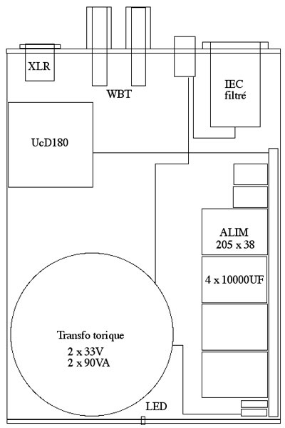

And the cabinet.

I should check my current cost. But, it should be around 20€ for 2 pcb.

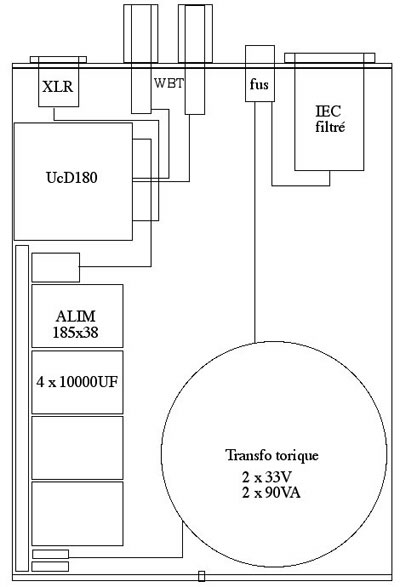

The basic problem to add the standby circuit is the size of the pcb. If I stay with the pcb on the left of the cabinet (just close to the UcD180), I only have 185x38mm usable.
If I switch the pcb on the right side, I can use a 210 pcb long. The problem after is the wiring. No nice, I should cross the cables. Cables will be longer too.
