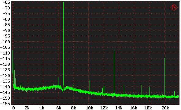

The link Furious posted above is for a “Pure” Digital amplifier; the results are limited by the modulator (Ti TAS5015).
Below is a FFT of my MK1 Analogue Board, 120W 8Ohms, and 6.67KHz, THD 0.000426%. The “High” noise floor is limited by the analogue generator of the R&S UPD05 – and notice the dB scaling.
Since running the tests, I’ve given up on both the UPD & AP IIC+ and am designing a “simpler” piece of test equipment to perform FFT, IMD & THD (+N) on switching amplifiers via USB – without the limitations, I’m encountering with both my current units.
I would like to stress that simple measurements such as THD do not necessarily tell us much about the sound quality; I’m looking forward to listening to UCD.
