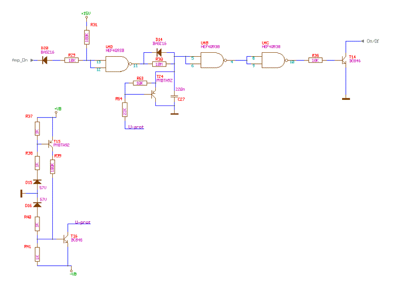

Hello,
I promised a schematic for an overvoltage protection. Please look to attachment. This design is only for DIY, not for manufactures. Copyrights are by Hypex Electronics BV.
Jan-Peter
www.hypex.nl

Thanks for the overvoltage schemtic Jan. It's nice and simple.
You know I was thinking last night about the blue this and the anodized that.. I'm sure it looks good, and I'm sure the cost of which is past on to the consumer. I'm all for the highest of quality, but i'm against added cost for mere cosmetics which add nothing to quality. Once it's inside a box no one will ever know there's a nice blue heatsink or what color the solder mesh is..
The lower priced you're able to keep your modules the more people will be able buy them, and I've very little doubt the performance of this module can speak for itself.
Anyway, Just a thought I had.
Thanks again for the protection circuit.
Chris

Hi Jan-Peter, Chris,
I agree with Chris, don`t need to spend money on the cosmetics. That money should better be spend on the components itself. I`ll see what I do with the overprotection circuit. I assume that I can remove the coupling caps and put coupling caps in front of the opamps or replace the coupling caps with smaller caps for tweeter and midrange use.
A question for Bruno, does this power supply pumping already occur for such low DC levels (few hundred mV) at the output?
Another way to get rid off the power supply pumping issue would be to use two modules bridged. However if it is true that a few hundred mV at the output can cause power supply pumping, then that would not be a guarantee to avoid it.
Best regards
Gertjan

It does become a problem when the output is DC because then one rail keeps going and going. Most audio sources are DC-free but some aren't. The last one I've had trouble with was a tube preamp with paper/oil output caps. Once more than about 200mV develops on the speaker output - zingo.
This is why it was decided to put coupling caps in the UcD180 modules. Newer versions will include the overvoltage protection so the user can safely experiment with removing the caps. With this protection present, the worst thing that can happen is that the amp periodically shuts down. Sonically it's always worthwhile to substitute the voltage protection for a coupling cap. I can assure you that a short sounds better than even a black gate cap.
On the 2134: It's a nice little amp with excellent price/performance, but it's not totally neutral. In its own way the 5532 is more neutral but less transparent. The result is that you can afford to have quite a lot of 5532s in the signal path before colouration becomes obvious.
Some audio engineers (not to name people like D. Self) use this fact to claim that the 5532 is "the perfect opamp" and that adherents of other chips are whiners. Such notions go a bit far for me though... I'm still stuck on my own discrete op amps (or did you think I only made class D amps out of discrete transistors).
If you have several active stages and you want to avoid the loss of transparency that goes with the 5532, I would suggest keeping several types of pin-compatible op-amps at hand and making a healthy mix. A similar story goes for capacitors btw.

Supply pumping: The lower the frequency, the lower the current needed to make it happen, so the least current is needed for DC output.
I once used some active circuit to compensate for the pumping. The circuit was in fact a simplified class-d amp that was "driving" a short at it's output. To say it in simple words: It worked quite well but I wouldn't bother to attempt something like that again.
As an alternative a charge pump could be implemeted quite easily that balances the power lines. Or some sort of synchronous rectifier could be used in the PSU.
