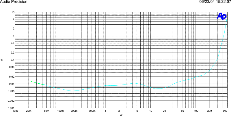

The difference of the UcD400 with the UcD180 is not so much. Only more powerfull Fets and output coil. It's still no Full-Bridge ;-)
We use the same Modulator PCB!
A measurement in 4 Ohm at 1kHz.
Jan-Peter

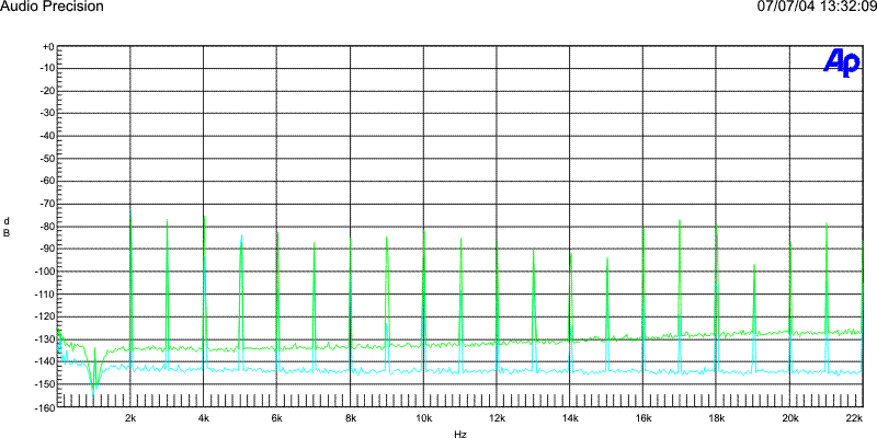

UCD180 modules
Hi Bruno / Jan-Peter
Any chance of you showing the 7.2kHz FFT of THD + noise for the UCD180 that John W showed for his amp on one of the other threads. I believe that it was about 100Watts into 4 Ohms.
This would be much more useful than another meaningless THD_N vs frequency plot which tells you nothing at all!
Or alternatively, an AP FFT plot of the UCD180 doing 19&20kHz @ 100W into 4Ohms. These would tell a much more useful story about the performance of the amplifier.
FuriousD

Hmm, but why exactly 7.2Khz is more informative???THD_N vs frequency plot which tells you nothing at all!
Edited:
BTW, if i remember correctly, for my UcD_like(not optimal implementation) amp THD~=IMD.
7.2kHz would give you second and third harmonic within the measurement bandwidth of the FFT of an Audio P system one or better. (about 22kHz for the system one, and about 24kHz for the system two) and also gives you two harmonics within the audio band!
This gives you even and odd harmonics. Since different feedback systems usually result in very different harmonic perfomances for odd and even, and these usually become worse with frequency, this is the most extreme single frequency FFT test that most designers can do to their amplifier. It is extremely revealing!
It gives a good indication of noise floor (something that the THD_N plot does not).
It is so infuriating to see THD+N plots as you could have fantastic THD in the amplifier, and the designer could be the worst PSU designer in the world and the THD+N plot would rate the amplifier as bad. The THD+N does not tell you anything meaningful at all. I do not know why people bother to show them.
D.

Hi FuriosD,
Hereby a mesauring of the UcD in 100W 4 Ohm and a very known other Class-D amplifier. The lower one is the UcD
