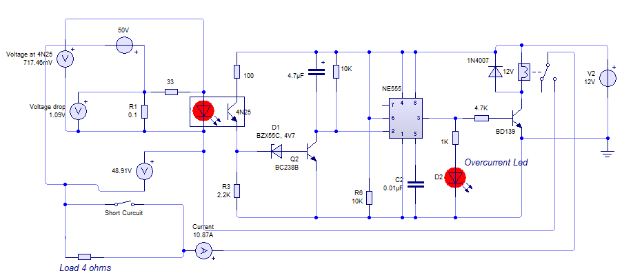

This is my overcurrent protection with shunt resistor and NE555. On output is relay only for testing. In simulator works good. Its need 1V drop to start protection..
I didnt try in practice yet.. I will use relay to cut AC lin to my other part of protection. When AC line is cut, speakers are off momently.
What do you think!?
What do you think!?
Looks ok on fast examination...but have you measured reaction time?..i have a feeling it is too slow..:ashamed:(relay excluded).
Do not use a relay for short protection ..only for dc protection.....the amplifier will burn in the 10ms required for the relay de stop conducting...
Yes, relays are to slow for short protection.. Now this is idea only for overload protect, while I create something faster. But when I think better, maybe isnt too slow.
I use fast relays 24V 2x16A (Helshun HLS-14-F1) with 8ms release time. Maybe is not too slow :)

Supply rail protection will have to wait for the bypass capacitors to discarge...and you need reaction time in the microsecond range.
Yes, I forgot that.. But something come to my mind.. What if I put protection bettwen main capacitors and amp and when protection starts, BC238 is opened and momentaly make short on main relay, then raley is off and it realise time is 8ms. Now active led is off too because relay is in short, I have complite indication of whole situation..
Relay is 24V on example on +-60V, relay resistor is 1.5K (relay current is 24mA).
When reley is short, current through BC238 will be 40mA and his current raiting is 200mA, it can handle.. For sure maybe is good to put stronger transistor like BD139
  • schematic all.pdf
The problem with your aproach is that this will not only save the the transistors in the event of a sudden short(like when the speaker burns)...an efective protection for the transistors must be very fast both in detection and in action.Detector has to be put on output or on the leg of irfp250 after bypass capacitor 470uf but i recomand it on output.
Protector has to stop input signal and/or transistor oscilation ..only the relay will not work..thre is no point in doing just an overload protection and not a complete fast short protection...
