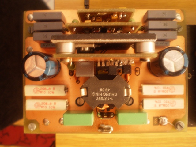

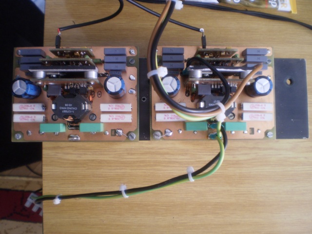

This is my PCB of UCD and run very nice @ +-/80V. Input capacitor is 4n7. One side run on 250kHz and other side on 200kHz.
Thanks for sharing.
I do not know if i will be able to make dual side pcb with traces other than ground plane on top.
Anyway you pcb has also long traces..feeback is very long and near output inductor and switching bus ... but you have alot of ground..it looks alot like my test board layout.
If it sounds good ... have you made any distorsion analysis?
Please someone make the following ear distosion test .
Use 1kz sine wave.Se volume for 10-15 volt rms output. Put a 470 ohm resistor between speaker and output.Connect and disconnect 2 ohm load and listem for any changes in sound.Also watch output signal form on scope.
Thanks again.

Over current protection is from philips UCD amp http://www.nxp.com/documents/user_manual/UM10155.pdf and when the protection was very sensitive i got from amp approximately 300 W RMS. My test was only with 4 Ohm load. My measurement results are here http://www.diyaudio.com/forums/class-d/166214-ucd-25-watts-1200-watts-using-2-mosfets-119.html

I thing that is cool, but not ideal. On my stabilized power supply amp run without any noise, but on SMPS amp produces weak noise. I thing it is from power supply because I don´t have ideal filtering. And when amp run in stereo from one power supply, generate whistle. Therefore, one side run @ 200kHz and other side run @ 250kHz.
