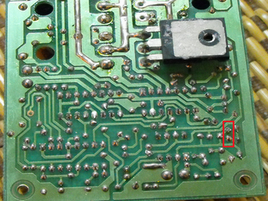

Can you suggest me level shifter values for high voltage operations? On example +-70V or higher... When level shifter transistor burns always explode transistor near by 120R..
I tryed with 2N5401, MPSA92 but I will try MJE350... I use 120R, 47K, 2x 2.2K like in original but always fail with +-70V on startup..
Can you suggest me good combination?

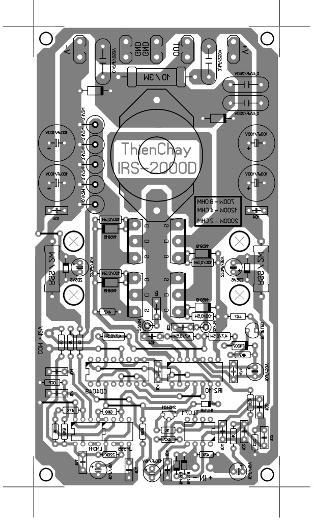

Can Somebody post real pcb layout of IRS3000D I was looking layout of irs2000 and I am confused with some resistors I dont see on the original IRS3000d design but see on this Layout?

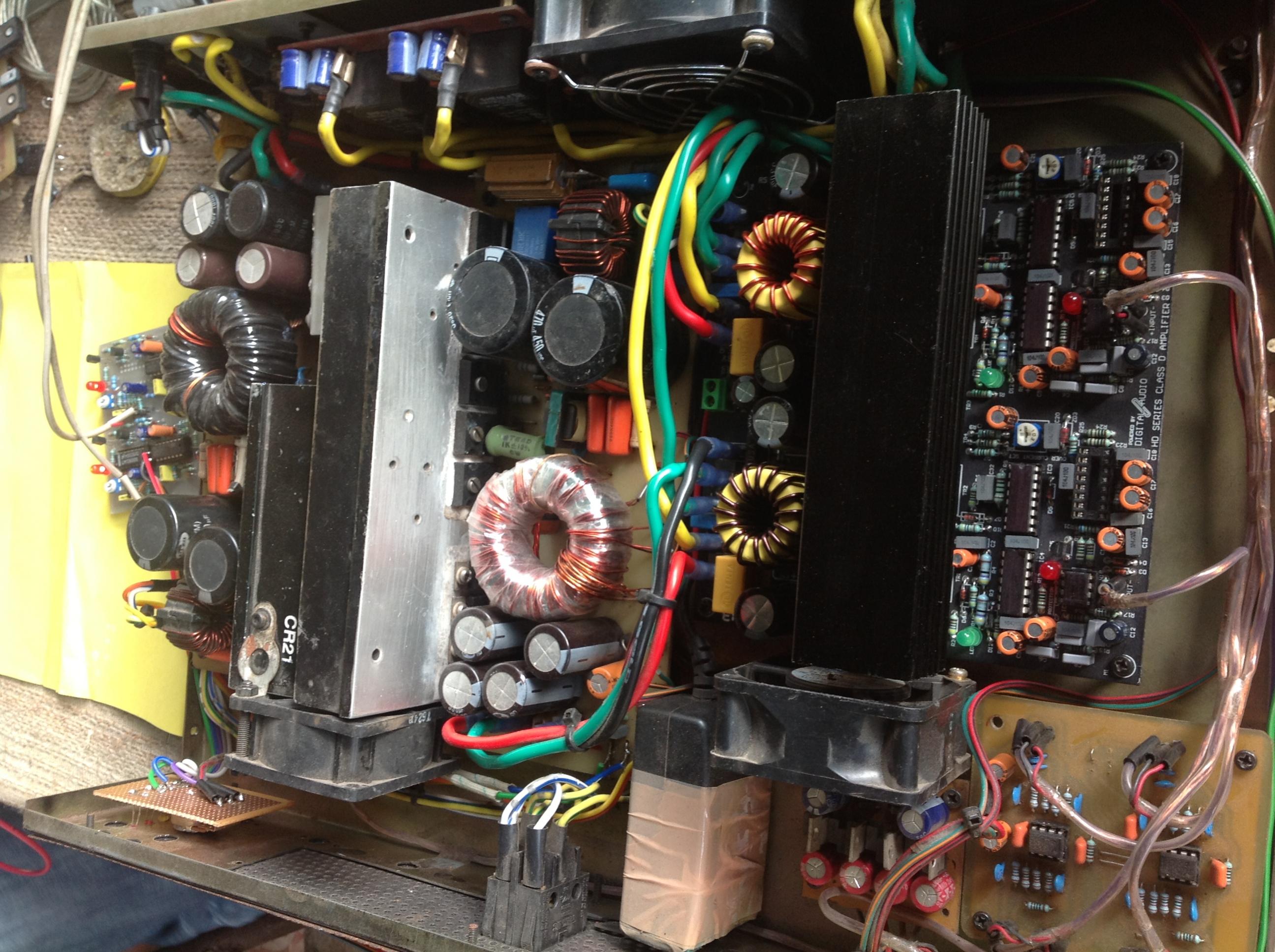

my amp have 900W at 4 Ohm RMS
if output filter goes hot, what can do to solve problem ?
1. Change switching frequency from 200 to 350 khz
2. or change mosfets
If output filter gets hot, you need a better core for the inductor. Or you can try to lower, not increase the switching frequency.
It heats at idle or at good power ? What heats more - the core or the winding?

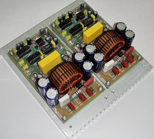

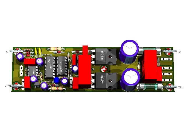

my current project i decided to go non ucd way
Hi Stewin,
Sigma Delta design is good for all
NB: using BIAS +15V you should reduce the value R13 to @250KHz FSW range
Regards
MANOJ
Hi Stewin,
Regards
MANOJ
thanks sir manoj originally i had planned to use irfb4227 or irfp4668 .but since i am using irfp250n i will change the swithching frequency.
also i wanted to reduce fsw by using 820ohms to about 200 khz so as to drive the amp harder .
. thanks again for the correction. i will post the smps i am developing .

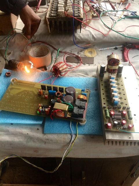

Hi Steven
detex smps is now working today i do some load tests
warm regards
andrew
