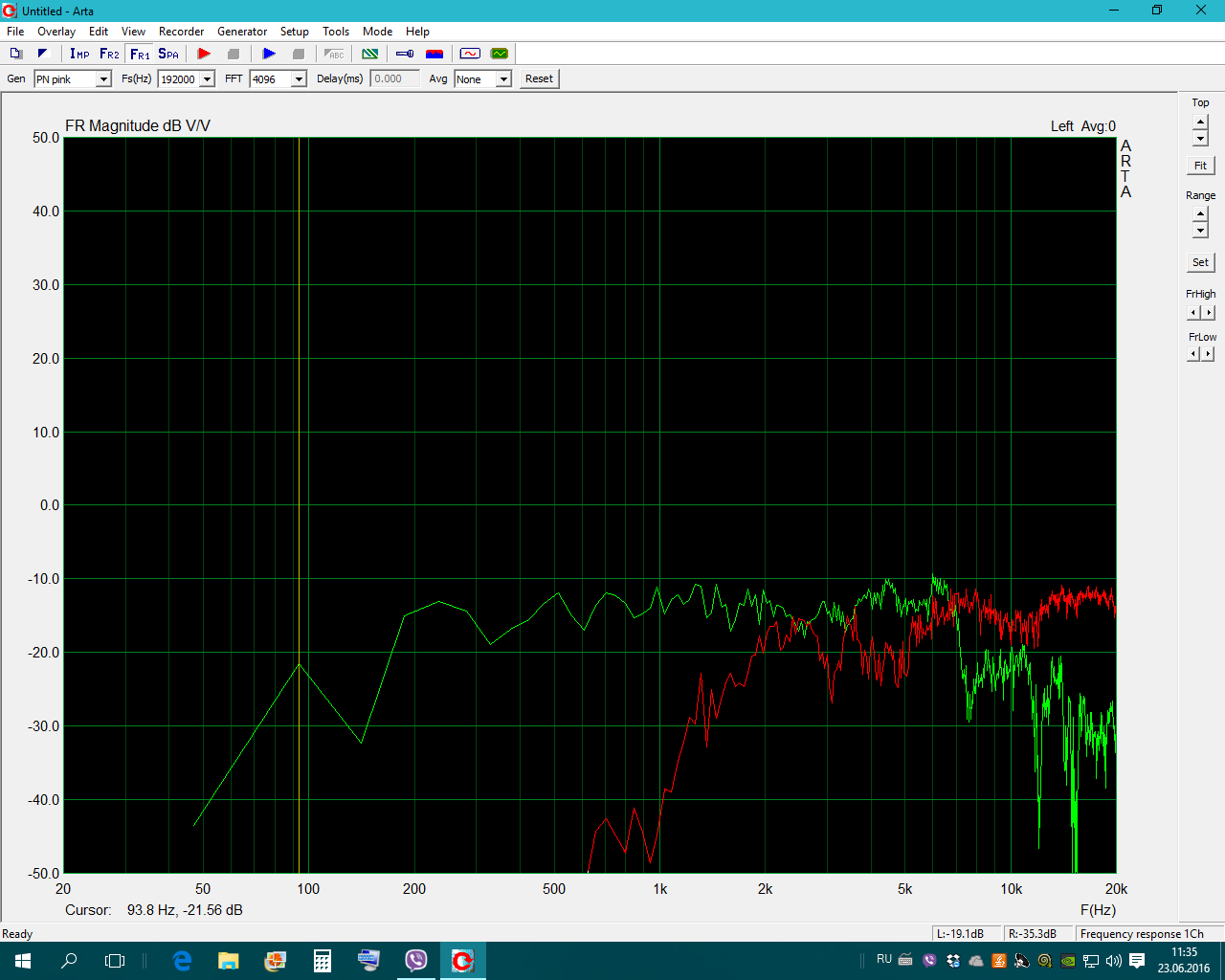

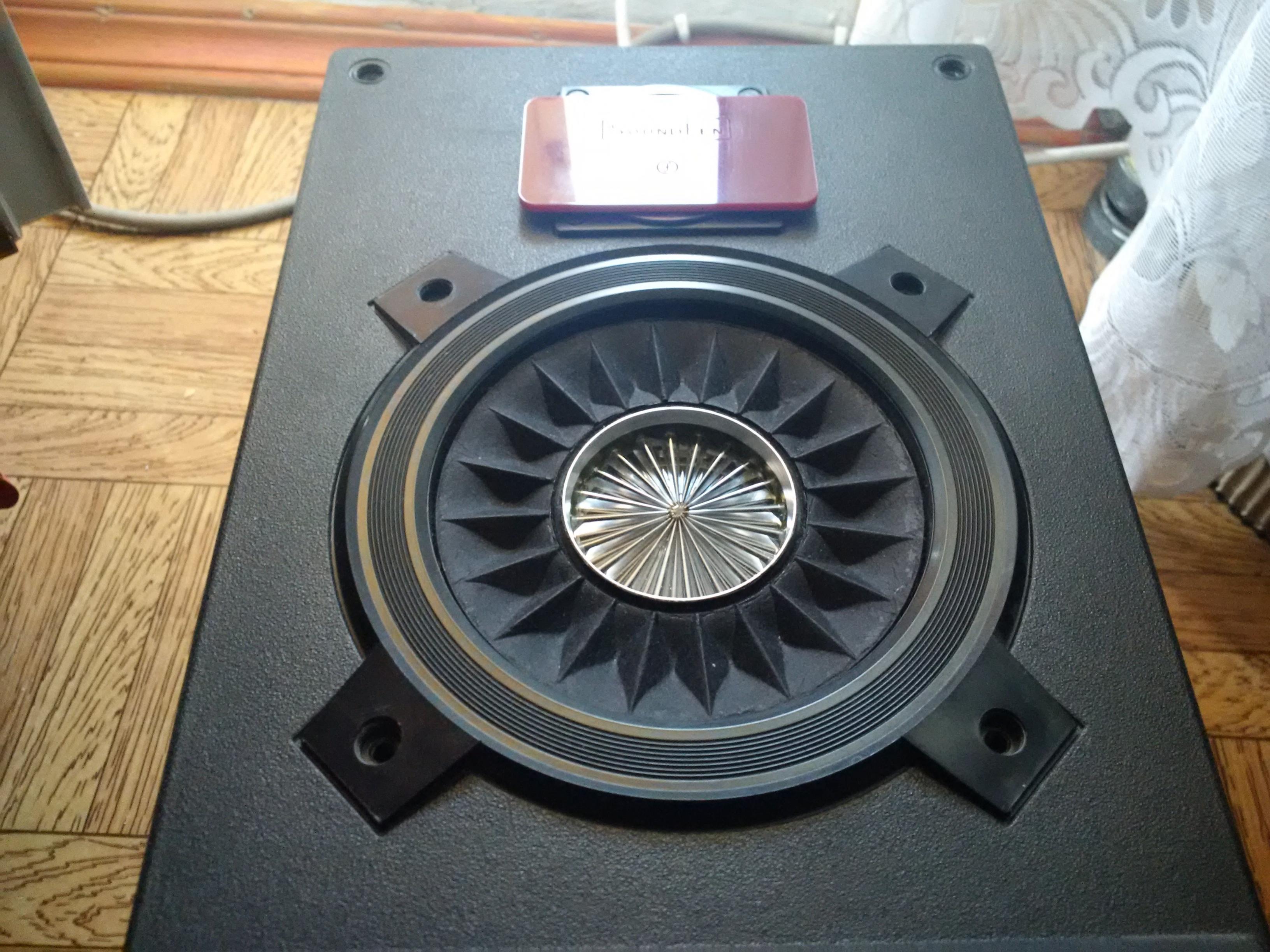

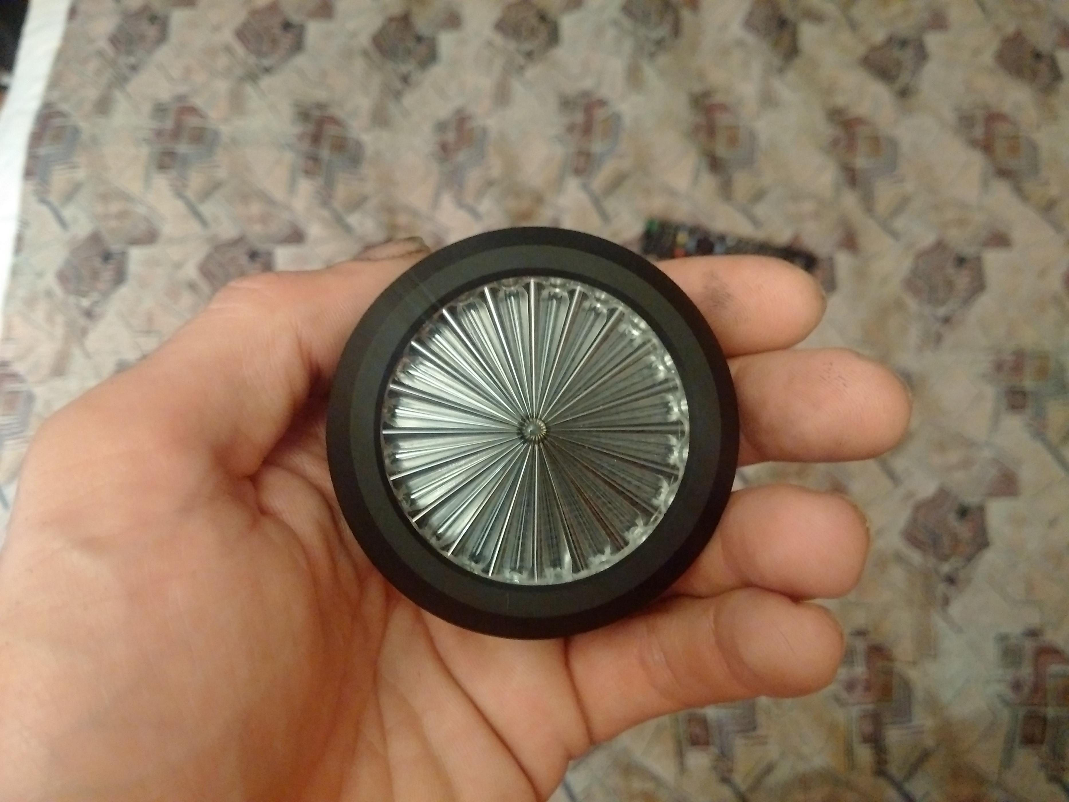

You may want to consider with the closer distances. The design is similar to the emitter Heil, but film is folded radial. So we get more generic frequency response-if we consider the traditional Heil AMT, we see in different speakers Misc distance between waves, and tech same different depth and if compare you will see that and they played differently, with varying intensity, dynamics and of course changing the linearity of the FREQUENCY RESPONSE. There is another factor for positive impact on sound design in SF, it asimetričnaâ the stiffness of the film.
At home it is called (Probe with circular polarization)
