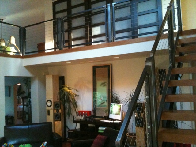

So, I figured out it may not be the imac and the sound out. I have been using an additional program called AudioHijack pro which hijacks the output of the computer and can run it through any number of processors, in my case a 31 band digital equalizer.
I have been using rudimentary RTA on the iPhone and the equalizer to near flatten the room response.
This seemed to work well on the mac mini and my less sensitive speakers. I also adhered better to the "don't amplify with an equalizer" adage.
With the new more sensitive speakers and my aggressive equalization based on overconfidence and ignorance, I think I boosted the signal way to much.
I am working to do this right again, but it is hard to find time to run sweeps and play pink noise with a sleeping baby.
Any other suggestions for this type of signal processing?
