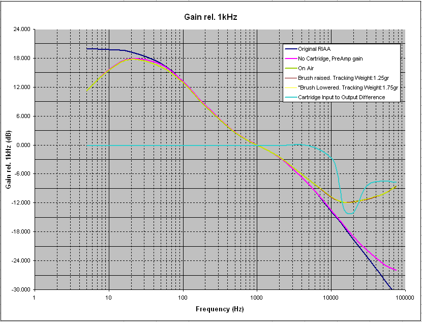

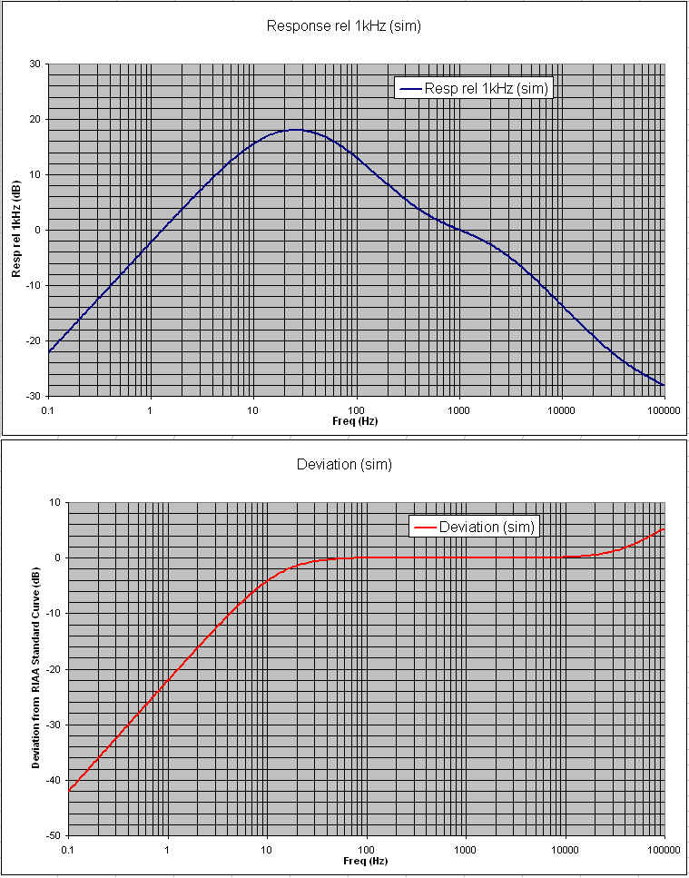

For these recordings I have used the Hagerman Bugle RIAA preamplifier which incorporates the IEC amendment to the original RIAA spec.
Thus there is already a low freq roll off in there.
Att. 1 is the freq response of the M97+Bugle (measurement, 60kOhm// 288pF loading)
Att. 2 is the gain plot of the M97+Bugle (sim) and the deviation from the original RIAA curve (sim)
George

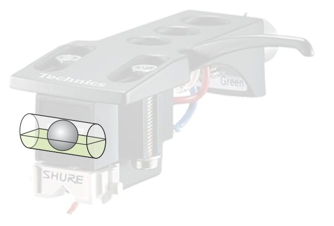

Yes Ray K,
that type which you had posted earlier. but on small scale. OR with viscous fluid like pic attached. And shown in following video link
Tuned mass damper

The damper as shown in the diagram would only damp lateral motion. It would have very little effect in damping vertical motion which is the direction the damping would be mainly required in.

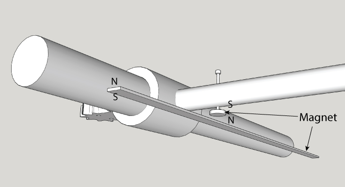

Actually, I am thinking of building a magnetic vertical damper for my air bearing arm. Please see the sketch. I realized that vertical damping is more important than lateral damping based upon Hans' analysis. The magnet bar doesn't have to be very strong. A narrow piece of magnet tape may work perfectly. The gap between round magnet and magnet bar should be adjustable.

Magnetic damper: how does it work? What is dissipating motional energy here? Wouldn't an eddy current damper work better?
Please note that the north poles of both magnets face each other. It generates a force to push the back part of arm upwards. Once warp happens, the force will push back part of arm up. So, there will be a down force to act on the cartridge vertically. The higher the warp is, the stronger the force will be because the gap between two magnets gets smaller. Eddy current is for lateral damping only.

I think this is a great idea for lateral damping. However, the shortcoming is you are not able to change the damping force unless you make a set of damping device with different weight of steel balls.
From you description (although I am bit lost between "ups" and "downs") I make out that the opposing magnets act as a spring. But what is causing energy dissipation (=heat generation)? Analogous to a car suspension, there is mass of the body, suspension springs and shock absorbers providing damping. Damping indeed is ignored in most tonearms, unlike at the Townshend solution.
