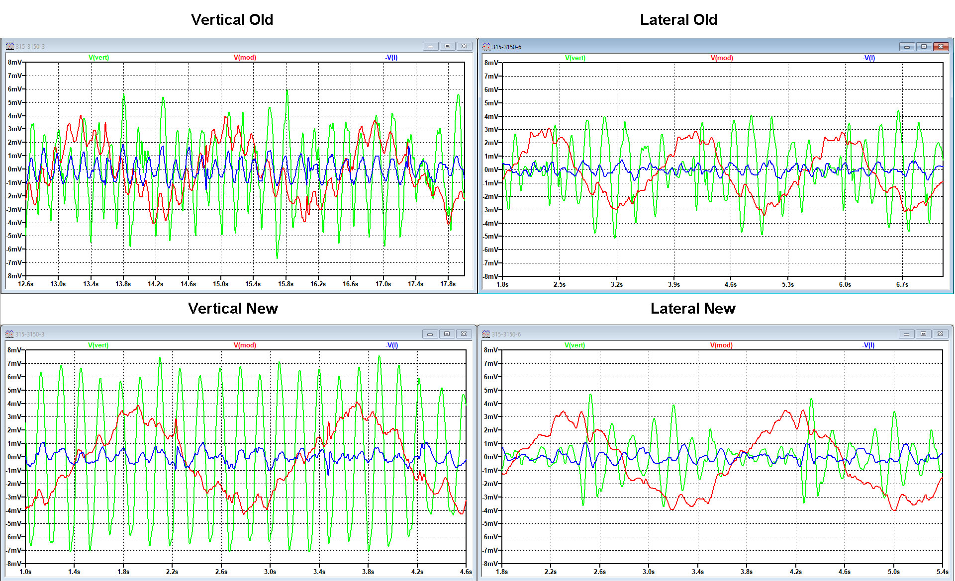

Hi Jim,
You can see a large difference with the previous recording, although recording time was too short this time to find Fres.
For that reason I have picked from all 4 recordings a time piece corresponding to two LP revolutions to make things easier to compare.
In all timegraphs, you see the vertical movement V(vert) in green and the demodulated signal V(mod) in red.
Since the LP is quite eccentric, I have filtered V(mod) below 2Hz, to show the frequency part of the modulated signal that really matters.
This is visible as V(l) in blue.
In my computer model, 1mV corresponds to 0.1% FM modulation.
In the old situation V(l) has visibly a very high correlation to V(vert), the vertical time signal as coming from the Cart.
In the new situation V(l) is much smaller with a much smaller correlation to V(vert).
Also notice that the signal V(vert) itself has a much more stable amplitude in the new situation.
In the Lateral versions, you see in both versions, old and new, that the amplitude of V(vert)is very much driven by the LP’s eccentricity, with a cycle time of 1.8 sec.
V(l) in the new situation seems a bit smoother with a tad more FM modulation.
All in all, this is a clear improvement.

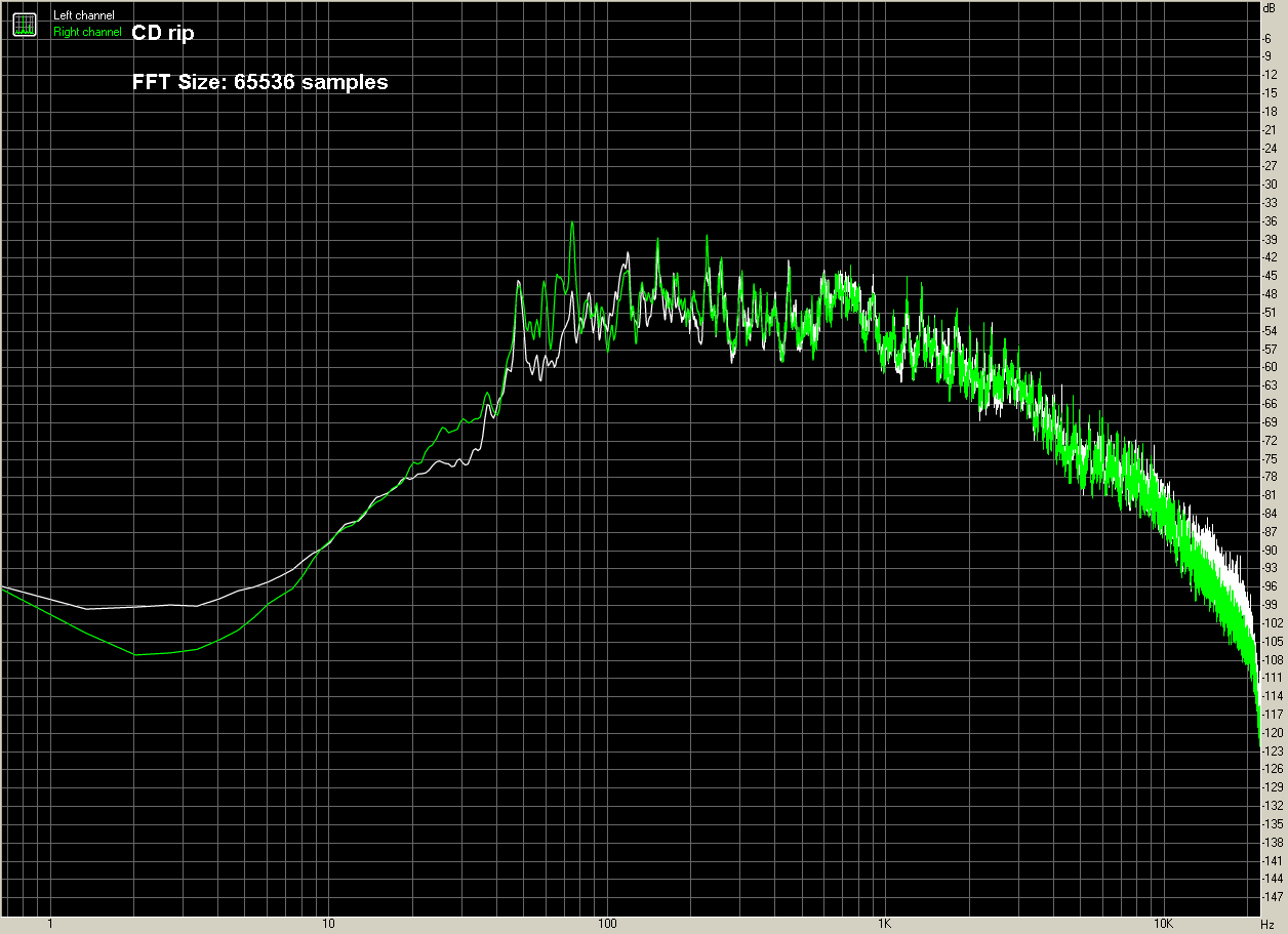

But in the meantime you could make a recording of a silent track.
The noise spectrum may well show the (Vertical) Cart resonance.

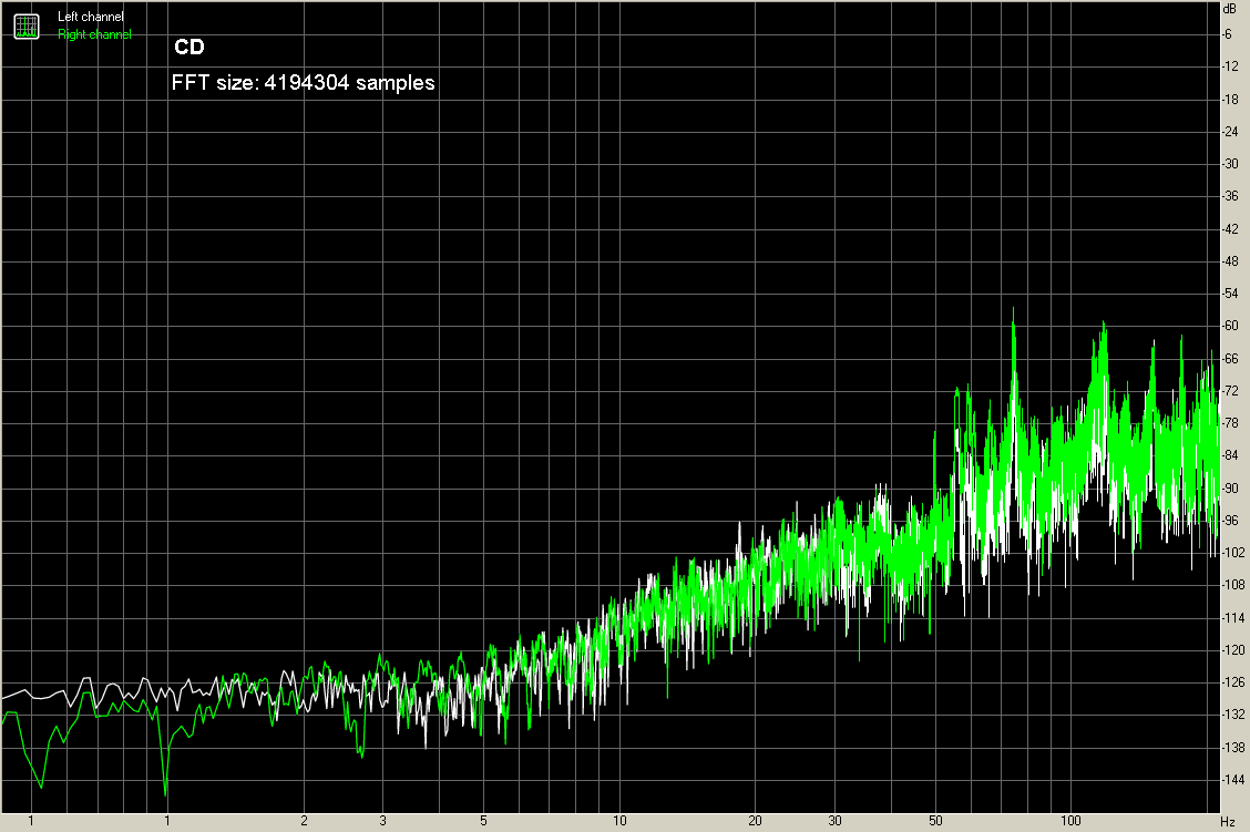

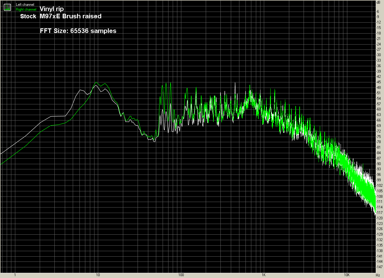

Yes, a recording from a lead-in or a lead-out grove will do. Run an FFT on it.
Even a recording from a music track will do.
Here is a 1 minute sample from “O fortuna” (track 1 Side 1 Carmina Burana, Carl Orf)
(Shure M97, SME 3009 Improved, ThorensTD160, Hagerman Bugle RIAA pre)
Vinyl track, Shure M97 stock
Vinyl track Shure M97 stylus assy glued to the body.
CD track for comparison
George

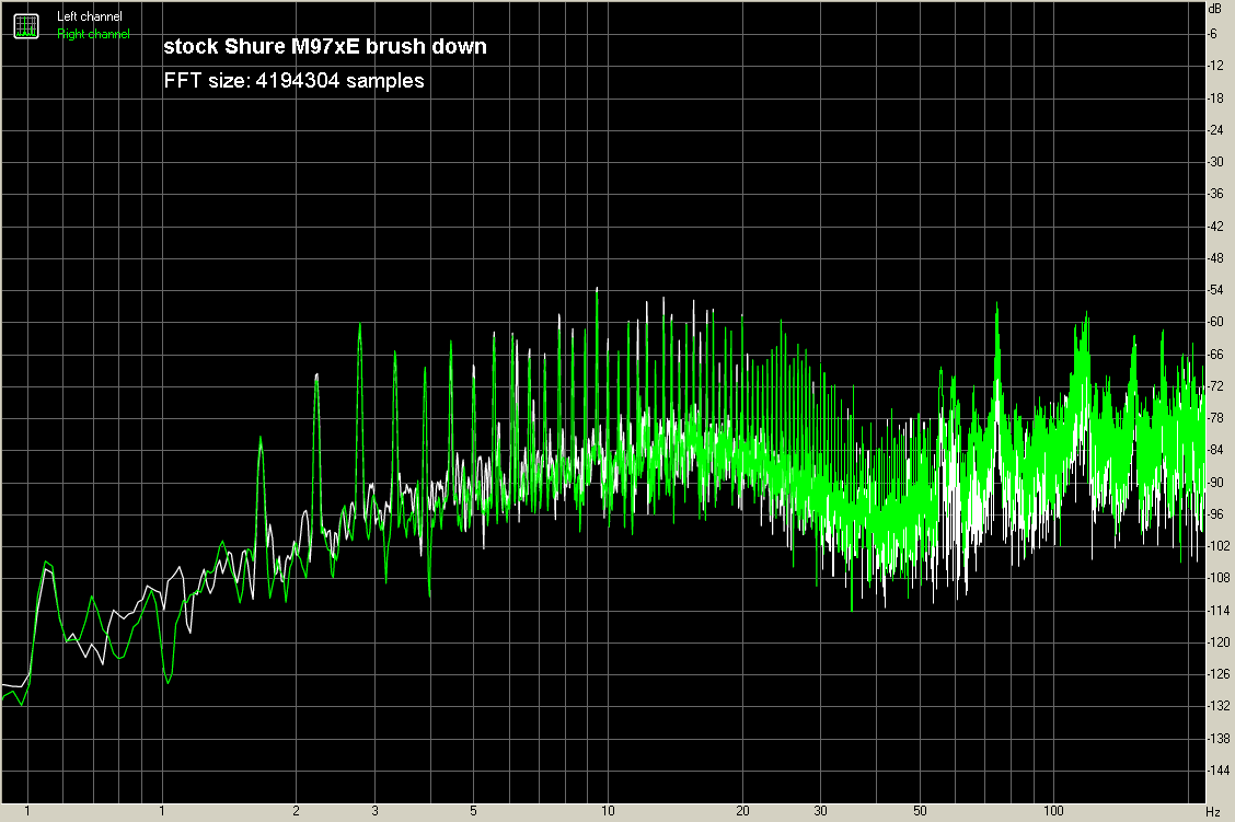

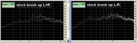

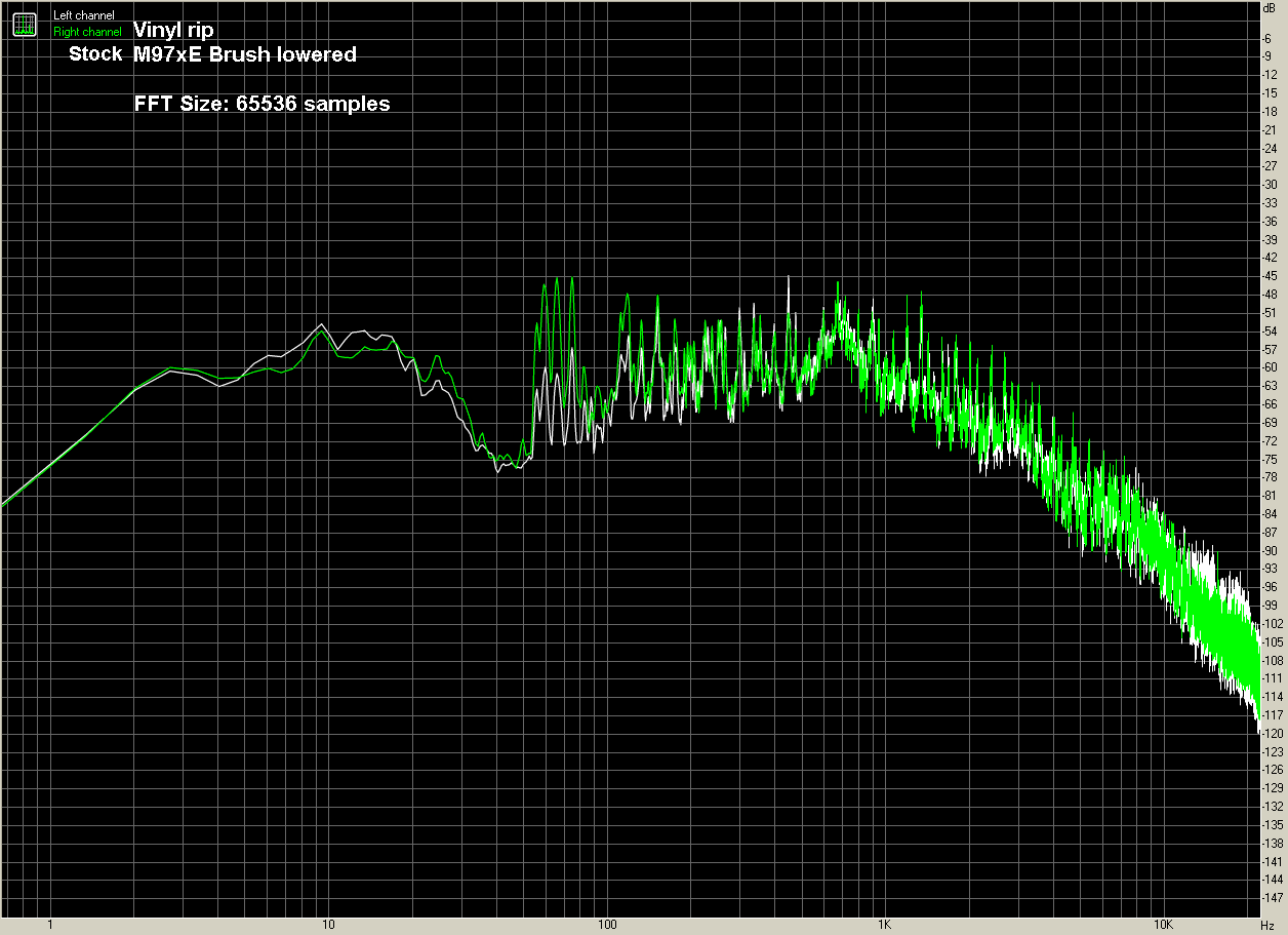

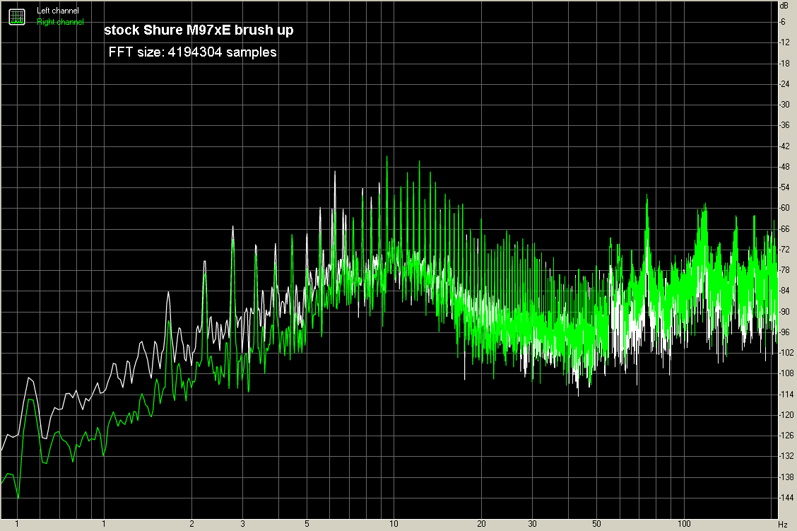

Joined 2002

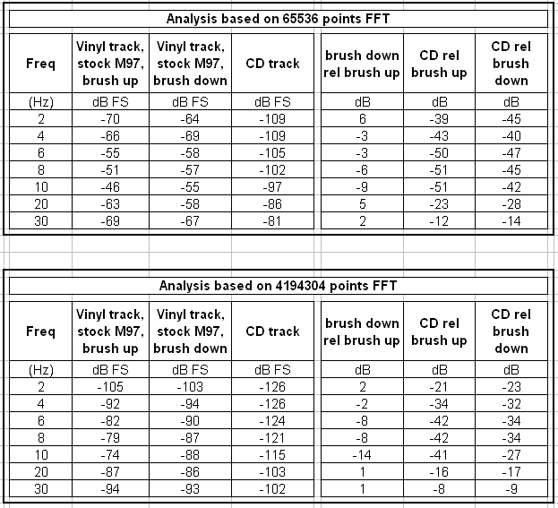

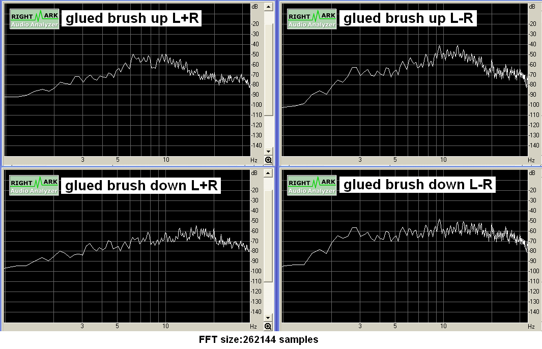

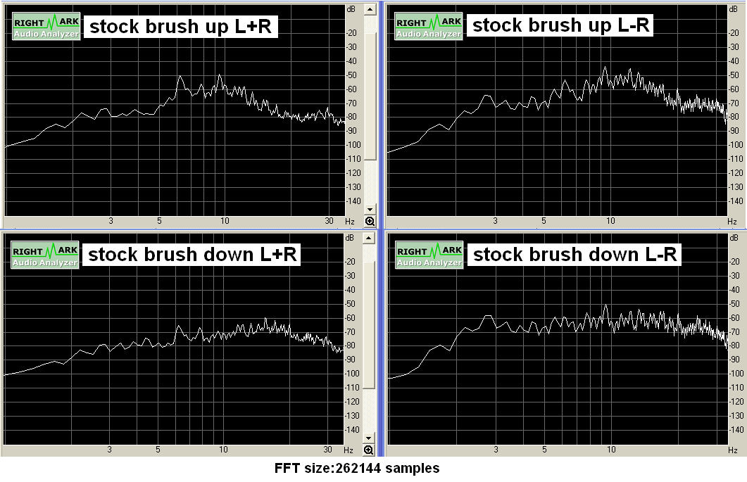

Very informative to see the noise spectrum around Fres coming down some 5 to 10 dB with brush applied.
I made a small table for easy comparison, see attachment1.
Upper table is based on 65536 points FFT
Lower table is based on 4194304 points FFT

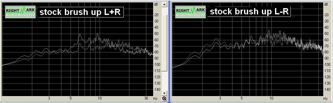

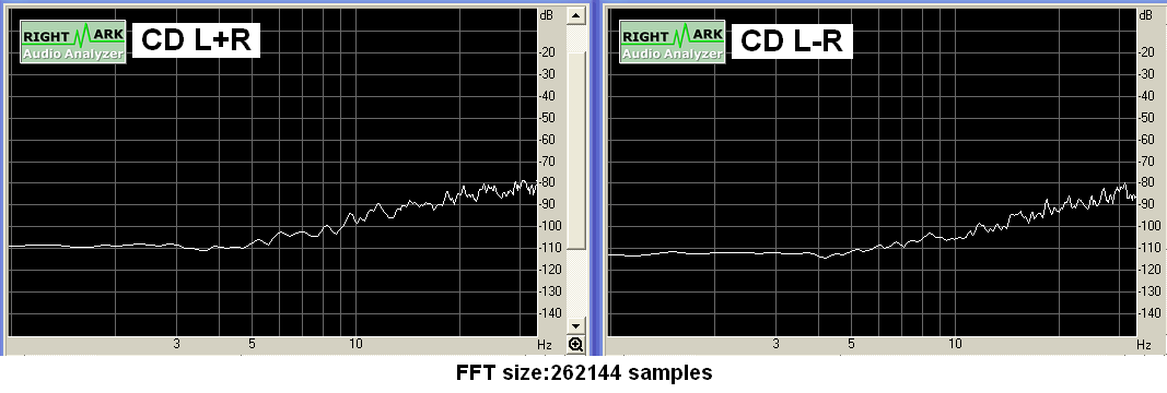

We have to remember that low resolution FFT level skirt incorporates the peaks due to record eccentricity, while with higher resolution FFT we are able to estimate the base frequency level, separating it from the 0.55Hz effect.
Nice graphics
I didn’t want to scare you much.:D
Increasing the FFT samples, the ugly eccentricity peak consequences show up, see attached screenshots.
George

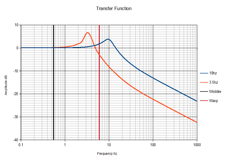

This really is the most fascinating thread. In my work designing tonearms I have mainly looked at the movement of the cartridge relative to the groove purely as displacement. Although I was aware of the effect that these displacements had in the time domain I hadn't explored this approach as fully as maybe I should. My thinking was, reduce the amplitude of the displacement and all the timing and other nasties go away.
I've held the theory that compliance/effective mass resonance is much more significant in the vertical plane than the lateral for a long time. It's great to see actually measurements that confirm this. Detractors of linear tracking arms often state that their high lateral mass causes "the tail to wag the dog". This is a myth and this thread should help to dispel it. The compliance resonance of a conventional pivoted arm in the vertical plane is much greater than a typical linear tracking arm in the lateral plane. This is partially because warp occur at higher frequencies than eccentricity. But even if you have a perfectly flat record the resonance in the vertical plane will still be dominant. This is despite the fact that the lowest frequency groove modulation is entirely lateral. This may seem counterintuitive. But try dragging a stick across rough ground, the stick will want to bounce up an down much more than it does sideways.
Increasing the frequency at which this resonance occurs so that it falls much higher in frequency than that due to warps, 0.55-~6hz, may seem like a good idea but it can have negative effects. At low audio frequencies the motion of the cartridge is predominantly controlled by the mass of the arm. A higher mass allows the cartridge to move less, try shaking a heavy weight and a light one. I've recycled the graph from a post I made in another thread as it illustrates the point. This graph was made to describe one of Jim's earlier linear tracking arms. The graph shows how much the cartridge body will move relative to the motion of the stylus measured in dB. For an arm/cartridge combo tuned to 10hz the motion of the cartridge body is only 10dB down at 50hz. Increasing the mass so that the resonance is 3.5hz (lower than I would personally go laterally) improves things by 9dB, ie the cartridge body will move by just over a tenth for the same stylus movement. Generally 4 times the mass will halve the resonant frequency and reduce the cartridge movement by 6dB. Within the range that vertical effective mass/compliance would normally be turned to, 8-15hz, the effect is less dramatic, varying by about 2.7dB. As the motion of the cartridge body is about 180° out of phase with the motion of the stylus for most of the audio range the effects are less detrimental than if the phase angle was not aligned thus.
In my opinion the key to controlling the compliance/mass resonance is the application of damping. At the frequencies at which this resonance occurs the armtube is effectively a rigid beam. so where the damping is applied doesn't really matter, a little bit out near the cartridge (Townsend trough, Shure brush) or more near the bearing. Of course the use of a warp flattening clamp will reduce the main force driving the vertical resonance.
My arm is a linear tracker with a total lateral mass approximately 3.5 times its vertical effective mass. Even with this difference in the masses I've still set damping in the vertical plane to be 3 times as great as that in the lateral plane.

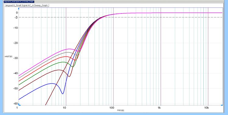

This is one of those off but on topic questions, but as the plots are here seemed the best place to put it. As part of the planning for the integration of my various phono projects I had a re-mull over HPF and noticed that Self has produced PCBs for his 'deviynliser'. In effect this is very similar to a mastering elliptic filter in that it gives very steep roll off for side information and leaves mid untouched. Now although the damage has already been done, and damping is the best way in a undamped system there is still considerable energy in the subsonic region that flaps woofers and eats up ADC headroom so I think its worth the experimentation to see if it's a useful thing to be able to patch in?
Sadly this now means I need 3 inserts in my analog front end. Four if I get the coils on one of my cartridges rotated 45 degrees to give M-S output rather than L-R :)

Hi Niffy,
I'm a bit confused by your graph. The Am/Cart resonance is a second order system.
A second order system, whatever the damping or the Q is, drops down after some time with 40dB/decade.
Yet in your graph between 100Hz and 1000Hz it is only 10dB.
Could it be the scale is wrong ?
Hans
