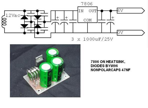

Yeah Joe's schematic showed DC, but my original PS wasn't working so I scrapped it for a 6.3-0-6.3 one I had hanging around. If I rectify that supply I'm going to end up with around 9 volts on the filaments which will probably burn out the tube.
Any ideas on how I can rectify and still get 6.3v.
Thanks...Lee
Yes, you could use a simple 7806 for a start, although a 3V drop won't make it very happy...a LM317 would work better here...athough just about working too.
There are some low drop 6V regs around but I can't give you the exact reference for those...semi conductors aren't really my field, maybe someone is kind enough to point you to some references.
You could calculate for some series resistance, either infront or after the diode bridge to burn of the excess voltage as well, it's just a temporary arrangement anyway.
Also, if you look further up, at the early stages of this thread, someone posted a circuit that bypassed the tube altogether using a 330R resistor if I recall it correctly.
Either way, hum is easily identifiable through speakers as hum, noise in general is a different ballpark really...
I'm sure that when you dig a little in the "Tubes" section of this forum you may find plenty of inspiration.

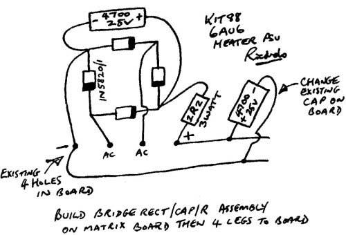

Does the hum stop if you remove the valve.?Maybe your supply has excess ripple
This circuit can be used for the DC supply,this was a mod offered for the WAD amps that suffered hum,althouth the Tx was a nominal 6.3v AC.I rather use something regulated like LM317T than use resistance to drop excess voltage.
Regards
Peter
