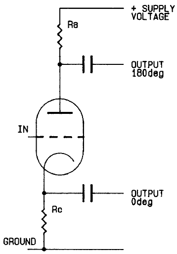

Unbalanced Input using a split load (aka Concertina) phasesplitter. Uses 1/2 ECC88 (or whatever you care to choose), when driving class A1 output stage balance is determined by the cathode and anode resistor.

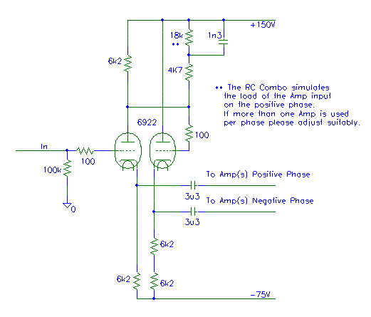

Well, as said, if you do not want to use a transformer he best phasesplitter (if buffered) is the concertina. If you don't know what a concertina phasesplitter is you could google it....
One site you might not directly come up, as it uses the term "cathodyne" is this
http://www.bonavolta.ch/hobby/en/audio/split.htm
A circuit suitable in principle would have a normal cathode follower, input directly to grid, 100K gridleak resistor, but with a positive supply of twice the value of the negative supply and a resistor equal in value to that of the cathode resistor in the Anode circuit.
The signal is taken from anode (inverted) and cathode (non-inverted) via coupling capacitors. The signal from the Anode is ideally buffered by another cathode follower, grid to anode of input valve and anode to the positive supply which is twice the negative supply. The cathode resistor then needs to be twice the value of the resistors used in anode/cathode of the input valve.
I would use a mains transformer with 55V + 55V Windings, giving around -75V and +150V when a voltage doubler is used for the positive voltage. If we use the 6922 and run 12.5mA per section we need resistors of 6K2 in anode and cathode of the splitter plus a 12k Cathode resistor for the follower buffering the anode output from the phasesplitter. Make all resistors 5 Watt types.
That should do the trick.
