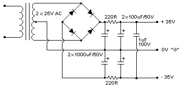

Yep, I thought it was a bit odd in that there was no series R.
Just an idea: wouldn't it then be better to move the 1uF filmcap to the last cap ( the 100uF) ?
Have nice weekend,
P.S. I am assuming you mean the PSU here:
MAIN POWER SUPPLY
Did anyone spot my earlier mistake re Pi filter... ???
My suggested fix, if my hunch is right, is to add an RC filter, something like 220 Ohm and 100uF (min) after the 1000uF. Give that a go.
Have nice weekend,
MAIN POWER SUPPLY
fdegrove said:Hi,
You get the eagle eyes award!
Actually the Pi filter would require a series L, which looks like moamps did.
Have nice weekend,
MAIN POWER SUPPLY
Exactly!
Here is the revision of that part of the schematic:
I hope this will fix Tor's hum.
JR

Hi Tor,
If Joe doesn't mind my answering for him:
The 35V caps are risky to use there since the rail is +/- 35V already.
You could use them in series with voltage balancing resistors but you'll end up with half the capacitance and twice the insulation voltage: 23.5uF/70V.
Any insulation voltage higher than 45V should be O.K., maybe you can find some 100uF/100V or even higher?
The 330R resistor should work, the idea is to replace the Ri of the buffer with the resistor.
Hope this helps,

If you're sure they're AC rated then that should do it.
I don't think the absolute uF value of the cap would be all that crucial, so give both a try if the Pana is within voltage spec...

One further thought:
When looking at Joe's PSU, the corrected version from left to right here's what I would try:
Use you 1200uF caps as the four first caps 9 or even add another pair or two, than the 68uF Mundorfs + 1uF filmcap + 0.1uF film ( if you don't have some then a close value would be fine) and tell you notice a perceived increase in dynamic range and power.
It may just be wishful thinking on my part though...

IF I'd known you had Panasonic FC1200uF, then I'd said go for it!. Indeed 100uF I would consider the minimum. Re 220 Ohm, 330 Ohm will do but don't make higher than that or else the voltage drop becomes too severe. That value should drop near a volt and we don't want to drop by any more than that. In theory the larger the cap you use, you can use a smaller resistor before it for a similar amount of ripple, so 100-220 Ohm might also be accetable. 100 Ohm should only drop 0.35V approx, 150 0.5V etc.
JR

Hi!
I rewired my tube supply adding two 330 ohm resistor in paralell and a FC1200 cap on + an - supply. The hum is almost gone!!
So thanks!
But now I have another problems (it won`t come easy!) the left channel have half the volume that the right.
I have tested the left channel on both the left and the right power stage and the result is the same, so this has nothing to do with the power amp or the pot.
Both channels of the tubebuffer measures the same regarding DC, no shortcuts...etc, etc. So I don`t know what it is.
I have ordered a new 6922 and I hope that I somehow have managed to damage on of the triodes and that a new tube will solve this.
But the hum is gone!

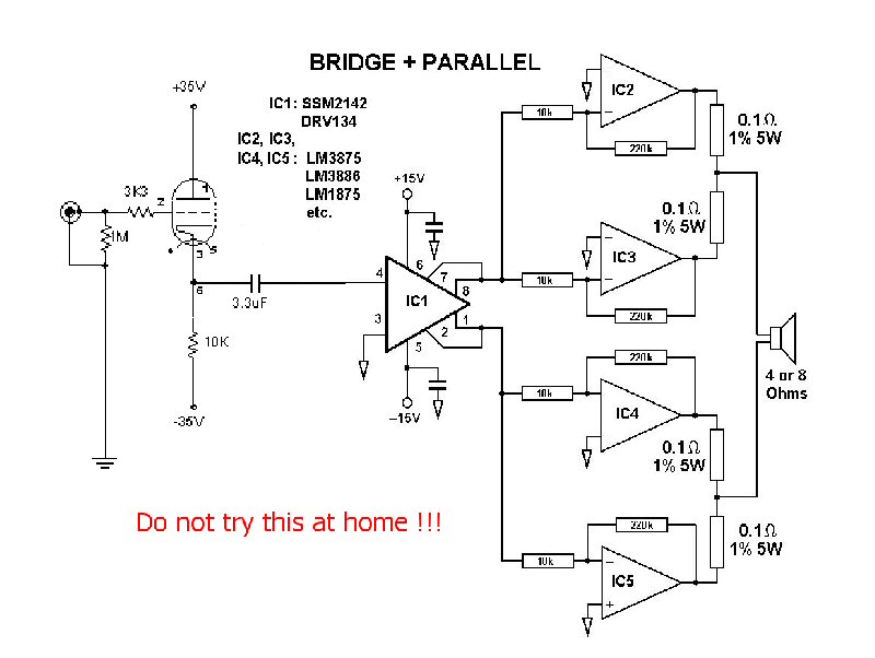

After some research, I found out that Jensen input transformer are 100$US which is a bit pricey to my taste so I was wondering if the following approach could be possible.
Most of you will see that I've merged two schematics posted on this forum.
Would it work or am I completely beside the track ?
Thanks for your help !
