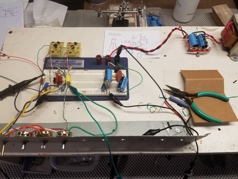

I've done some further experimenting with the KMG gain stages.
First, I was getting annoyed with the B+ fluctuating with the line voltage.
So I decided to make a simple series pass voltage regulator.
I had some 75v zeners laying around, so 4 of them would be good for the desired 300V.
I used an IRF820 as the pass element. I included a 1k gate stopper. It seemed to work.
Did well with a 20mA load, which is way more than what I intend to use.
Good, now I don't need to keep adjusting the variac to get 300V.
I made a perfboard module containing the LND150, the 1k and 180R resistors and the 6 diodes. This mounts a couple inches away from the breadboard and has 3 leads, which can be considered "plate", "grid", and "cathode." This frees up a lot of space on my rather small breadboard. Plus it prevents confusion.
So I tested the module with the new regulated supply. Works perfectly. So I build a second module. I wanted to test if two gain stages could operate off the same +3V fixed bias rail.
First, I connected the output of the 1st stage to the input of the 2nd with a simple 470k/470k voltage divider. Of course there's a 22n cap off the "plate" of the first stage.
Everything's looking good. Behaves as expected.
Next, I put the standard Fender TMB tonestack, with volume control, in between the two stages. Fired it up, looked at the output on the scope, then started twiddling with the knobs.
Here's where things got ugly. When the treble control and volume control were turned past 7, I got some horrible oscillation.
Not just a little fuzz on the tips of the sine wave, we're talking full blown berserk mode.

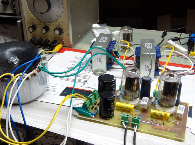

Here's a photo of what I've got so far. The isolation transformer is on the far right, the voltage doubler is built on the terminal strips. The regulator is on the right half of the breadboard, the LND150 modules are above the left side of the breadboard. The metal plate, cut from an old computer case, holds the pots. You can see the breadboard is rather small, but it's what I've got. Yes it's all mounted on a piece of wood. The signal generator, scope, variac and other equipment are off camera.

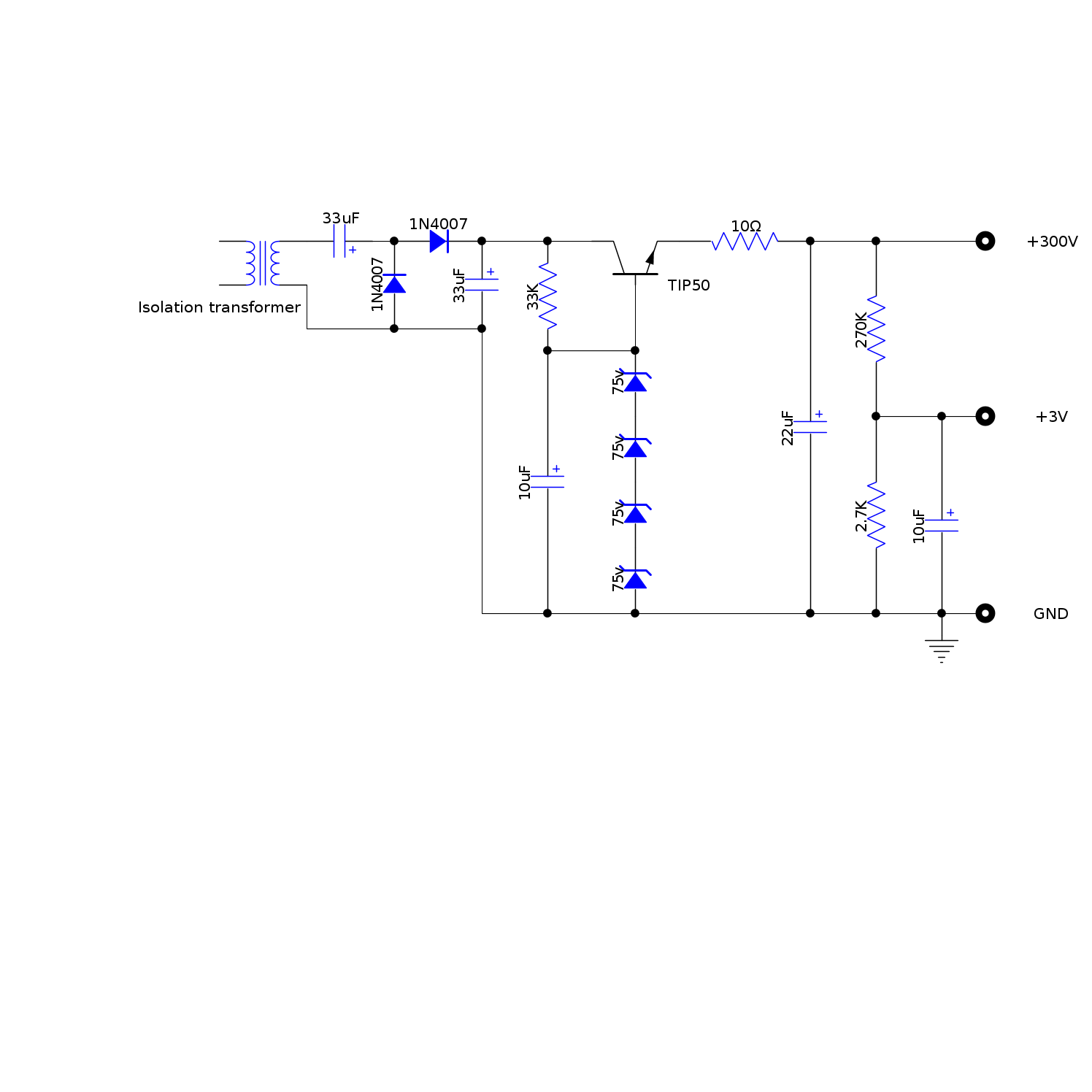

I've attached the power supply/regulator schematic I am using.
The capacitor values were chosen kind of arbitrarily based on what I have in stock.
I had a couple of 33uf /450v so I stuck those in there. The 10R resistor is there because the schematic I copied has it. I think it's supposed to protect the transistor in case of a momentary short circuit, but I don't know about that.
I could add a transistor across this series resistor for a current limiter. If I bump up the series resistor to 22 ohms, it should limit current to 27ma. More than I plan on using, giving plenty of margin, but low enough to (hopefully) protect the TIP50 in case of a slip of a voltmeter probe or something.
I'll have to see if it's going to need some RC decoupling as I add more gain stages. KMG's design uses RC decoupling but doesn't say if he's using a regulated supply. He was trying to be true to the original JCM800 valve amp, but I just want something that sounds good.
I'm really quite surprised this high voltage stuff works in this type of breadboard. There's no way these things are rated for 300+ volts, probably more like 30.
I try to space things out at least 2 rows, but there's some places where you can't avoid having to use the adjacent row.
It is quite an adventure sticking a scope probe in there, with some of the component leads sticking up with 300v on them.

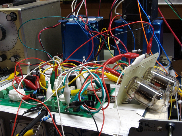

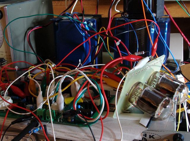

Anyone know if contemporary LED lights or compact fluorescent bulbs cause amps to buzz? I'm guessing not,
I spent half a day chasing "oscillation" in a tube amp breadboard, the sucky kind that comes and goes when you touch things. The scope showed it on the output and the distortion readings changed considerably as I poked my finger around in a live amp, one that was running on over 500 volts....then it dawned on me that I had recently swapped out the fluorescent shop lights for some fancy LED shop lights from Sams club. Sure enough the oscillation vanished as soon as the lights were switched off.
I have noticed that there are several things that will make small but repeatable changes in the distortion measurements on a clean tube HiFi amp. Distortion in the under 0.1% kind of clean. The shop lights will double that reading, and I can get it up to 0.5% by poking around with my finger. The LED light bulbs in the fixtures in the basement ceiling seems to have an effect sometimes......the mystery as to the higher distortion readings at night has been traced to the 4 year old low budget Walmart black Friday 65 inch Visio TV in the room above my workbench.
I have not noticed any difference in the sound quality in the HiFi amp playing real music through speakers with or without the LED shop light on, but it DOES raise the noise level in my high gain 4 tube guitar amp when the all the knobs are turned up full. The $50 swap meet Squier Strat is worse case, but it's rather noisy and poorly made to begin with......I traded a big box full of tubes for it.
The noise is not really a buzz, but there is some 60 / 120 Hz content in it, more like a modulated hiss.
I guess this is a general problem of vintage tube designs. Compared to modern semiconductors with SMD parts, physical dimensions are much bigger, the wiring of a tube amp is a bunch of antennas. Consequent electro-statical screening might help in your case, as does in electrical guitars as well.
We can do something about the wiring outside the valve (keep it very short, etc). But there are also all these inches of wire and square inches of metal plate inside the glass bottle, nice little antennae that we can't do anything about!the wiring of a tube amp is a bunch of antennas.
(Okay, we can slip grounded metal shields over our 12AX7s, if we don't mind them getting a bit hotter. But those of using oddball preamp valves won't find ready-made shields for them.)
This issue of internal antennae came to my mind some years ago when I read a few Internet posts by people attempting to make a complete guitar amp out of one single 6AF11, a three-tube compactron containing two triodes and one power pentode all in the same glass envelope. Most of these attempts failed, because with the output anode within a couple of centimeters of the input stages in the same bottle, feedback and oscillations were a chronic and virtually unsolvable problem.
For my own builds, somewhat to my surprise, so far I've gotten away with the components flat on the underside of the plywood "circuit board", and a ground plane a few millimeters below that. It probably helps that I don't build very high gain amplifiers.

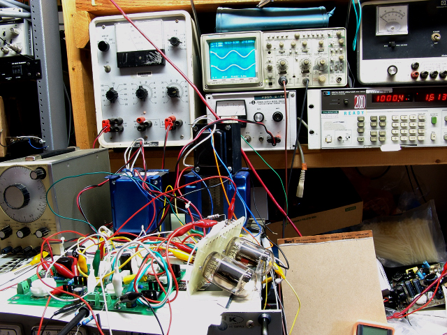

My HiFi amp breadboard is probably near worse case for being a receiving antenna. It contains mosfets and tubes and is spread out over about 4 square feet of bench space with long unshielded leads to the power supply and test equipment. I was also dealing with very low (for a tube amp) levels of distortion.

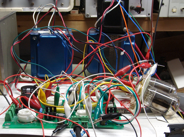

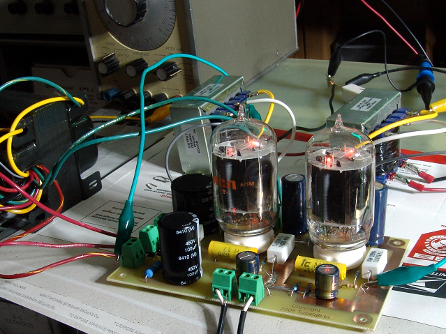

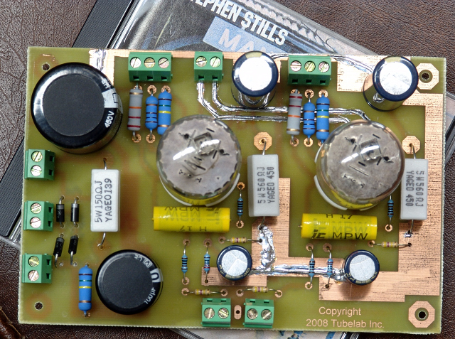

After being pleasantly surprised, I distilled the "furball" down to a PC board. It made about 2 watts with the small dual triode tubes, 5 watts with the small triode - pentodes in UL, and about 9 with the big triode - pentodes in UL.

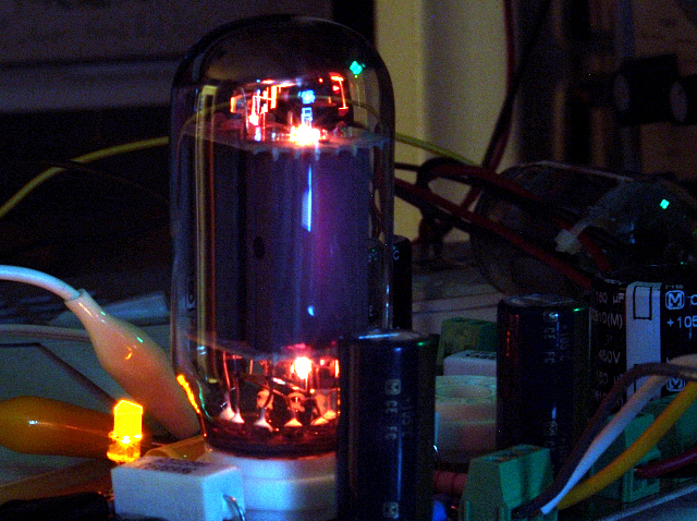

What do you do when you find a tube with a crack running up the entire side of the tube, but a good getter......you "test" it to see if you can break it! I had my power supply to 500 volts and that poor tube just kept cranking. I was getting about 12 watts of reasonably clean audio out of it.....and a good bit of red light when the drive was removed (worse case on a class A amp).
The details are here:

If I replace the 1Meg resistor with a 1k pot, things look a little better.
I think it would be a good idea to put in a diode or LED clamp (RAT style) after the pot, just to make sure the voltage at this point doesn't get too high, particularly transients when the the preamp is powered on or off.
I'm open to suggestions on how to handle this.
After this is resolved, the next issue is the "de-nastifier" circuit.
I've decided this should be done at low voltage, with a separate power supply.
I can adapt Gnobuddy's de-nastifier and/or other cabinet simulator ideas, which are all low voltage designs.
Here, I found some differences due to component variation. The other 2 modules bias up to 195-200V on the plate. This 3rd one was only about 175v. I measured the diodes with the multimeter diode checker. The UF4007 and BAT85s were the same as the other two modules, but the 1N914 measured 0.644v. The "good" modules measured closer to 0.600v. So I replaced the "bad" 1N914. Now the "plate" voltage is 196v, close enough.
Once that was done, I added it to the existing circuit. The idea is the 1st and 2nd stages match the fender blackface preamp. The 3rd stage is not for reverb mixing, but is intended to be overdriven when the controls are cranked up.
Next, I checked the gain of each stage. Keep in mind, I don't have one of those fancy digital scopes, so I have do the measurements the old school way. So give or take 5%.
Each stage is 100k "plate", 1k5 "cathode", bypassed by 10uf, no resistor in series with the bypass cap. Fender used 25uf, I prefer 10, and sometimes less on the first stage. Personally I find the standard fender preamp too bass heavy.
The fixed bias is derived from a 270k/2k7 voltage divider filtered with 10uf, gives +3v.
I set the signal generator for 100mVpk @500hz.
The first gain stage is heavily loaded by the tone stack. At the "plate", a 5Vpk signal, so gain of 50.
The tone stack/volume is set to all controls at midpoint. On the "grid" of the second stage, 40mVpk. The tone stack and volume control have knocked the signal down to less than half the original.
If I recall correctly, a Fender amp at this point will be closer to the original 100mVpk or even a little higher. However, Fender uses those 30% taper pots, I don't have any of those, I'm using the cheapo 10% taper ones. So tweaking the volume control a bit clockwise the voltage shoots way up.
I conclude this is reasonable behavior, probably close enough to the real thing.
The second stage is coupled to the 3rd, with a 22n to a 470k/470k voltage divider, so a load of 1Meg. Here we get a gain of about 120. This actually is pretty close to what LTspice predicts, around 111. For some reason my earlier experiments had lower gain into a 1Meg, but I could have made any number of mistakes
The third stage is loaded with a 22n/1Meg, and the gain is similar to the 2nd stage, a little higher at 125.
With all controls dimed the third stage is pretty well overdriven and outputs 200Vpp or 100Vpk or about 70V RMS.
At this point I don't know if there's too much gain or not enough. There's certainly enough for clean tones, but it's unknown at this point what the overdrive is going to sound like. I'm not going for "Triple Rectifier" here, more like "cranked Champ." I can always reduce gain with series resistors on the "cathode" bypass caps. I can always get more gain with another stage, but would rather not.
For "rawk" tones, there's always the Stevie Ray Vaughn trick of using the Tube Screamer as booster.
Now I need to reduce the signal coming off the third stage.
Right now, for testing purposes, I'd like to go into a graphic equalizer which wants 1V RMS, at low impedance
The graphic will be used to help figure out what kind of "de-nastifier" I'm going to need. The graphic will go into the power amp, into bookshelf speakers.
KMG uses a source follower with 100k/10k voltage divider into a 1uf cap, into a 1Meg resistor to ground.
In this scenario, it would produce about 7V RMS, way too much.
