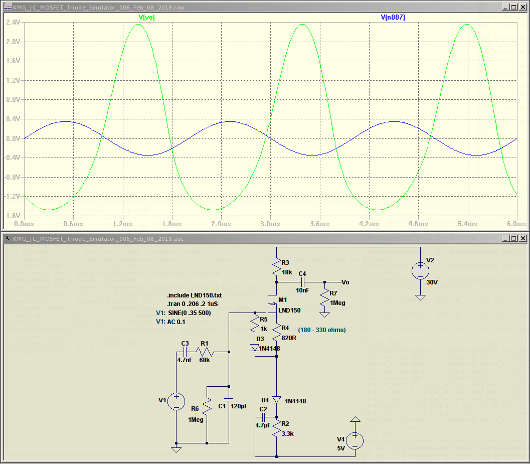

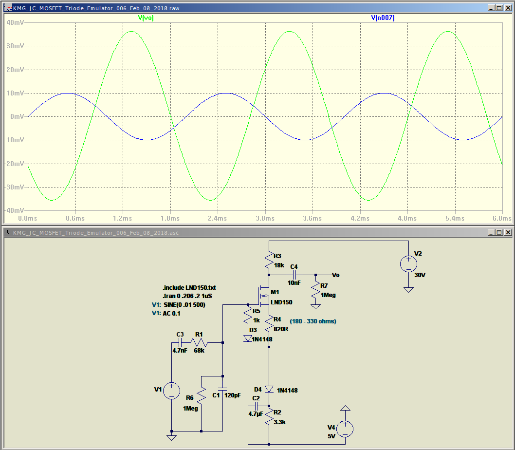

It would be interesting to see if they translate to low voltage in a convincing manner.
LTSpice seems to agree with my reasoning in my last post. See attached screenshots. (Note these are just LTSpice simulations right now - not built and tested and verified to work.)
I've changed the positive supply rail to only 30V. The drain resistor has been changed so the drain sits at about 15V DC quiescent. I used a 5V negative supply because 5V USB chargers are everywhere now and will work perfectly to provide the -5V supply rail.
Id is a bit under 1 mA.
KMG's stuff at the FET source has been slightly simplified - no Schottky diodes, just 1N4148s.
Small-signal gain is only about 3.5 times (11 dB). As predicted earlier, this will be the major compromise with drastically lowered supply voltage. But the low gain is necessary to maintain headroom at the lower B+, anyway.
The output waveform is shown for three input levels: 10 mV peak, 350 mV peak, 700 mV peak. It seems to look about right, but I don't know how it will sound until I listen to it.
The circuit will accept 1.5 V peak input without clipping (3 volts peak-to-peak.)
In the simulation, hard (and probably unpleasant-sounding) clipping occurs at 4V peak to peak input.
This seems plenty to cope with maximum guitar output under realistic conditions. (I'm still shocked at Michael Koster's 10V peaks, but I think most of us won't get past ten percent of that.)
There should probably be a clean gain stage ahead of the circuit shown here for use with an actual guitar. The circuit works as shown when fed from a low-impedance signal source, so a buffer will be required with an actual guitar, and I suspect some gain would be a good idea, too, if useful distortion is wanted without having to whale on the guitar strings with a sledge-hammer.
I should probably mention that clean transparent gain and buffering is trivially simple with today's solid-state components. We can probably get what we want out of a single JFET stage ahead of the KMG stage shown in this post (tweaking the 68k in the attached schematics to allow for the output resistance of the JFET.)
In fact, transparent-clean gain stages can be sprinkled through as necessary. KMG-stages to generate "tubeyness", clean solid-state stages to bring up the gain if necessary, without changing the sound otherwise.
-Gnobuddy

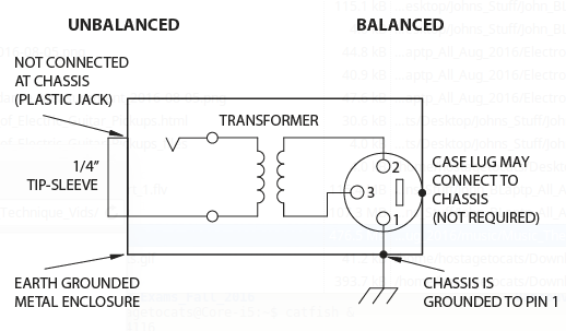

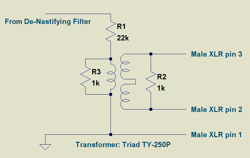

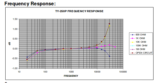

Balanced line out - tips?
The guitar amp I've built for my friend is, like all engineering designs, a set of compromises. In order to keep it light (for my friend) and affordable (for me), I used boom-box speakers, which will limit the maximum SPL available.
I think it'll be loud enough for my friend 99% of the time, but for that last 1%, I'm thinking of adding a balanced XLR output. If he ever wants more loudness than the amp can provide on its own, he can use that to plug into the P.A.
Since the de-nastifying filter already has appropriate EQ / speaker emulation in it, this should be a pretty simple matter, i.e. I just need to tap off the signal at the output of the de-nastifying filter, and send that to the XLR jack.
However, this is one of those things I've never actually designed or built before. I want to avoid ground-loop issues, and make sure the signal level is in the right ballpark to plug into a microphone input of a mixer.
Anyone have any tips on how to do it? Should I use a signal transformer? If so, what kind? What sort of circuitry does it take to drive said signal transformer (i.e. expected primary impedance and signal level?)
I'm attaching a screenshot taken from a Rane document on "sound system interconnection" ( Sound System Interconnection ). Does this look like the way to go?
Thanks in advance,
-Gnobuddy

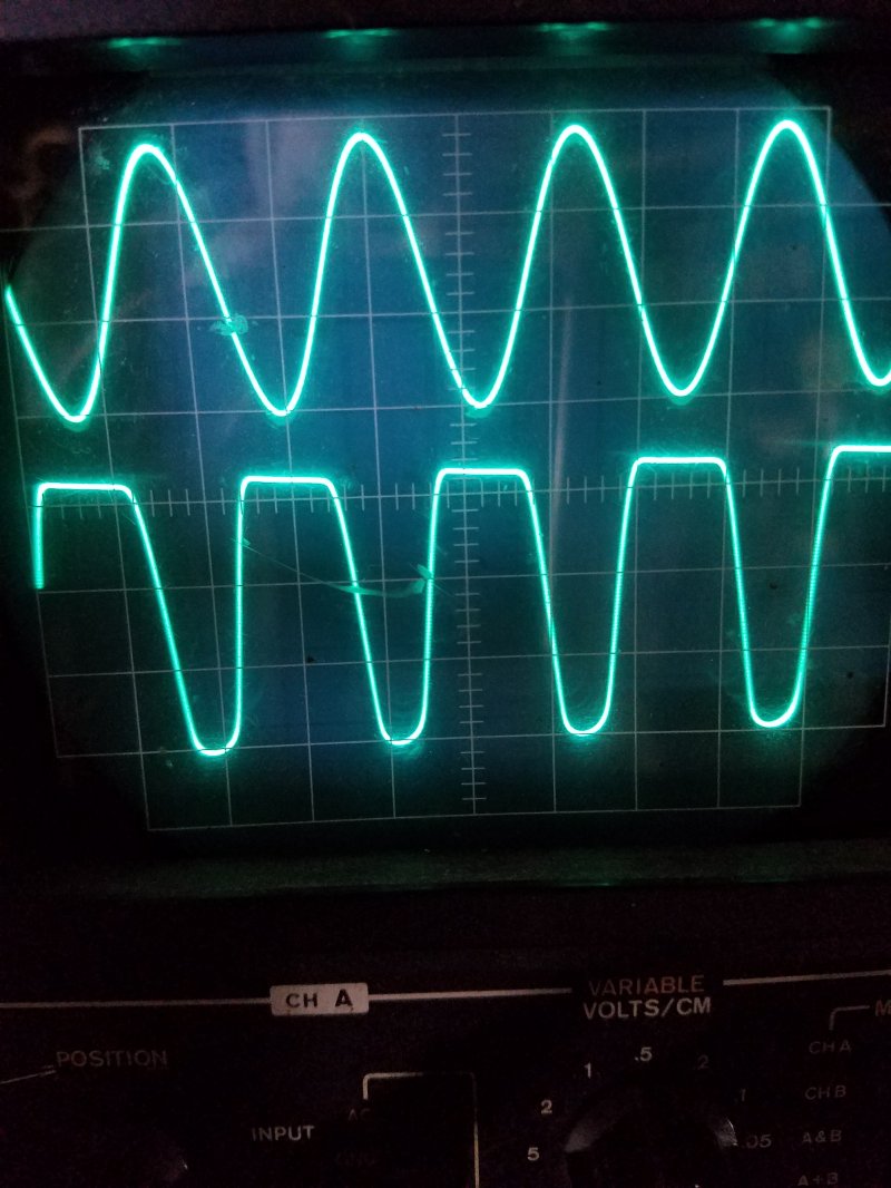

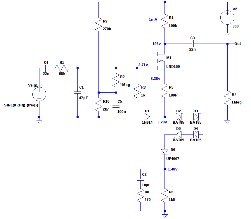

I've made an initial prototype of KMG LND150 gain stage, with fixed bias and Leo Fender cathode resistor (1k5). Actual components, not simulation.
For reference:
http://milas.spb.ru/~kmg/files/projects/jcm800mv/fet/lnd150/jcm800mvfSch.pdf
and see attached schematic for my changes.
Power Supply: I discovered an extra 1:1 isolation transformer in one of my parts boxes, so I made a half-wave voltage doubler. For now, I use a variac so I can adjust the output to 300VDC under load
Parts substitutions: For the parallel BAV70 pair, I use a single 1N914, for the BAT54S schottkys I use through hole BAT85S, For the ES1J high voltage fast recovery diode, I use UF4007.
Fixed Bias: Instead of referencing the LND150 gate to ground, it goes to a 270k/2k7 voltage divider. The LND150 source circuit is referenced to ground instead of a negative supply. This setup requires capacitor coupling the input signal, so I use 22n.
DC operating point:
  • Drain: 196V This is close to a Leo Fender stage where the plate sits at roughly 2/3 of B+. So we're getting about 1mA current through the 100k Drain resistor.
  • Gate: 2.71V
  • Source: 3.38V
    This gives a Vgs of -0.67V. This is reasonably close to what you would get drawing a load line with the LND150 "output characterists" curves.
  • Top of Source diode chain: 3.20v
  • 1k5 resistor: 1.48v
    So the diode chain drops 1.72v @ 1mA. This seems reasonable for 4 schottkys and one regular silicon diode.
AC characteristics:
I fed a 400hz sine wave at various voltage levels, and monitored output with a scope. I measured gain with a 100mV peak-to-peak input signal, so there would be no clipping.
  • With the 1k5 source resistor unbypassed, the gain was about 32.
  • Fully bypassed, the gain was about 80.
  • Bypassed with a 470R resistor in series with the bypass cap, gain of 58.
Note: my scope doesn't have fancy digital readouts, so gain measurements are by eyeball, so consider them "ballpark" figures. I do all AC measurements by peak-to-peak values on my scope, it's easier that way.
So here, LTspice is a little optimistic with gain, versus a real circuit.
LTspice said a 910R bypass resistor for a gain of 60. Reality said a 470R resistor for a gain of 58.
So this resistor is "adjust on test".
Next, I gradually increased the input signal to overdrive the gain stage. From what I could tell, with my less than stellar scope, here's what happens:
  • As the input signal increases from 100mV, the output looks like a sine wave and gets bigger, as expected.
  • At around 1Vpp input, the bottom of the output waveform starts looking less sine wave like, a little "peakier". It's still rounded, and it will stay rounded even under massive overdrive. This appears to be the threshold of "grid current".
  • Around this time, the top of the output waveform increases a little less than the bottom.
  • At around 3Vpp input, the top of the waveform increases no further. It is technically clipping at this point, but the leading and trailing edges are still very rounded. Bottom of waveform still rounded, and now increases slower.
  • At 4Vpp input, obvious clipping on the top, bottom is still rounded. The duty cycle is changing.
  • At 6Vpp input, the duty cycle changes even more, the top clipping is more pronounced, but still with slighly rounded leading and trailing edges. See attached photo. Pardon the crappy photo, but you get the idea.
  • At 12Vpp input, the trend continues, more (or less?) duty cycle, bottom still rounded.
For giggles, I put a 220R in place of the 180R hanging off the Source. It changed the DC voltages slightly, but didn't seem to make a difference in the AC characteristics. Again, my scope is not the most accurate thing in this world.
I'm sure the "grid current" threshold does change slightly, but not radically.
I couldn't tell the difference. The output waveforms behaved the same as with the 180R.
KMG uses 180R, 200R and 270R in his preamp. I'd say 220R is ok too.
I have not yet applied an actual guitar signal to this and listened to it. I don't expect just one stage will have any "magic", it needs a complete preamp. Just this one stage used up most of my little breadboard, it's a fragile mess, so I need to build on perfboard next.
Overall, the experiment worked out, at least from a DC operating point and sine wave perspective. No smoke, no surprises. Pretty darn close to what a 12AX7 would do in similar circumstances.
The question remains whether the 270k/2k7 voltage divider can be used for multiple gain stages, or if it needs a separate divider for each gain stage. Probably needs a separate one for each. We are after all simulating "grid current" here and the current has to come from somewhere. So connecting multiple gain stages to a single divider might be a recipe for oscillation, or not? It could do something really cool or not make any difference?
I wonder if a single 1N914 could replace a pair of BAT85S?
It seems wasteful to put four Schottky diodes in series if there is some other kind of diode that produces about the same voltage drop and dynamic resistance (they all seem to follow the same exponential curve at these low currents, so they really should have the same dynamic resistance if they have the same voltage drop at the same current.)
Maybe one LED, and one UF4007 in series for high-voltage protection?
Sounds good! You just reminded me that I totally forgot to buy any fast, high-voltage diodes when I bought Schottky diodes to try KMG's ideas out. Drat!
I found the LTSpice model for the MPF102 JFET to be way off from reality. It seems you're finding the same thing for the LND150 model.
Supertex provides an LND150 model, but the one I posted in this thread was tweaked by someone who found the factory model was a very poor fit to the published LND150 datasheet curves. But it seems it doesn't match your actual LND150 devices very well, either.
I wish I knew how to tweak LTSpice models to better match reality. It can't be that hard, but I haven't stumbled across any documentation on how those diode and FET models are created. Staring at the text inside existing LTSpice models hasn't been enough for me to figure out how they work.
Now that's a little annoying! There are a lot of components per stage, aren't there?
And once again I'm wondering if four Schottky in series can't be replaced by some smaller number of components.
My guess is that you can run at least a few stages off the same divider, especially if you increase the 100nF filter cap to maybe 10 uF or 100 uF instead. (Make it big enough, and you can simulate the heater warm-up time and slow turn-on of real valves!)
I wonder if replacing the 2.7k with an appropriate LED might also be worth a try? The lower dynamic resistance of an LED (compared to a 2.7k resistor) might help with running more stages off the same voltage node.
True, but you have a 1 meg resistor between the FET gate and the 3V DC node, so you can't draw more than a few microamps of current from your 3V DC source.

The trouble is that the FET circuits I've tried have all been too linear, so they sound too clean (tending towards lifeless and sterile, like so many solid-state guitar amps.)
It seems we have to do something to make them less linear, in a good way, if we want to come close to what valves do naturally.
I estimated 35% second harmonic distortion for the good-sounding "clean tones" from my DIY valve preamp with a 6AG5 final preamp stage ('scope screen capture was posted earlier.) I have been having trouble squeezing anywhere near 35% out of a JFET.
I tried that. Replaced 4 schottkys with 2 1N914.
When overdriven, the leading and trailing edges on the top of the waveform are sharper, still not completely squared off, but not as soft as with the schottkys.
However for moderate signal levels, say 100mVPP to 1VPP, it's hard to tell the difference. The schottkys (all 4 of them) seem to be critical for simulating the 12AX7 characteristic curves that get closer together near cutoff.
This isn't the first time I have found spice models to be off
My guess is that you can run at least a few stages off the same divider...
Well I didn't have any LED's that would work out for the required voltage. I have some red ones at 1.6v and some green at 1.8v.
What does work is 4 x 1N914, gives around 2.8 volts, which remains fairly constant with fluctuations in B+ (I turn the variac up and down).
For my version of the circuit (different diodes than KMG and fixed bias), it looks like the sweet spot for the bias supply is around 2.75 volts give or take a tenth.
There are through hole 2.7v zeners, but I don't have any, but I do have a bag of 1N914 so will probably go with those for now.
I think the clean tones I liked from KMGs FET Bogner Ecstasy were actually from his 2SK216 MOSFET amp, rather than his later LND150 one. The circuit was a bit different too ( http://milas.spb.ru/~kmg/files/projects/xtcfet/XtcFet.pdf ), with one source diode and apparently no grid-current emulation.
So I'm very curious if his later LND150 circuitry provides equally good (or better) clean tones.
You and me both. I've still got a lot of work to do with this, but the important first steps have been taken.
It just occurred to me that an LND150 with a 100k anode resistor will probably have an output impedance of essentially 100 kilo ohms. But half a 12AX7 with a 100k anode resistor will have an output impedance of around 40 kilo ohms, two and a half times lower.
This is because the (internal) anode resistance of the triode is somewhere in the ballpark of 70 kilo ohms, much lower than the internal drain resistance of a modern MOSFET.
In other words, we can expect considerably more severe loading effects on one of KMG's triode-emulation stages, compared to the real thing.
-Gnobuddy
I added a line-out jack (actually a mic-level XLR male connector) to the amp, so my friend can plug it into the P.A. if he ever wants more volume than the pair of 6 1/2" speakers can put out.
This was pretty easy to do because the de-nastifying filter already removes all the nasty-sounding frequencies before they go to the internal class-D power amp module. So all I had to do was tap off the signal from the de-nastifying filter, pad it down to the right level, and add transformer isolation to prevent ground loop problems when plugging into the P.A.
It turns out Triad makes an isolation transformer with a full 20 Hz - 20 kHz bandwidth, and it works at impedance levels that are comfortable for both the de-nastifying filter and a typical microphone input on a mixer. It's affordable too, not like the platinum-and-diamonds Jensen mic transformers. (TY-250P Triad Magnetics | Mouser Canada )
As you can see in the schematic, I wired a 1k resistor across the transformer primary, and another across the secondary. A glance at the attached transformer frequency response plot will make it obvious why I added the 1k resistors!
We tested the line-out at last night's jam, and it works very well. My wife commented that she had never heard our friend's playing as clearly as she did last night.

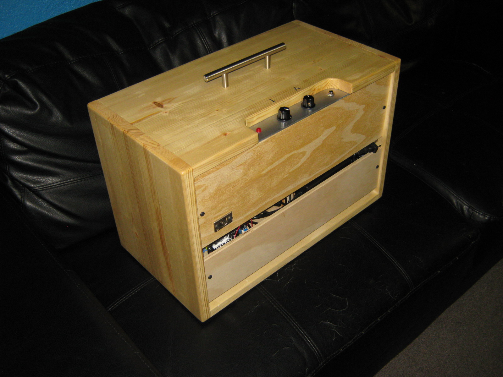

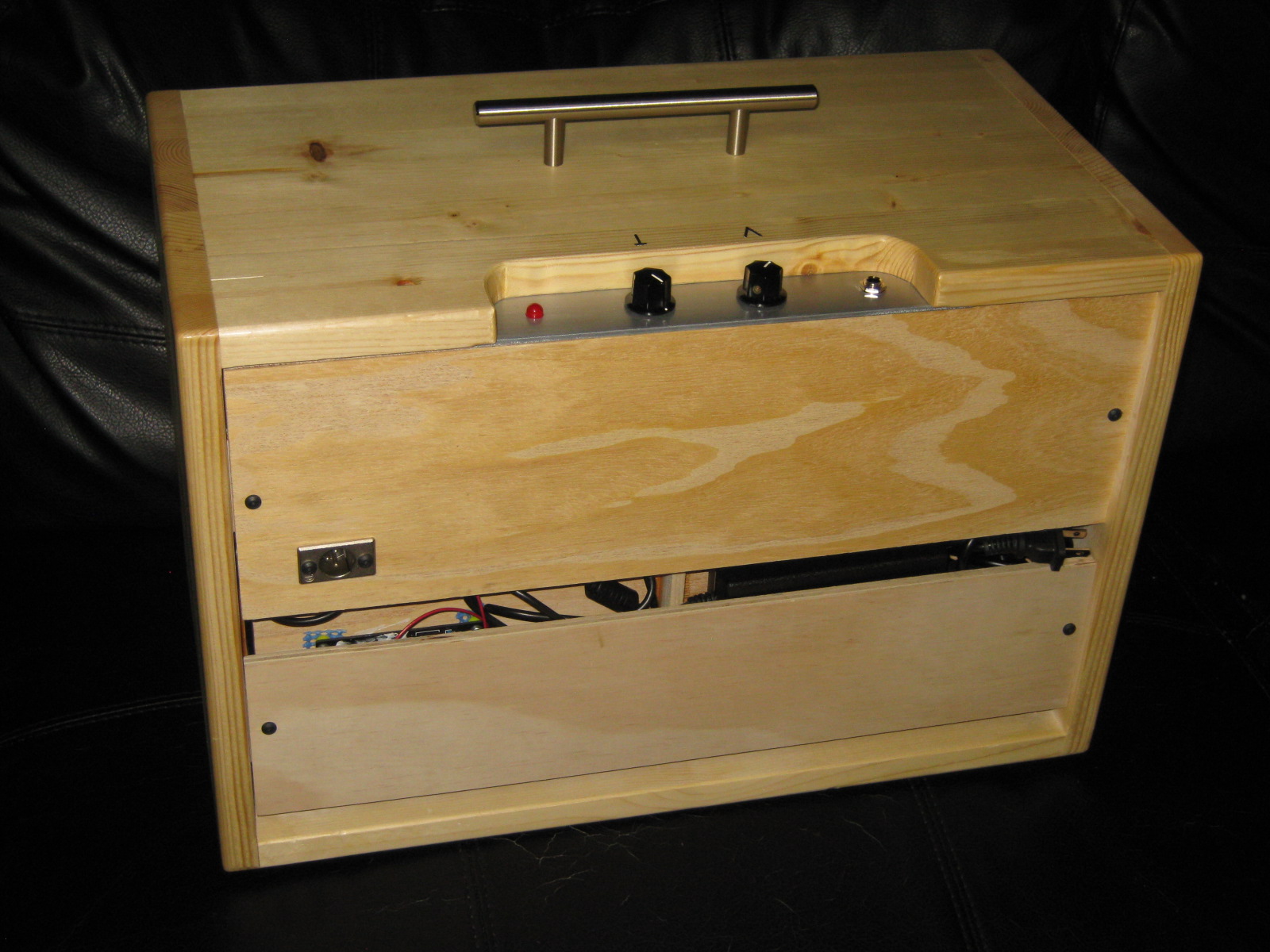

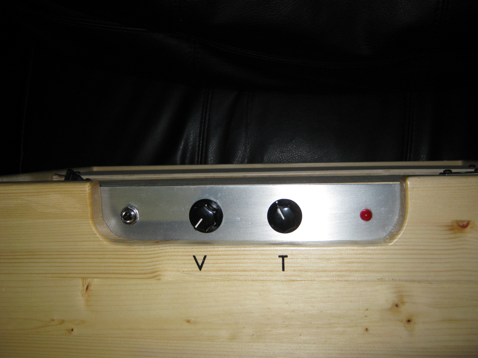

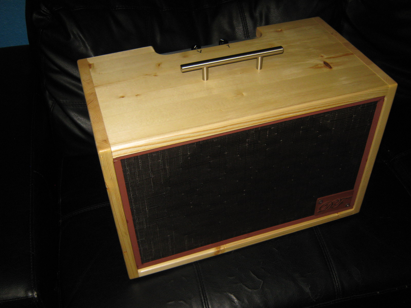

Here are some pictures to wrap up the project (building a guitar amp for a senior-citizen friend, on a tight budget.)
The logo plate (complete with the raised letters, which are my friend's initials) was 3D-printed out of white PLA (Polylactic Acid, a biodegradable thermoplastic.)
Then I spray-canned the logo plate a shade of brown that was chosen to go well with the grille-cloth, and used an oil-based gold paint marker to colour the raised letters.
The male XLR connector on the back of the enclosure is the mic-level output, which can go straight into a mixer or P.A. system.
I've tested this, and it works well, sounds good, and is hum-free. I really like the way this feature turned out, and I think I might want to include it on my own guitar amp builds in future.
The gap between the two rear panels allows one to stuff the power cord neatly away for storage and transportation of the amp.
I might do some fine-tuning of voicing or gain in the future, based on any feedback I get from the mysterious owner (DF). But I consider the project done at this point.
