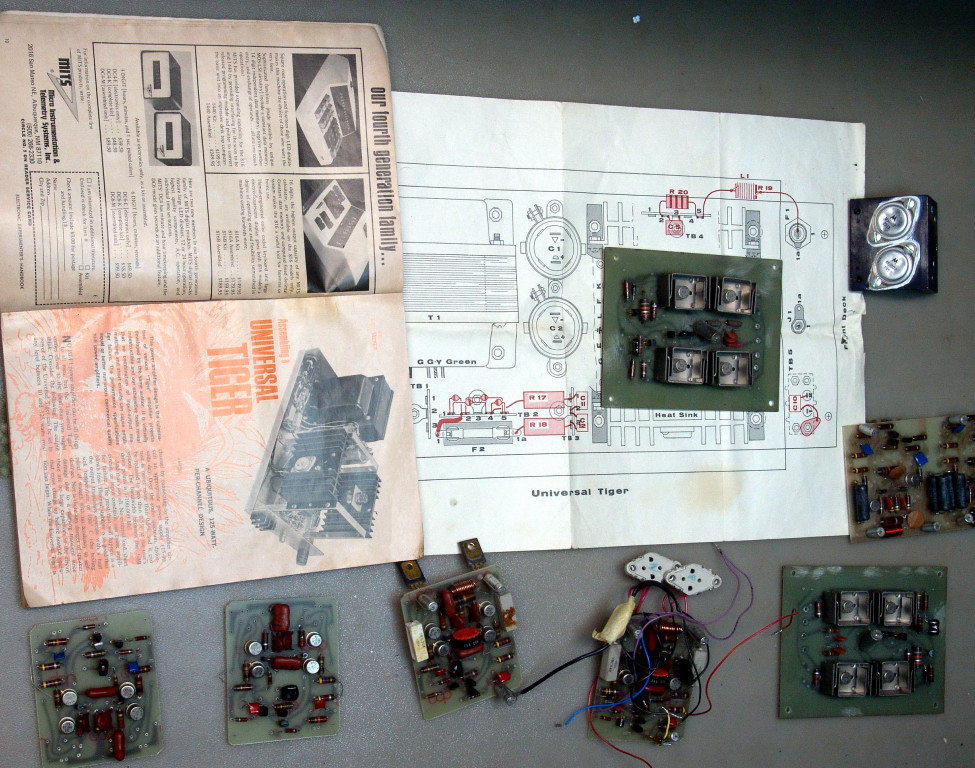

I took this picture of what I had left before giving away or trashing about 2/3rds of my lifetime collection of stuff before moving 1200 miles. The little boards in various stages of completion are our modified version of the Plastic Tiger. More reliable, but still about 35 watts out. The larger boards are Universal Tigers, and the one oddball was a dual Plastic Tiger with some of the parts missing. We made those for stereo HiFi amps. Bridging them for higher power guitar amps led to smoking parts.
My guitar preamp was likely a clone of the Kustom 100 Watt head, or an Acoustic "120" or some combination of the two. I had traced both amps. I remember the numbers 2N3391 and 2N3393, but they were pretty common back then. The power amp section for both amps was taken directly from an RCA Transistor Manual, as was the Heathkit guitar amp. I got parts from the local Heathkit store.

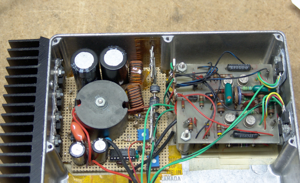

I have another picture of a car audio power amp I made with the same boards.

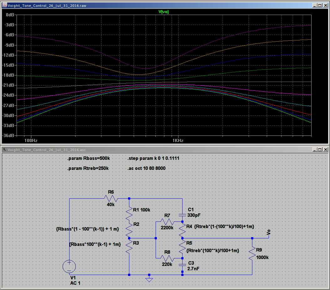

Merlin Blencowe's valve preamp book ( The Valve Wizard ) includes a short mention of the Voight tone control, originally designed before WWII to "lift bass" on early records, operating down below 50 Hz. It's a two-knob passive circuit that uses very few components, and is much better behaved than Leo's three-knob creation.
I took the schematic in Blencowe's book, and tweaked it extensively (some might say obsessively) in LTSpice, until I got a set of frequency responses that I thought would be well suited to guitar.
The two attached screen captures give you an idea; note that control response is fairly uniform over most of the range (though somewhat closer spaced near maximum cut settings), and there isn't much interaction between the two knobs.
The second image shows the result of stepping one knob, then stepping the second knob through its entire range, and repeating the process. The fact that the lines cluster into fairly distinct groups tells us that the controls are pretty independent - the treble control doesn't drag the bass response around with it, and vice versa.
I'm also attaching the .asc simulation files, if anyone wants to try running their own simulations with this circuit.
R6 (40k) is not part of the tone control, but represents the output resistance of the preceding 12AX7 gain stage - this is roughly what you get using the usual 100k anode resistor, combined with the internal anode resistance of the triode, which I took to be approximately 70k. So the frequency response curves you see are what you actually get in real life, with the tone control fed from half a 12AX7.
R2/R3 is a 500k (or 470k) logarithmic potentiometer, and is the bass control. R4/R5 is a 250k (or 220k) log pot, and controls treble. I derived the weird equations you see next to those four resistors myself - they describe the behaviour of the standard "10%" log audio pot. The variable "k" tells you how far the pot has been rotated; k=0 is full anti-clockwise, k=1 is full clockwise.
I derived those equations myself because I found at least one problematic LTSpice linear potentiometer model online, which produced the right voltage, but not the right source impedance; the wiper of a pot is not a pure voltage source, but has a Thevenin impedance that varies with the setting of the pot. This was missing in that model.
Having seen encouraging results from the simulations, I built this circuit a couple of years ago (take note, Benb!), and included it into a preamp I designed and built around a pair of 6JW8 triode-pentode valves.
I liked the result a lot - it doesn't produce Fendery sounds, since it doesn't have the deep notch in the mid frequencies, but I enjoyed its set-and-forget nature. In use, there is no perceptible interaction between the bass and treble controls, which is a Good Thing (TM).
It is, of course, quite possible to create a separate mid control elsewhere in the preamp. I didn't feel the need to do that myself; the small-signal "pentode" (really a beam tetrode) in the 6JW8 provided a bit of brightness and shimmer on its own, without needing a big mid scoop.
As usual, some say it's the cat's meow and others say don't bother.
And I'm sure the same would be true of this tweaked Voight circuit, if anybody else were using it. I think it meows just fine (and I have two constantly miaowing cats, so I know a miaow when I hear one!) But others may or may not share the sentiment.
