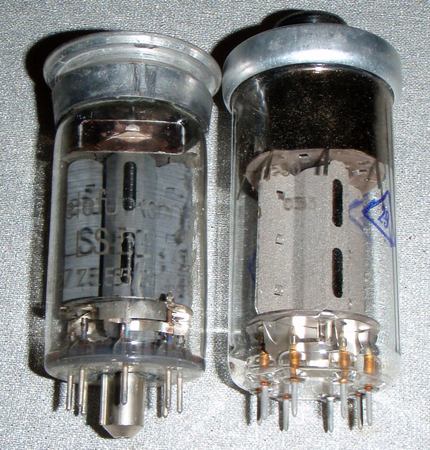

Originally the tube was designed by Telefunken Deutschland, manufactured for German military and government during WW-II under the name LS 50.
After the war it's envelope was redesigned. It was manufactured by Soviet plants for Soviet military and government under the name ГУ-50. At the same time Eastern German RFT plant manufactured a version without an aluminium cap, under the name P-50.
Swiss BBC manufactured own version of LS-50, called P50-1. Despite of name similar to RFT version it had Telefunken type envelope. P50 and ГУ-50 had identical envelopes.
Slightly modified version, compatible with LS-50, was called by Swiss BBC P50-2.
Eastern German tubes P50/1 and P50/2 were different! They shared the same envelope with Soviet one. P50/2 was redesigned P50 to serve as a sweep pentode in TV sets.
Later Germans made EL152: 6.3V filament version in a different envelope.
ГУ-50 tubes we buy today were released from military warehouses. That means temperature changes, humidity changes, many times, during long period of time. Imagine Siberia where temperature may change from -40C in winter to +40 in hot summer! No metal can have the same temperature coefficient as a glass, so microscopic gaps between legs and glass exist. That's why they need to be baked before first usage, otherwise molecules of gases would eat cathode coating instead of getter flash.

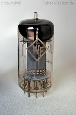

That's why I was asking about Chinese Fu50: do they use identical materials, or geometry only? ГУ-50 can dissipate 100+ Watt shortly, without any damage. If Chinese tubes are the same, it is a good sign! That means, I may expect to see a tube of my dream, like on the picture:

What is the tube you show - that's too tall for a GU50! Looks like it should be a GU75.. it's photoshop isn't it? ;)
