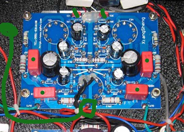

Hello,
Please excuse my English but I'm Portuguese and I have to use the google translator.
I am a new user of the forum and ordered a sweet peach.
I have little knowledge of electronics but I would like to change the capacitors.
I have no problem in doing the welding, but I do not know exactly what capacitors to buy, maybe the ERSE?
I also do not know if these capacitors have polarity and if this is marked on the board.
If someone can post a picture of the board with the capacitors signed and the polarities marked that would be a huge help.
Thanks,
Alexandre
We call it soldering, not welding!
Which part of Portugal are you in? I bought some good caps in Porto - there's a very good shop there I found.
The caps just need to be rated > 400V, ideally >600V.
I use 1kV polypropylene as I had them - mine were cheap too. The ERSE caps seem fine to me.
No polarity.

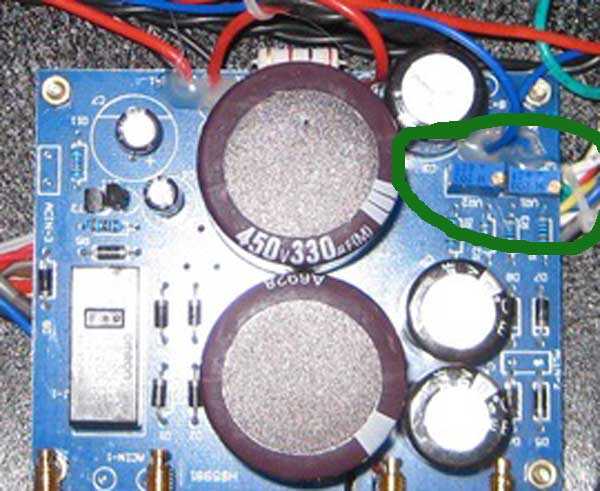

Can you help me with instructions on how to adjust the bias this amplifier?
Ah - feel free to PM me with details about how to emigrate to Switzerland ;)
Just buy a 1 or 2Watt resistor - it should be fine. Make it so that you can discharge the caps without touching anything metal like the leads, and measure with a meter afterwards.
The bias should be about 55mA (although I suspect 50mA would be fine). There is a 10 ohm resistor on the FU50 boards - see picture - measure for 0.55V (or 0.5V for 50mA) across the resistor - where the red blobs are.
BTW that red lead on the left side is the full anode voltage from the transformer and will have about 430V sitting it it, connected to a large capacitor - please stay clear of that, you'll live longer :)

To make the discharge of capacitors I was thinking that I could connect an insulated wire with the resistor from the ground on the box to the red wire, is it ok?:confused:
Bias adjustment is done in those two variable resistors of the second photo?
I'm planning to replace the two small capacitors with wire, replace the fake 0.1u WIMAs and exchange the valves for equivalent of Soviet origin.:cool:

I am done with caps!
So my feeling that this caps are much better then stock Wimas...
I did comparison for one channel first using a good Sennheiser's headphones and I found that it is easy to see the difference. The new caps can give you more air and more details. Vocal is perfect now, it was not bad but now it is GOOD! :)

Sorry missed the other questions:
Thank you for your help.:D
Yes, try to make the ground lead the long one, so you are only holding the ground lead when you use it!
Yes.
But changing one affects the other!!
So firstly balance the two tube biases together by measuring from tube tab to tube tab (the right hand -> red dot on my picture). I.e from that point measure for 0.00V between the cathode of FU50 tube 1 and the cathode of FU50 tube 2.
Then measure between the red dots as in my picture, (little clips are useful for this) and turn both knobs the same amount to set the bias - 0.55V for 55mA.
One day I'll change my 10ohm resistor for a 1ohm - it doesn't need to be so big!
